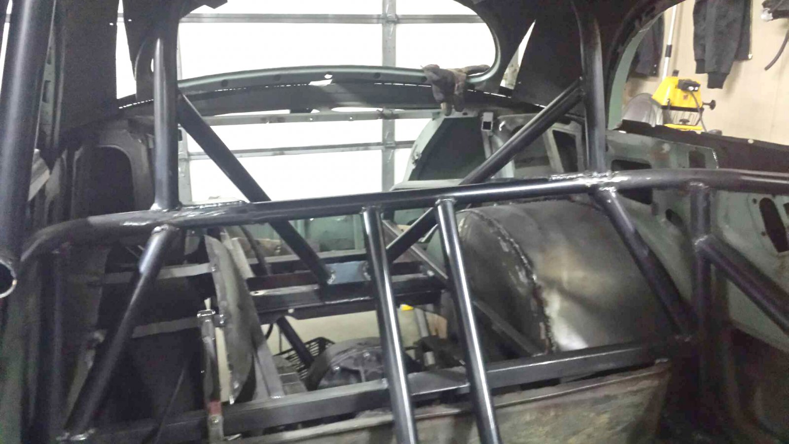

    The roll cage has been a trip. It started as a very simple plan for a basic hoop with a couple of runners down to the rear frame area. Then it expanded a bit to a six point cage with a planned hoop up front around the "A" pillar posts and across. We bent it all up and tacked it in place. It looked amazing. In fact, it looked and fit so well that I put the hard weld to it and we moved on to other issues.
    However, and I hate to admit it, the cage sat all winter untried until we were getting ready to start sheet metal work on the interior a couple of months ago. At that point, I put the racing seats in place to wrap up the racing belts mounting points etc. I sat in the car and found the "leg" on the main hoop (at my left shoulder) made it nearly impossible (at least comfortably) to set in the seat and do simple things like steer!
    So out came the plasma cutter and grinder and out came the cage. With some very careful planning not to mention trying the race seats about every 3 minutes, this is how it ended up.
    Counting the runners that complete in the engine compartment it is officially a 14 point cage. It is hard to tell from the photos, but most of the cage is tucked into the "A" and "B" Pillar post areas, over the door area and then right at the roof. Even with that many bars running around, you basically have to stick your head in the car to see 80 percent of it.

  16. rooman
    Joined: Sep 20, 2006
    Posts: 4,045
    rooman
    Before Bruce sees this and gets on your case again I have to ask why the side bar rolls down where it intersects the first of the two main hoops and, apart from the two overhead tubes, what connects the second main hoop to the first? Rather than the two longitudinal bars, a diagonal in the top would have been better and more in line with what is required for certification in the faster cl***es even it it is not required at your performance level. A tighter radius bend would also have helped keep the main hoops further away from the driver's head although it is a little hard to see from the photographs how much roof clearance is available to do that.
    Roo

    There are several pieces of the cage that are still not installed. They are cut and fitted but because I need to do crucial structural interior work on the rear window areas they are not in place. They connect the middle and rear hoops around the side areas but just above the window line. I am trying to build as safe a cage as possible but if I am really honest, it is as much about aesthetics as anything else.

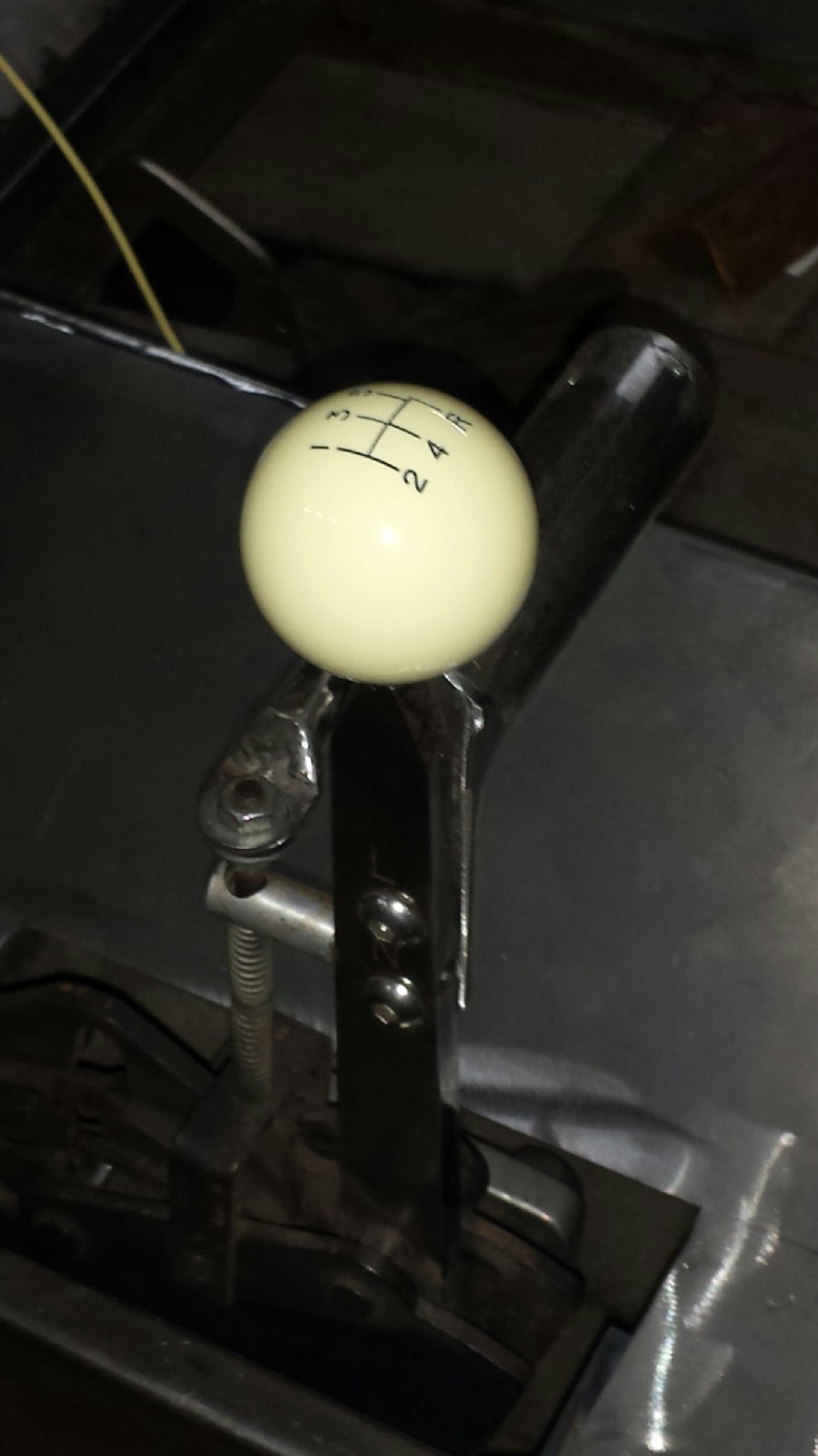

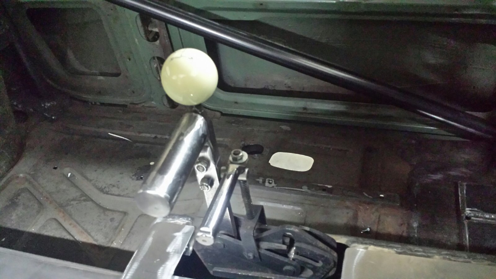

    So while sitting in the driver's seat this Winter and making car noises something became very apparent to me. The straight gate 5 speed Hurst shifter was going to be a real pain in city driving. It was obviously going to be killer running through the gears, but coming back up, that is another question. You have to stick two fingers in that loop device and pull up and the lift the shifter back in place all the way up the tree!
    While watching me play, Dad came up with a great idea:
    We built a nice handle out of roll bar tubing, filled the end and put a bracket on the other side to mount to the shifter lever. Then we took a busted 1/4 drive ratchet handle and fabricated a lift bar for the upshift device. It works like a charm. Now you just reach and squeeze...it is a killer addition! Believe it or not, I got that vintage looking (albeit 5 speed) ball from Amazon.com!

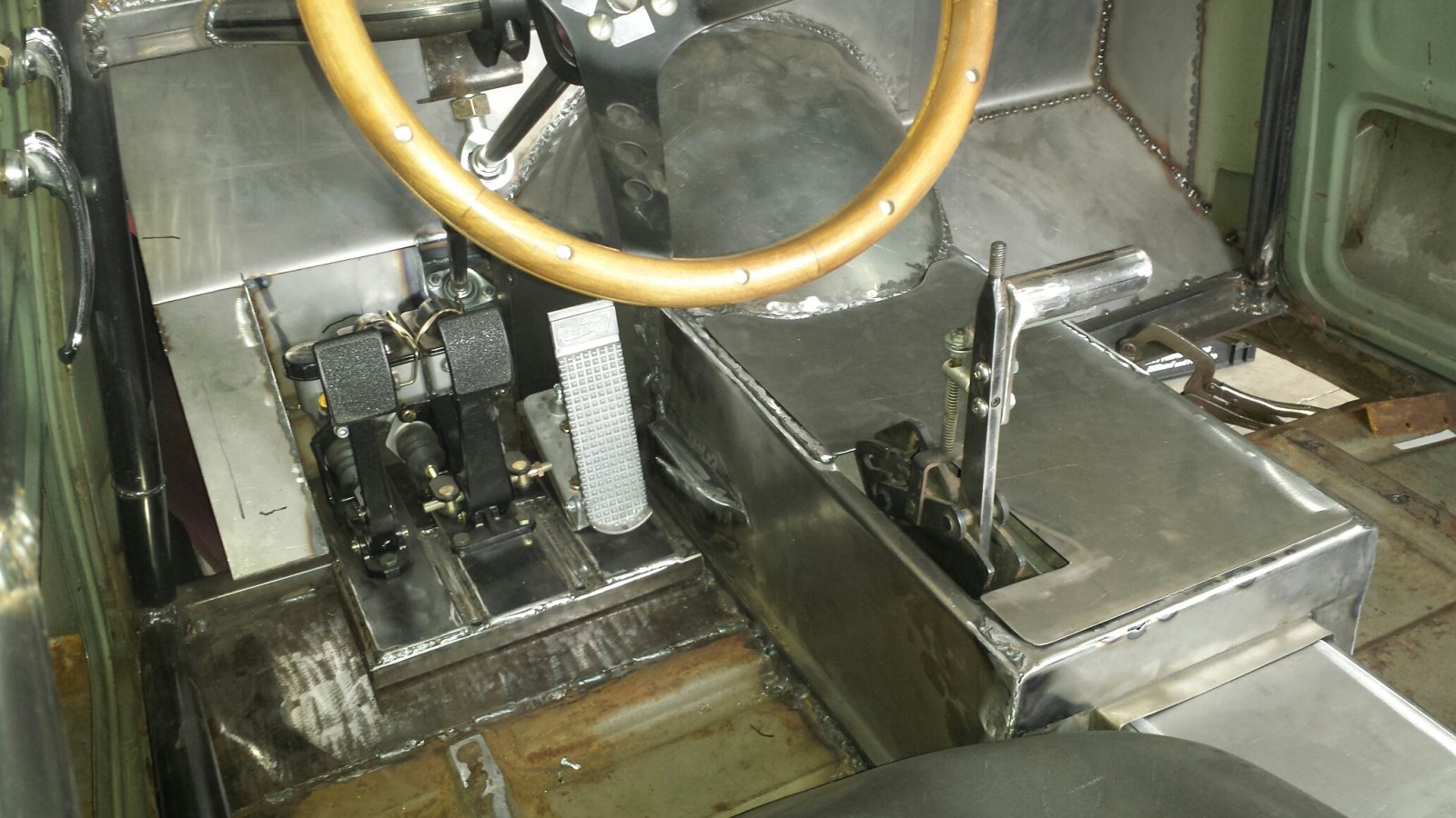

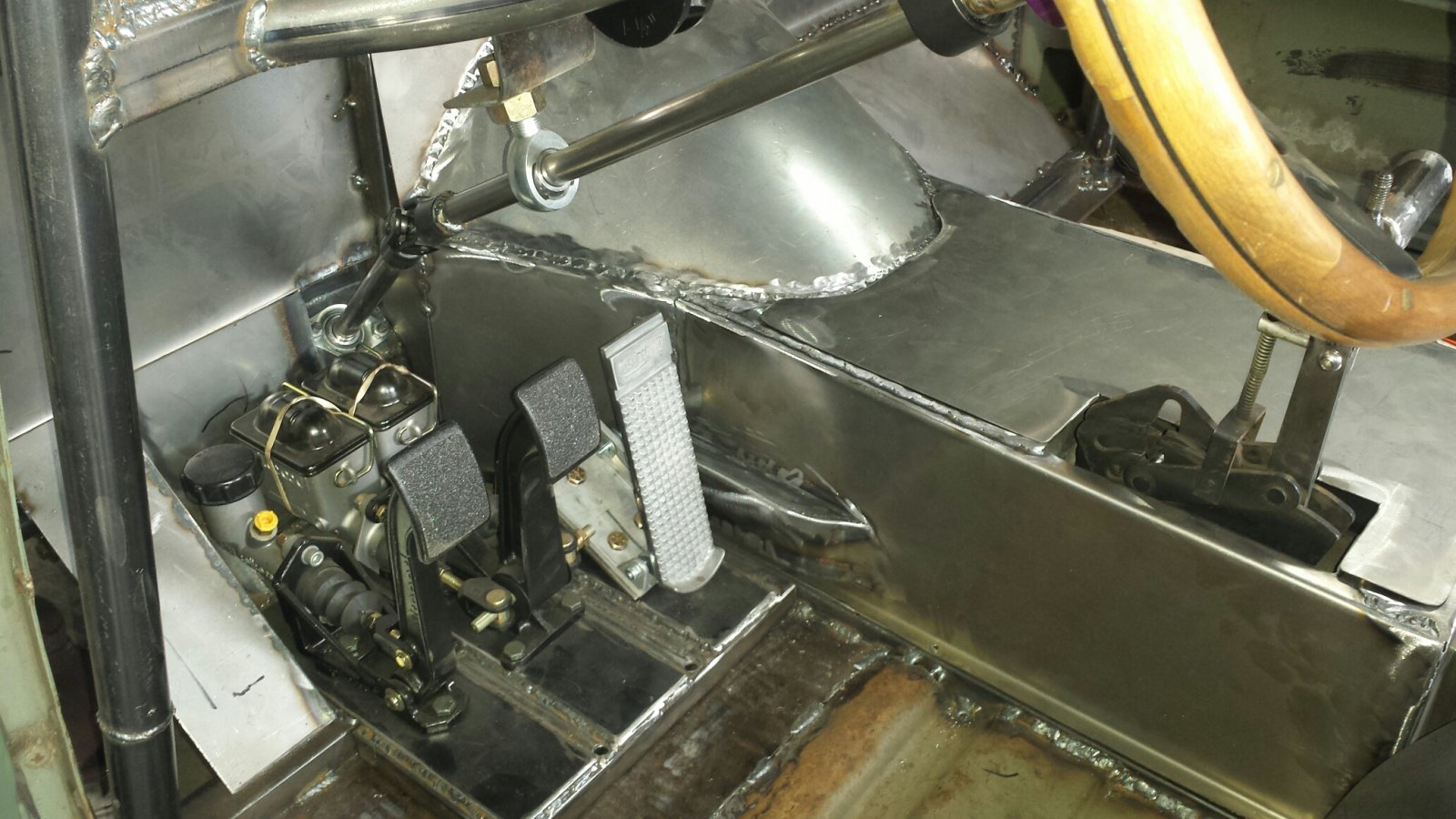

    Also over the winter we knocked out the pedals and steering column. I have said it before but this project is like setting up dominoes. In a car where room is at a minimum, there are so many things that have to happen in order it is ridiculous. We couldn't set up the pedals and steering until several issues were settled including: Where the headers ended up, how the lower firewall was placed, where the seat ended up (both left to right and front to back)...etc. etc. etc.! The loud pedal came from Speedway. The brake pedal and master cylinders and Clutch Pedal and cylinder came from JEGS! I put the exclamation mark there because when you say JEGS you are supposed to say JEGS! Right?
    It is a little hard to tell from the photo, but that entire unit is bolted in (Clutch, Brake and Loud Pedal). The front portion literally drops down into the area to the floor pan. It has been very handy to simply grab the entire unit and move it out or in etc. After everything was in place and we were happy, there was plenty of room to keep all the reservoirs inside the car and complete the lower firewall.

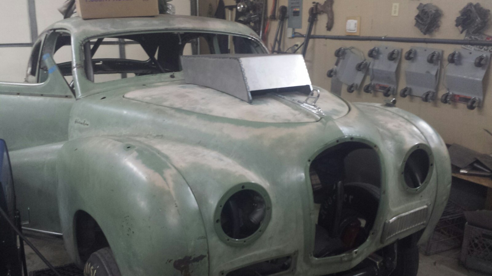

    Still playing around BUT SPOILER ALERT! - Last week we sort of switched cl***es from A-Gas to AA-Gas! That's right, there is new Weiand 6-71 on its way!!!

    The Steering column pieces also came from JEGS! including the steering wheel.
    1 - solid .75" steel steering rod
    2 - weld on universal joints
    1 - one standard Heims end
    1 - firewall .75" column bearing mount
    1 - .75" weld on vega steering box shaft end
    1 - very cool steer column mount arm
    1 - quick release steering wheel mount and weld on end.
    1 - wooden steering wheel with blacked out center
    Grand total just under $250.00
    Here is a great tip that I got here on the HAMB...after spending a couple of hundred bucks on column pieces drop by Lowes and spend $6 more. I picked up a 3/4" dowel rod and put the whole column together with it first. Then after all the cutting and changing and angle finding I simply took the wooden rod pieces out, cut the steel to match each and welded it all together.

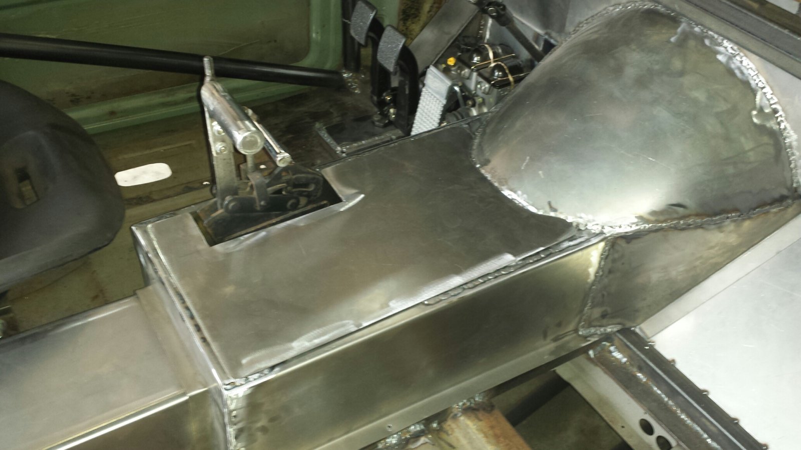

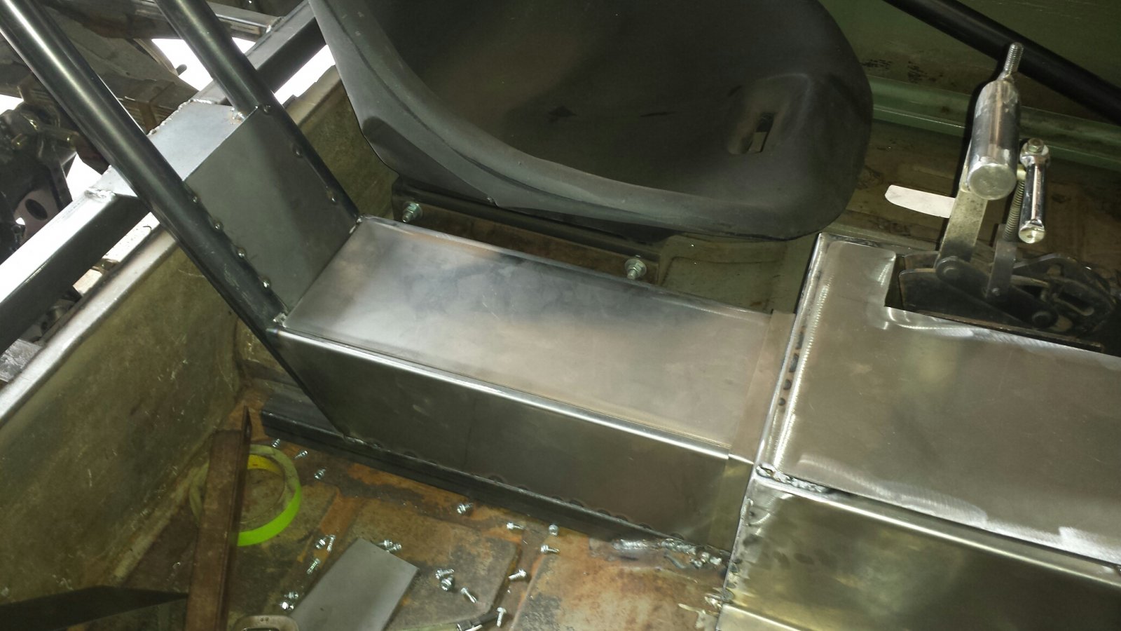

    We also worked pretty hard on the sheet metal transmission tunnel. I really hate sheet metal work! It took several attempts to get a design in place that looked cool and was functional etc. That might be an understatement! In reality, the sheet metal s**** pile outside the shop from this endeavor looks like a Cessna crash site! LOL!

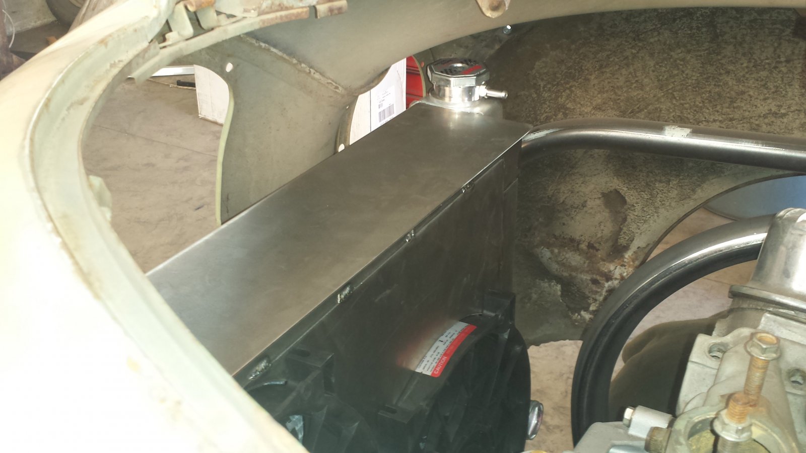

    We installed the radiator this winter as well. It is a high performance aluminum radiator also from JEGS with Derale High-Output Dual Fans worth more than 4,000 CFM. The fans are pullers and came in their own shroud. I have had them in boxes just waiting around for almost a year. We unpacked them and discovered the fans in their supplied shroud were about 1" too wide for the radiator. So we built our own sheet metal version.
    While we were at it, we killed two birds with one stone, designing a custom mounting system into the sides of the shroud with heavy 1" square tubing.
    I did not snap a photo before it was installed but basically on the sides (inside the shroud) are two upright 1" square tubing pieces welded solid to the frame rails. Our new home made shroud also allowed us to stagger the fans. Take a look below, when the hood is closed we still have almost .75" of clearance...

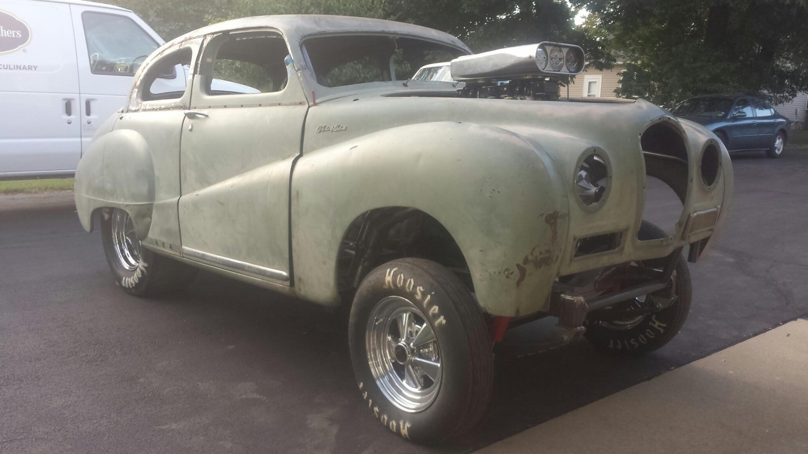

    I was just noticing, it has been a while since I had a teaser photo of the whole car, it has been a long winter! I am currently putting together the photos etc. from the tilt front end build and I will have them up soon. We had a nice day back in February so we shoved her out to catch some rays and snapped a few photos.
