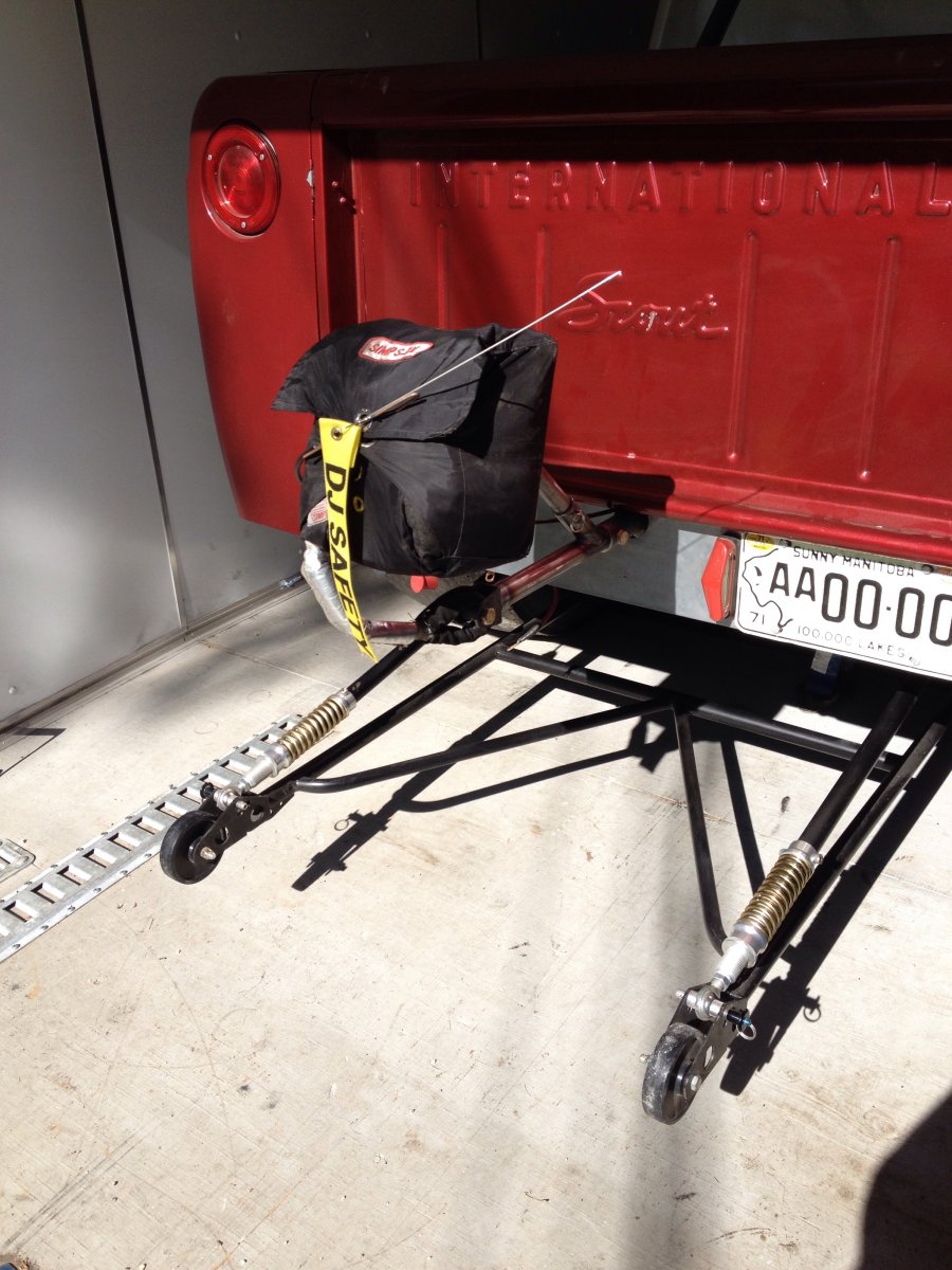

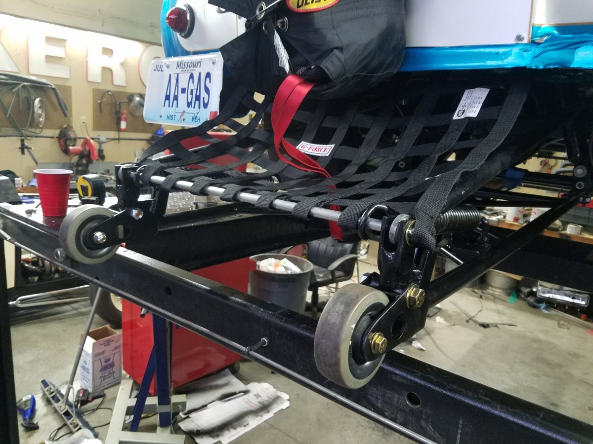

    Can you raise the front of the ladder bars to take bite out of the car? I could control the height of my wheelstand on my old Faded Memories G***er by moving the instant center by raising or lowering the front of the bars . Raising it less wheel stand , lowering it more bite and more height on the launch. I raised it up for bracket and Super Rod racing and lowered it for G***er racing . The G***er racing was more for show anyway . I went to the semi finals at Bowling green in 04 with these wheelstands.

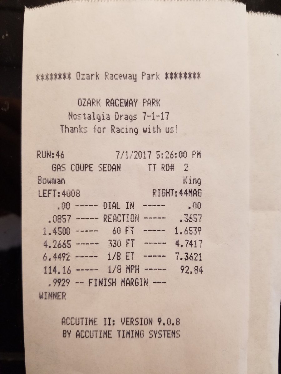

    Time slip from the Nostalgia Drags a few weeks ago....I meant to post it earlier.

    That's awesome man!! Post your slip when you get a chance please.

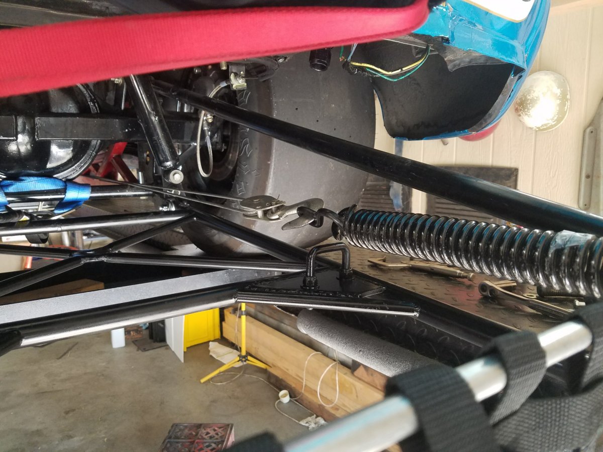

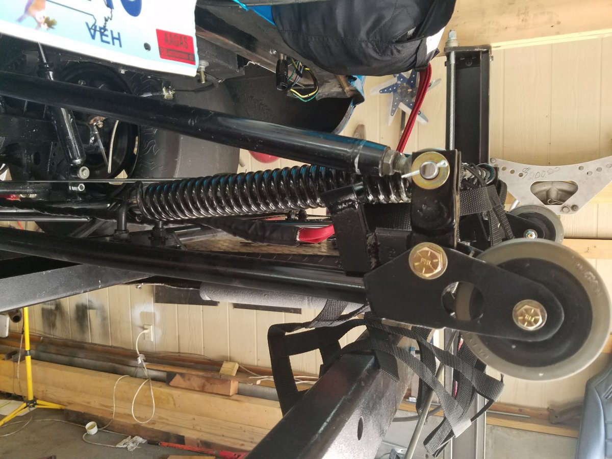

    Missed you today at Meltdown. How'd the modification to the wheelie bars work?

    Too good! But they worked just as designed. I thing we took a bit too much rotation out of it. Going to raise them a bit for the Hamb Drags. But car ran hard and straight. 9.50 right out of the box and 3/10s slower in the heat of the day Saturday but 144 mph out the back gate!
