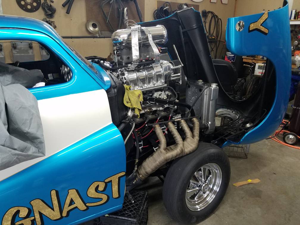

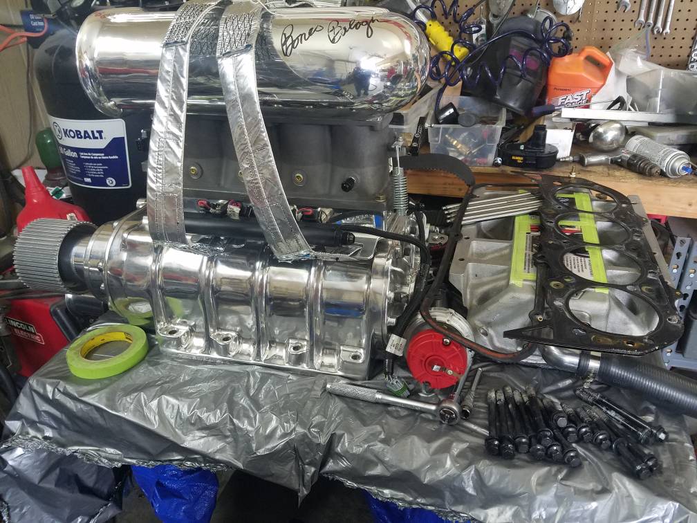

    Got Austin tore down this morning. Did a leak down test and all is well. All the Jessel valve train and headers off. Going to double check head torque then stick her back together for the HANN DRAGS....Look at me a couple weeks ahead of things....lol

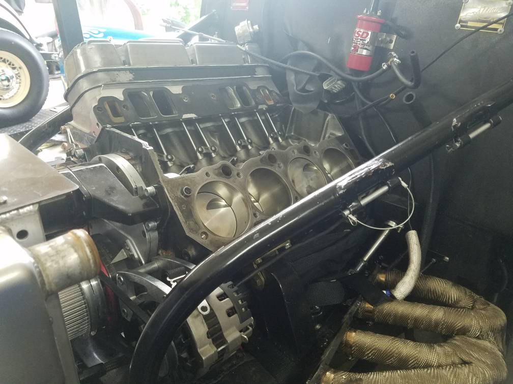

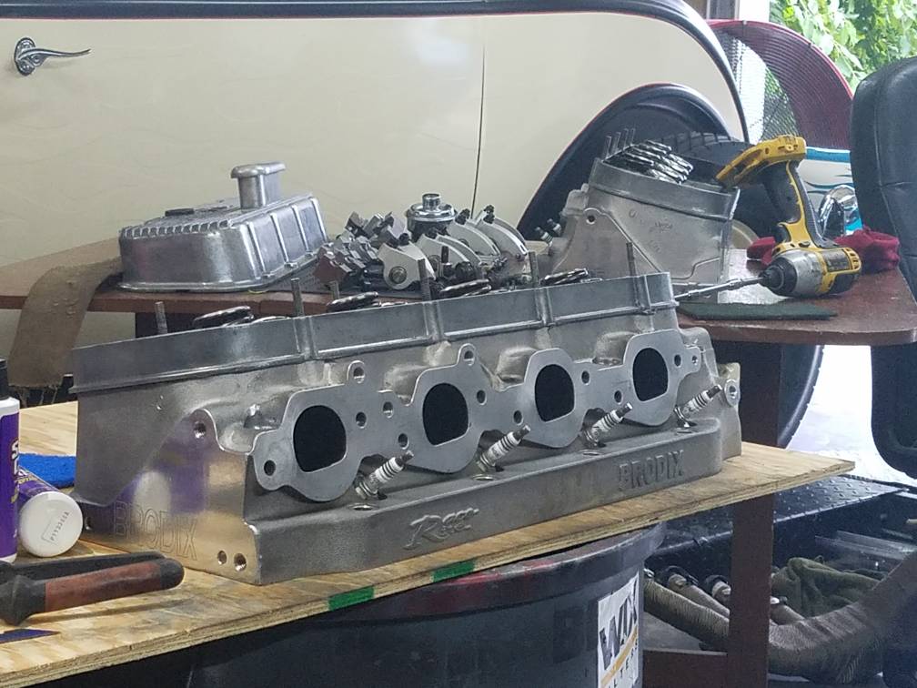

    Well things are not pretty anymore. We were checking the head torque and one of our last bolts on the driver's side was actually loose and just kept turning as we tried to tighten it.
    We tried a longer head bolt but no good. Just for fun we tried to start a 7 inch bolt...no threads left in there at all. So here is the plan. Carefully drill the head hole with 9/16 just shy of the deck. This will which just allow the tap to slip through the head. Then tap probably the last 1/8" or so the head and then into the block. Then carefully work the heilacoil down in place etc. If we are successful we will probably put a stud in this hole....if not we will have to tear into it and remove the head etc...

    Good luck with the repair. I know hindsight is 20/20 but I'm surprised on a build of this caliber you did not use head studs rather than bolts

    Wow, that ****s man! But better to find it now rather than at the big end when water squirts under your left rear at over 140!!
    IF you can get a helicoil to bite, slather that baby in loc***e before you put the stud in. It'll all have to come apart anyway if it doesn't hold.

    Agreed. We actually have a brand new set of ARP Studs for the car. However after doing a lot of research on the Jesel Pro Series Rockers I found on stock BBC heads you have to do quite a bit of altering of the studs to clear the Jesel seats. I could find no information on Brodix Race Rite Heads (not even from Brodix) but since they are based on and brag of how close they are to GM originals I ***umed the same or even worse. I talked with several trusted race engine builders and they all said avoid the head ache and just use the bolts.

    Well it was a good try and well worth the effort had we been successful. But after we got the hole in the head drilled larger we found something a bit odd in there. I kept measuring it carefully so we only drilled down like a 1/16 of an inch into the block or less. But about the time my tape on the 1/2" bit said to stop the drill just dropped. Obviously the 7/16 hole in the block was larger than 1/2. (Go fihure). So we tossed the towel on the head on fix and started taking it apart! What a pain in the back side!
