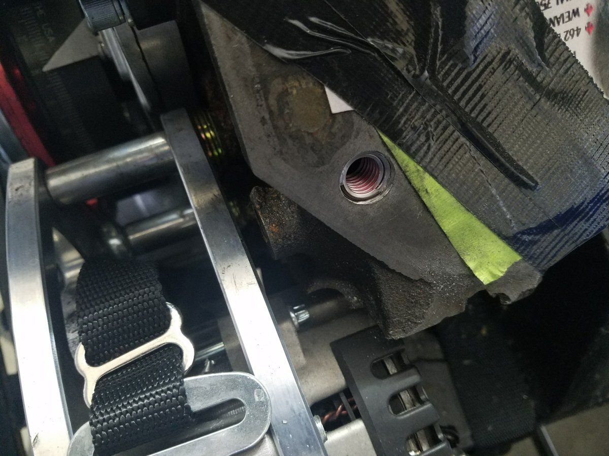

    I just got a PM from a HAMBer saying we never reported the final outcome of the helicoil episode etc. Sorry about that...we got so side tracked on bore deformation I guess I forgot.
    So as was indicated by our exploratory drilling (Lol) there were no threads in the head. But there was an over sized hole with faint tap or thread markings for about half an inch or so and then about 3 rounds of full threads way at the bottom just before entering the water jacket. I have no idea what was in this big hole before that took initial torque but what ever it was is gone! ....and the hole in question was around 9/16 in diameter.
    The only choice I saw at that point was twin helicoil. So I did some research and found a 7/16 helicoil will screw right into a 9/16 helicoil. I snagged a 9/16 kit from the parts store and the tap in the package said it required a 29/64 bit (good luck on a Sunday afternoon with that). However when we got home (bit-less) I took a look at the hole and it was just a shade larger than 9/16 we put the tap in and it was absolutely perfect and we cut the prettiest set of threads you've ever seen. Then we installed the 9/16 helicoil followed by the 7/16 both soaked in red thread lock.

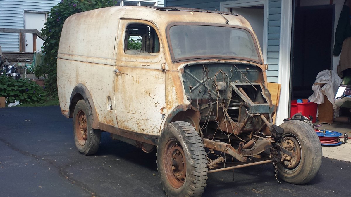

    Actually sort of a done deal around here. When I got home tonight I mentioned to Dad about the Thames Wheel Stander. He said that has been a dream of his since he bought old heap in 1968. I had no idea. He ran back to his bedroom and dug out an old note book with a ch***is design he had sketched out sometime in the 70s. So you can't argue with that...lol. Looks like a new build thread on the way.

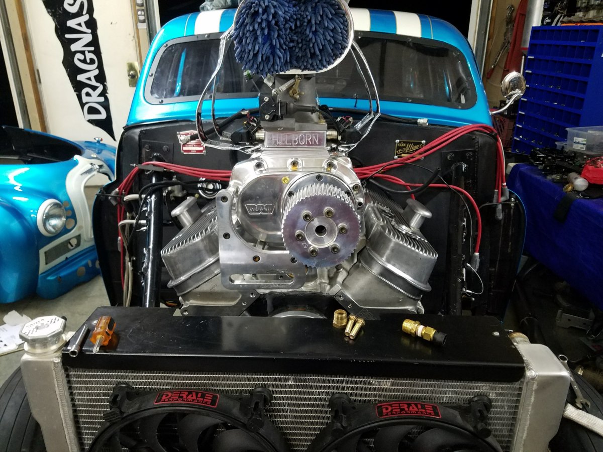

    Well she is back together again at least the worst of it anyway. As usual it seemed to fight us a bit. I actually had all the parts gathered up two days ago and was ready to rock and roll on it when I discovered JEGS had only shipped one of the Cometic Head Gaskets! So obviously we only got one head on the day before while JEGS overnighted the missing part.
    We were clicking on along pretty well last night but ran into a small issue with the thermostat extension/temp sensor holder etc. It has three 3/8" outlets and one 6 AN, which would seem plenty of options. However in either position there was a clearance issue of some sort. Basically we need another 1/2 spacer to get the original spacer far enough away from the intake to clear etc. So I am off this morning to see what I can find locally... Hopefully a quick final thrash tonight will get us to the Route 66 Festival Car Show Saturday.

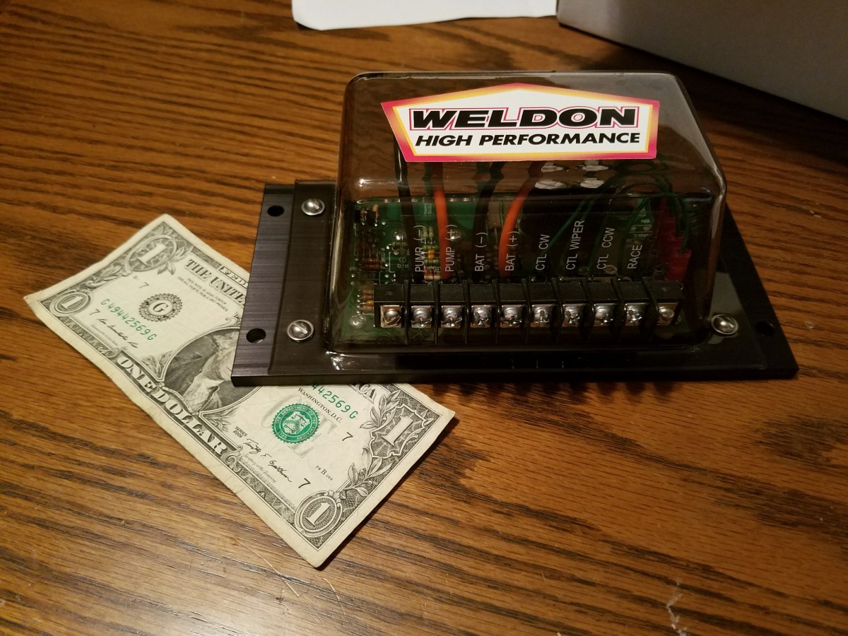

    Something sort of amusing, at least I had a good laugh at it. When Hilborn set up the parts list for the EFI system, something they added after finding out I might driver it on the street occasionally was a fuel pump controller. It is a pretty neat little device. It controls pump speed with PWM, pulse width modulation, at over 12,000 Hz. This means the electrical current to the electric motor is interrupted over 12,000 times per second to reduce the RPM. It keeps fuel cooler, minimizes cavitation, prevents vapor lock, and allows you to switch between full and controlled speed. Basically a fancy way of saying it keeps the pump cool so you can drive for long periods of time if you want...ie "Yahoo Cup" distances etc.
    This is the only photo I ever had of the product. When it came time to put everything together, this little module was MIA. We looked every where for it. I showed Dad this photo and he didn't remember ever seeing it. I am ***uming between unpacking all the individual boxes and transporting the parts out to the shop etc. we lost it. Probably just didn't see it in a box we tossed etc. So we moved forward without it. But recently I got to thinking and looking back through my photos of all the system spread out on the dinning room table. There is no sign of this little number anywhere. So I called Alkydigger to see if they had a packing list for my order and could confirm it had actually been shipped to me with the rest of the stuff. They discovered it had not. Somehow it had been left out of the order, paid for but not shipped. So being the stand up folks they are, they rounded one up and sent it to me.
    Here is the funny part, it arrived yesterday and I opened the box...here is that little module to scale....LOL
    It's HUGE! Totally caught me off guard. It was liking getting handed one of those giant joke pencils or something...LOL Hopefully we can get this little (Big) jewel wired up this next week before the HAMB DRAGS....

    Looks like Cookie Monster was standing too close to your scoop when you started the engine:)

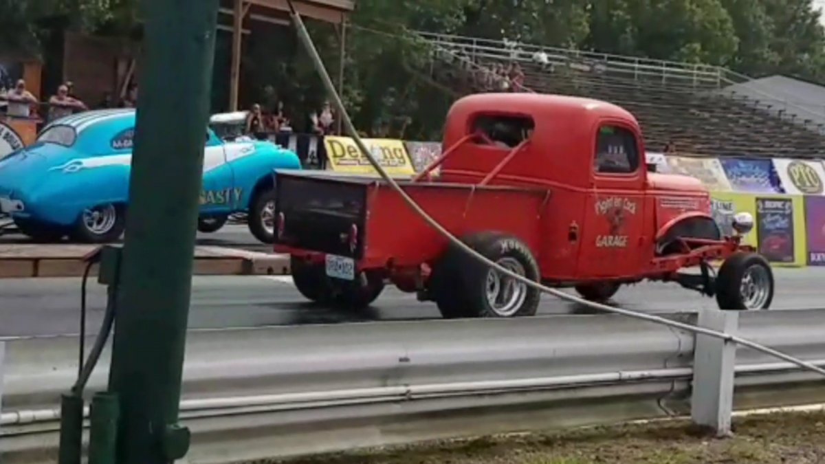

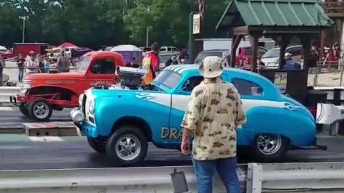

    Here is an interesting little tidbit...Since the rebuild, the Austin has made four p***es. A month ago or so we went to Ozark Raceway Park Vintage Drags and ran two 1/8 mile p***es, sort of a shake down for the Meltdowns. Our first run we ran this orange, 1938 Chevy "Bobber" style drag truck.
    Next Round we were lined up to run the Okie Twister but a few cars up someone traded spots and shoved us back one and we got the Orange Truck a second time.

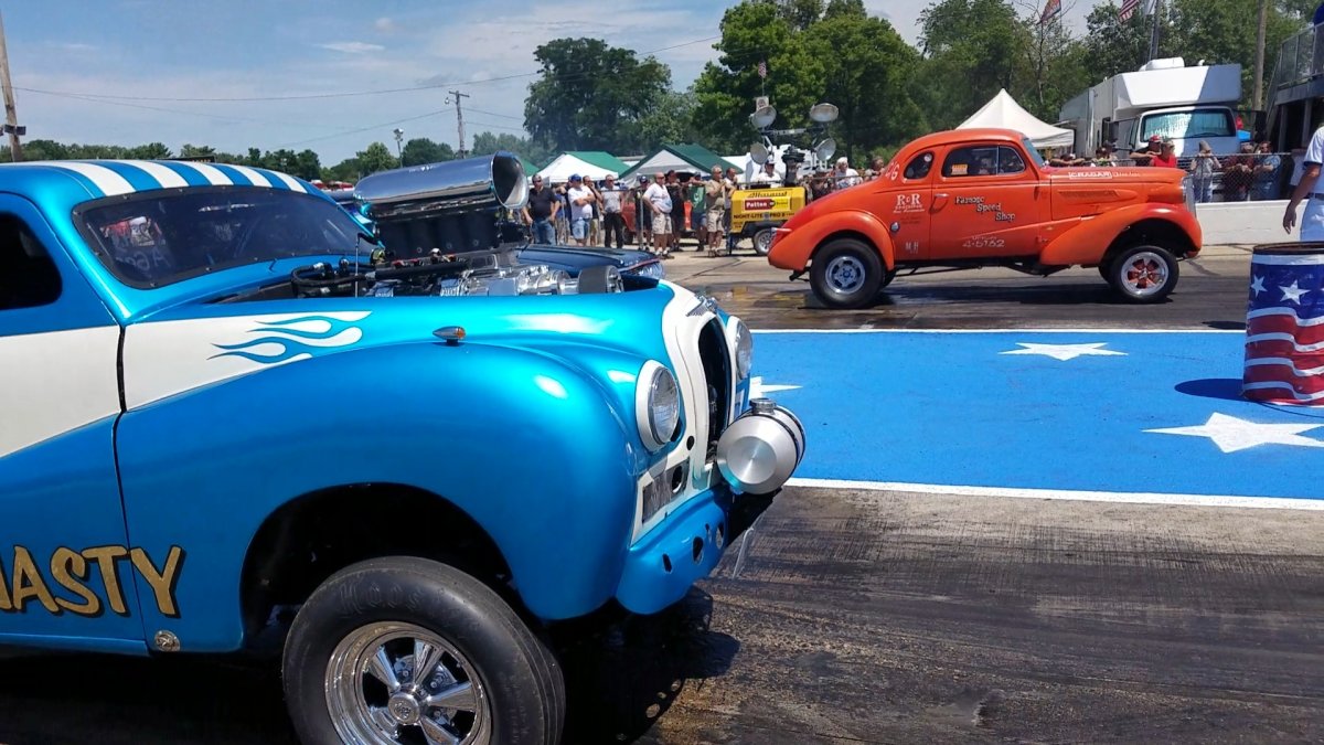

    Then it was off to the Meltdown Drags were Friday afternoon we lined up against this very fast little orange '38 Chevy Coupe, he ran a 10 flat quarter.
    Then Saturday as I rolled around the wooden burn out barriers what do I see in the other lane, another orange '38 Chevy Coupe (not the same one as Friday).
    So just for the record, we have made 4 p***es since the rebuild in two states and all four of them have been against an orange 1938 Chevy! What are the odds...
