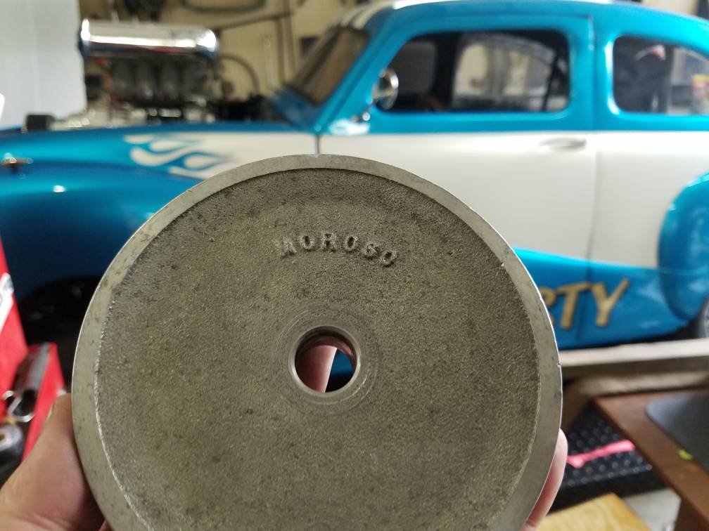

    Look what I found at the swap meet. Exactly what we went in there looking for...maybe we can keep the alternator belt on now...lol
    Sent from my SM-G930V using The H.A.M.B. mobile app
