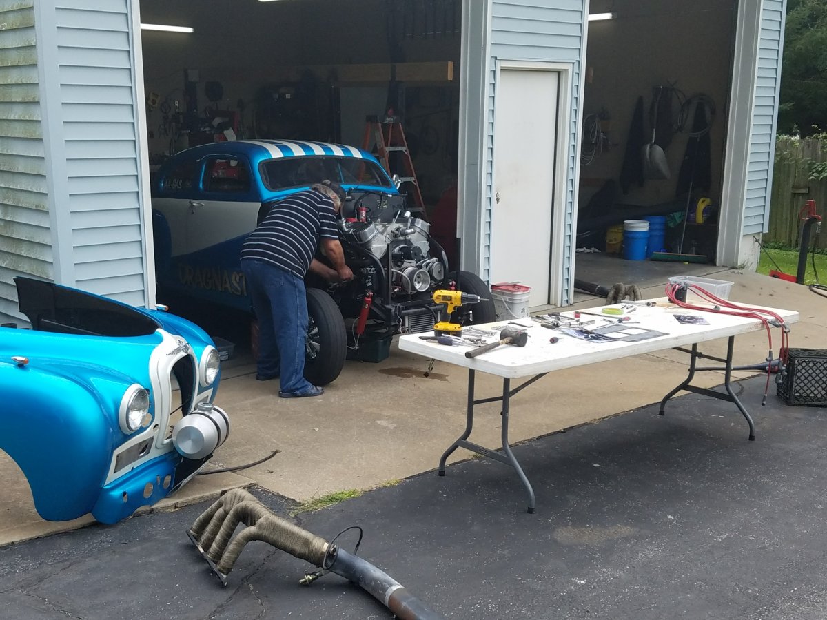

    Well this is what my driveway looked like at around 10 a.m. Saturday morning.
    We are just about ready to pull the motor...supercharger off and everything drained, unhooked, unscrewed or unplugged etc. As you know we have been through this car a bunch of times and my pet peeve is a wet floor. It seems like every time we do this, no matter how careful we are, we always end up with a wet floor. So this time we shoved the nose out the door and did all the dirty work allowing water or any spills to run down the slope outside the door. We were just about ready to roll her back into the garage on a nice clean floor when I picked up the big red ice chest sitting beside the car since the HAMB DRAGS. One of the handles broke off, I dropped it and spilled a couple of gallons of melted ice water all under the car! One of the Pepsi cans exploded as well. For crying out!

    I won't bore you with the details but suffice to say we cleaned up the water and Pepsi mix, removed the motor, separated the trans and started taking it apart. After a bit of work we got the rear section and pump off and split the case. After pulling both gear sets out we were able to get a good look at the internal shifting mechanism. Unfortunately there didn't seem to be any issues. While we were there I did remove the detent shafts that house the springs and balls. As suspected they were mushroomed a bit but not enough to lock it all up but we cleaned them up anyway, flattened and chamfered the ends and reinstalled them.
    Then we turned our attention back to the gears. It was hard to believe the issue was there because they all looked so good (No chips or missing teeth etc.) But it was obvious when I grabbed the third/fourth gear slider, it slid perfectly to the right into third but on the way back it slipped into neutral but would not move any further south.
    Fortunately on a Doug Nash none of the gears are pressed on until you get to down to 5th and Reverse. So just a couple of heavy duty snap rings and we had 1st - 3rd gears off and the slider in question in our hands. It is an extremely hard gear but it had been abused (surprise, surprise). Several of the gear teeth ends were mushroomed a bit and would not allow it to slide to the right off the neutral gear to 4th. Like I said it is extremely hard so difficult to clean up but we worked pretty hard with a file and angle die grinder etc. When we finally got it cleaned enough to slide again we re***embled the gears and dropped them all back in the case.
