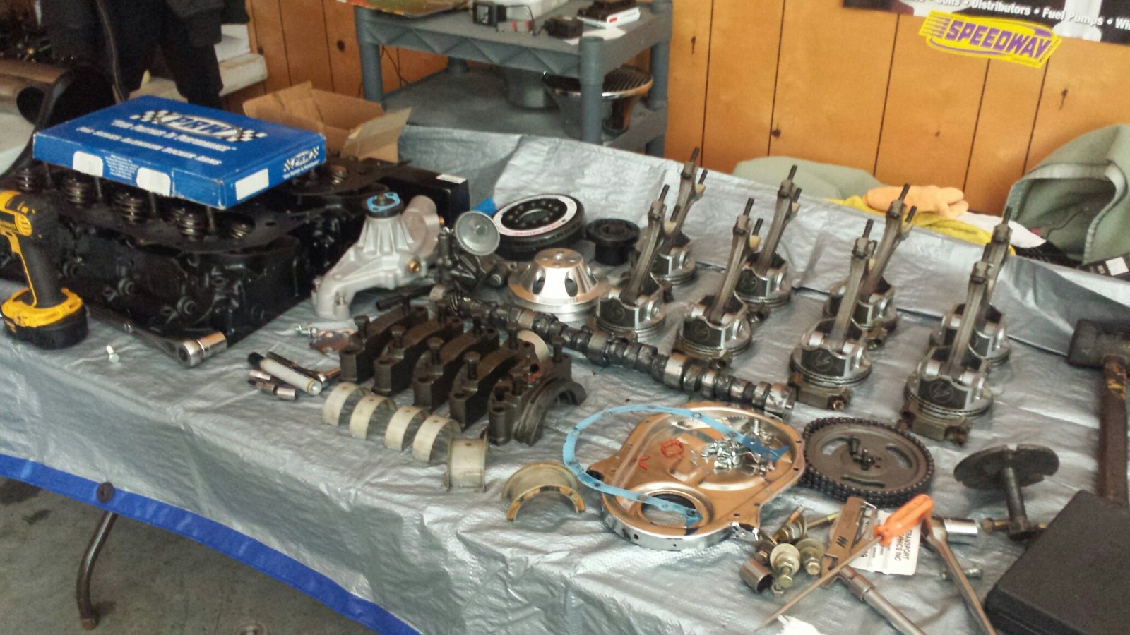

    So back to the build. You know the old saying one step forward and two steps back? Well I am living it right now. Not only that, in typical fashion for me when I stepped back I kicked over a whole new line of dominoes. Take a look at the 454 now:
    So this weekend I talked to several guys running blowers at the race track. By the end of the day I had convinced myself, even though we are not planning on over driving it or running tons of boost through it, I still want a forged crank. I had several builders tell me for what I was doing the cast crank and two bolt main would be fine. But you know me...at some point I will not be able to help myself...I will flip the pulleys and turn it up.
    If I am going to do it, now is the perfect time (well actually last month was but now is better than later) so this morning we started taking the engine back apart. However what we found inside surprised me. The motor was supposed to have forged pistons and rods in it but it did not. After pulling it apart we found a set of Speed-Pro Hypereutectic Pistons and standard old stock rods. After a quick call to my builder he apologized for the mix up and ordered me a new set of forged pistons and rods. He is also a stand up guy and since I was about to order a forged crank he offered to sell me an Eagle brand at cost and balance it for free.
    Finally with all new "forged" rotating ***embly pieces on the way I decided to have the block drilled to make it a four bolt main. Something I nearly did the first time but decided against it. ...And with the dominos falling all over the place anyway, the machinist doing the drilling offered me a killer buy on a set of billet main caps so...bing bang we are about to have a nearly bullet proof bottom end ready to take what ever we decide to throw at it.

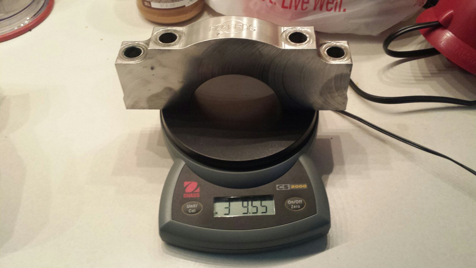

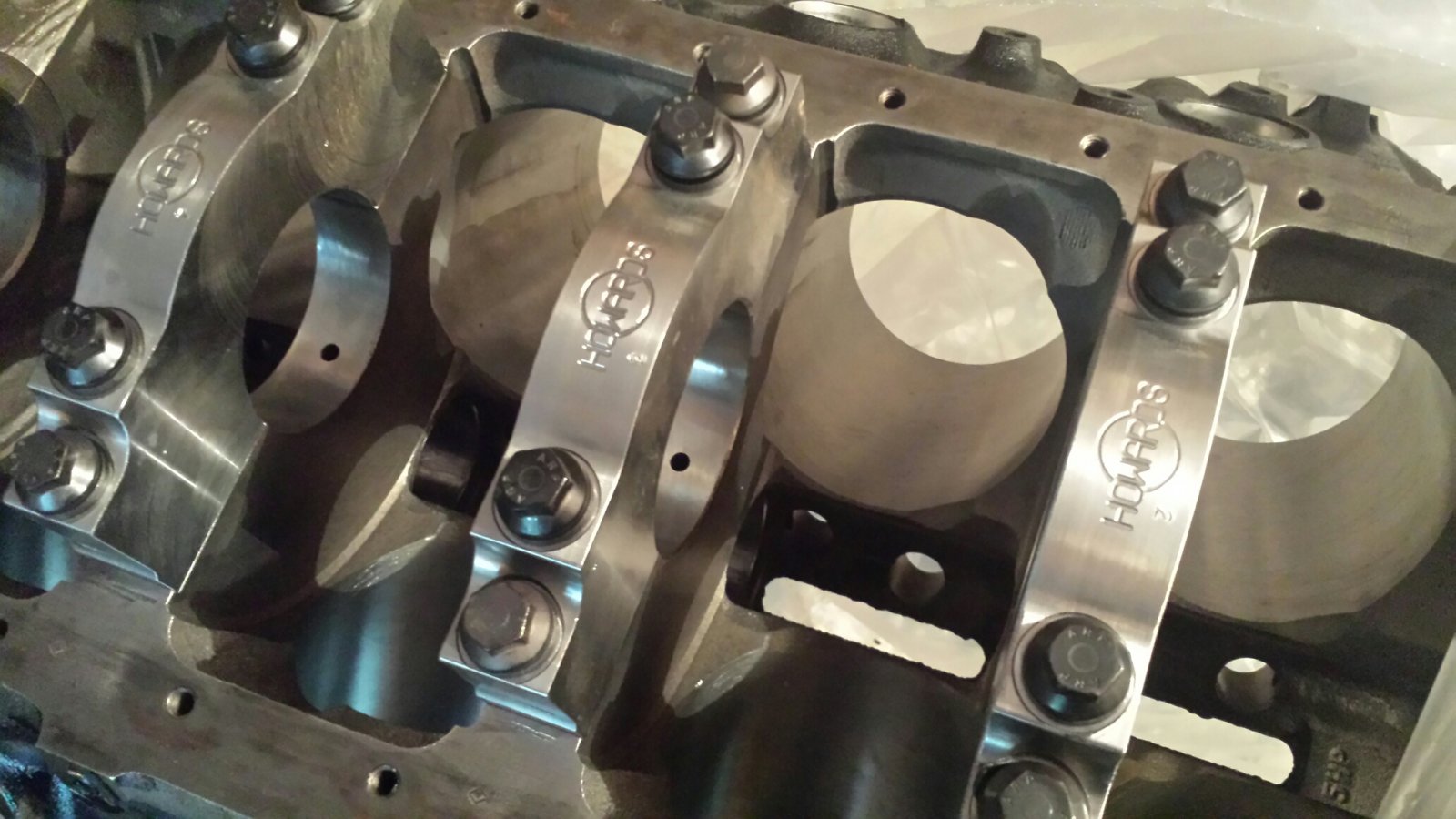

    Well I picked up the block this morning and WOW, how cool are those crazy HOWARDS Billet Main caps? The machinist said they weigh more than 20 pounds each! Pistons and rods made it in but the Eagle crank was a no show. I asked for them to cut a second keyway 180 degrees from the original and it ads a day or two to the delivery. So no motor ***embly this weekend.
    wingnutz and 01mikep like this.
  3. Awesome build... I love unique Hotrods!
    About those caps... 20 lbs at start or after finished cut?

    You know after you asked about the caps, I got to thinking, 20 lbs is a lot. The more I thought about it the more it seemed an unreasonable amount. So I went and out took one off to weigh it.
    Just over 9.5 pounds. Still a pretty good chunk of steel.

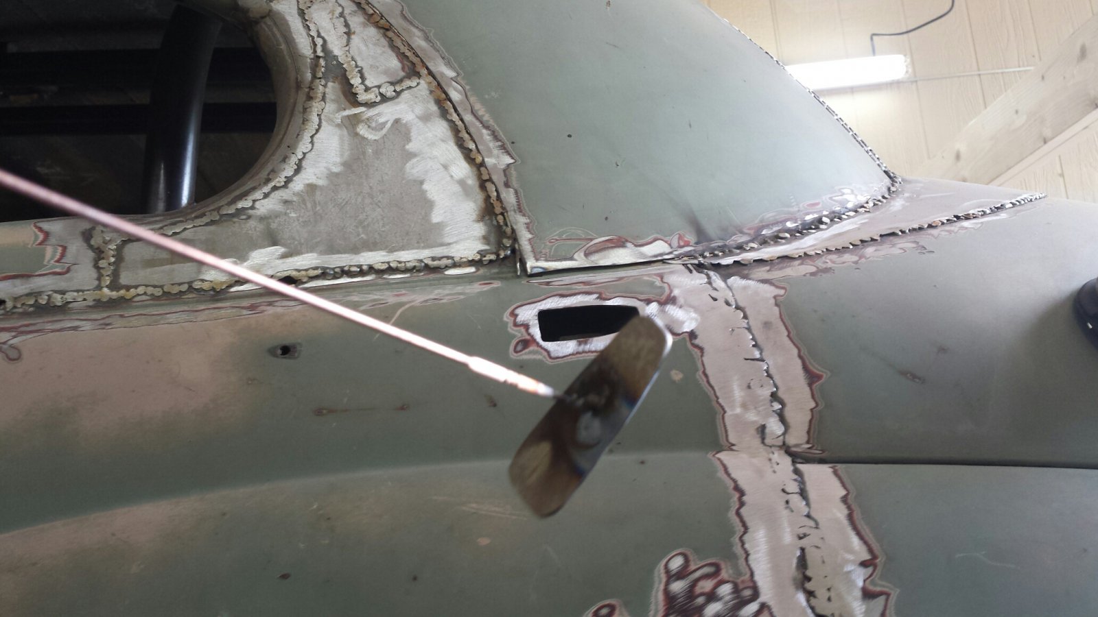

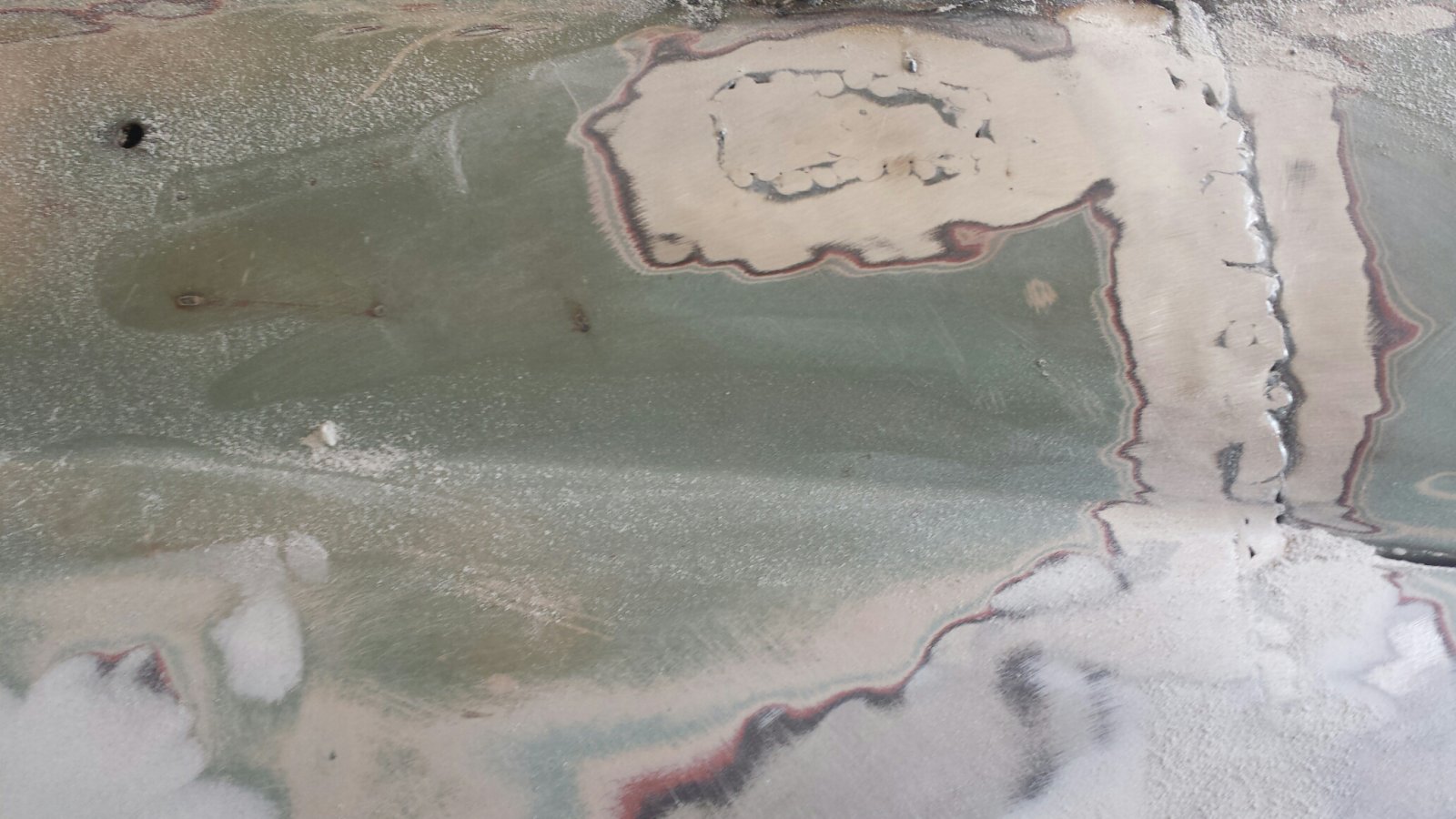

    Since we had no motor parts for ***embly we decided to do some body work. We ground the paint off the driver's side rear door opening and then welded it shut, something I have been procrastinating for months.
    While I was slowing putting the spot welds to it, Dad took a rubbing on the large door handle opening and cut a piece of sheet metal to fit it.
    After he ground on it a bit to make a prefect insert, we tacked a welding rod to it so it could be handled without dropping it inside the door and loosing it forever (which is exactly what happened to the first one)!

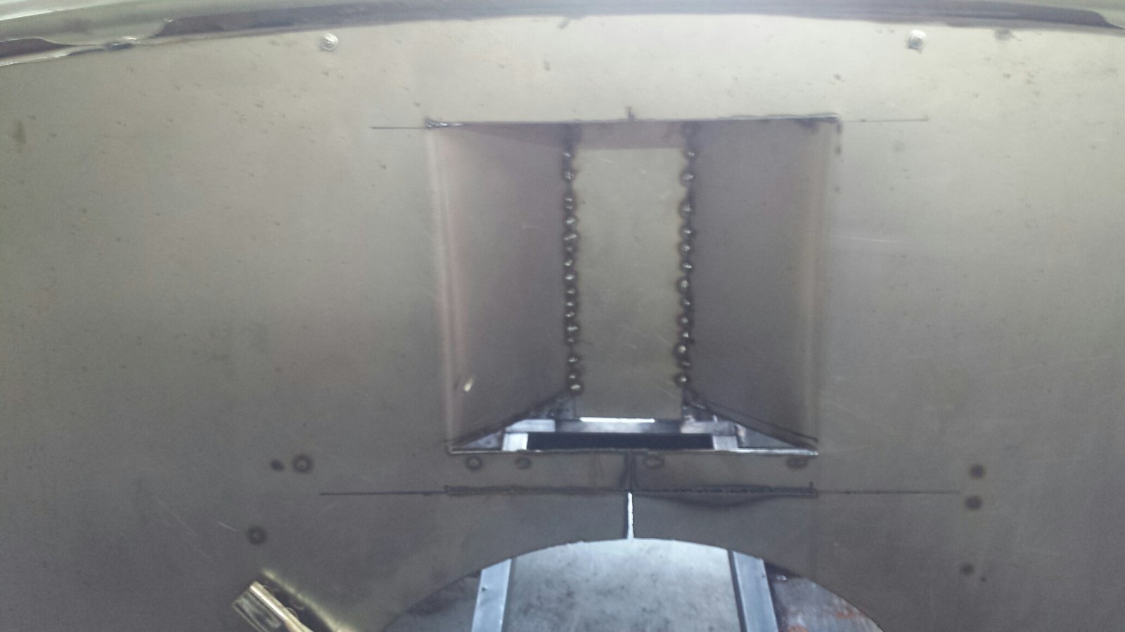

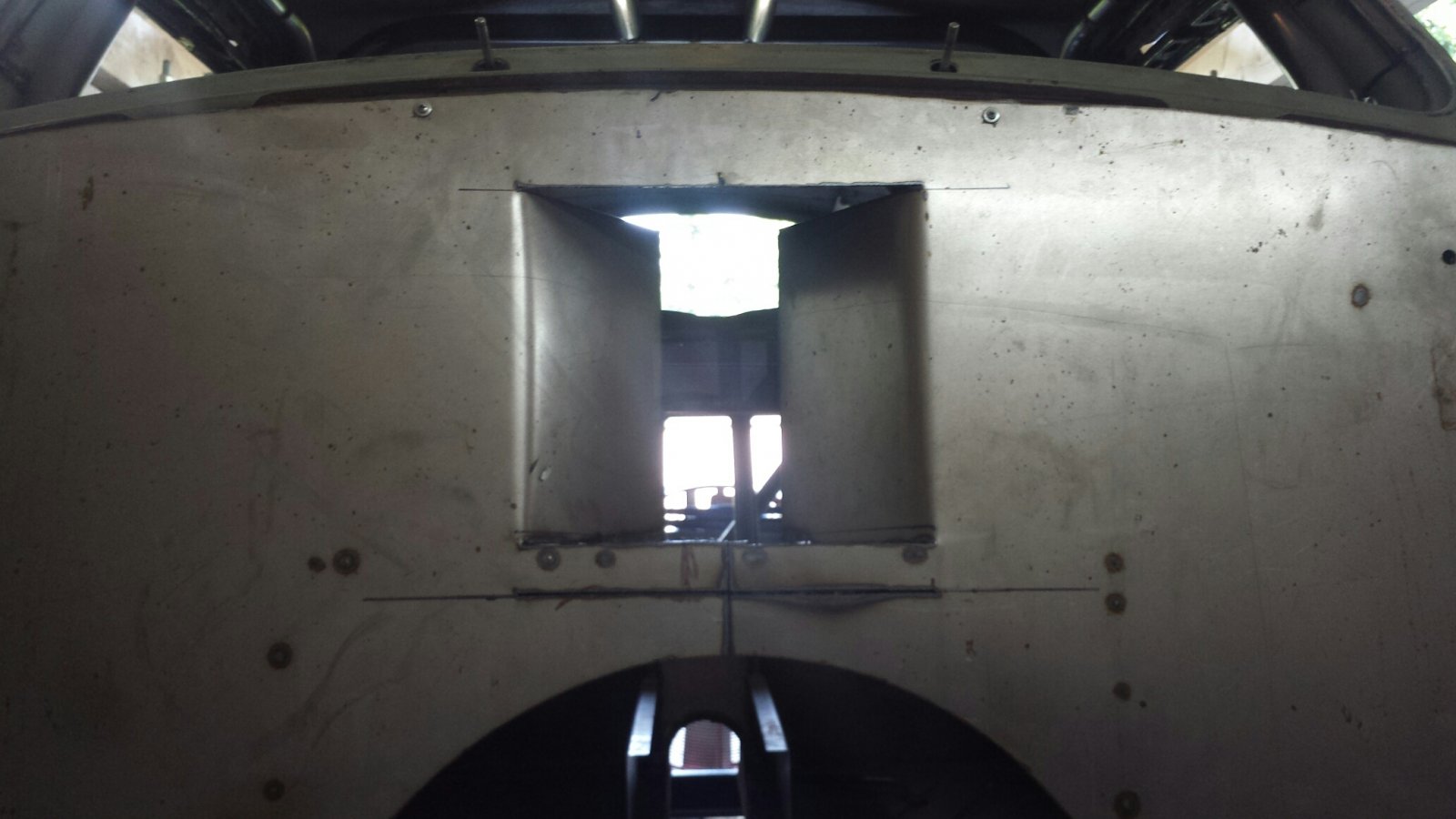

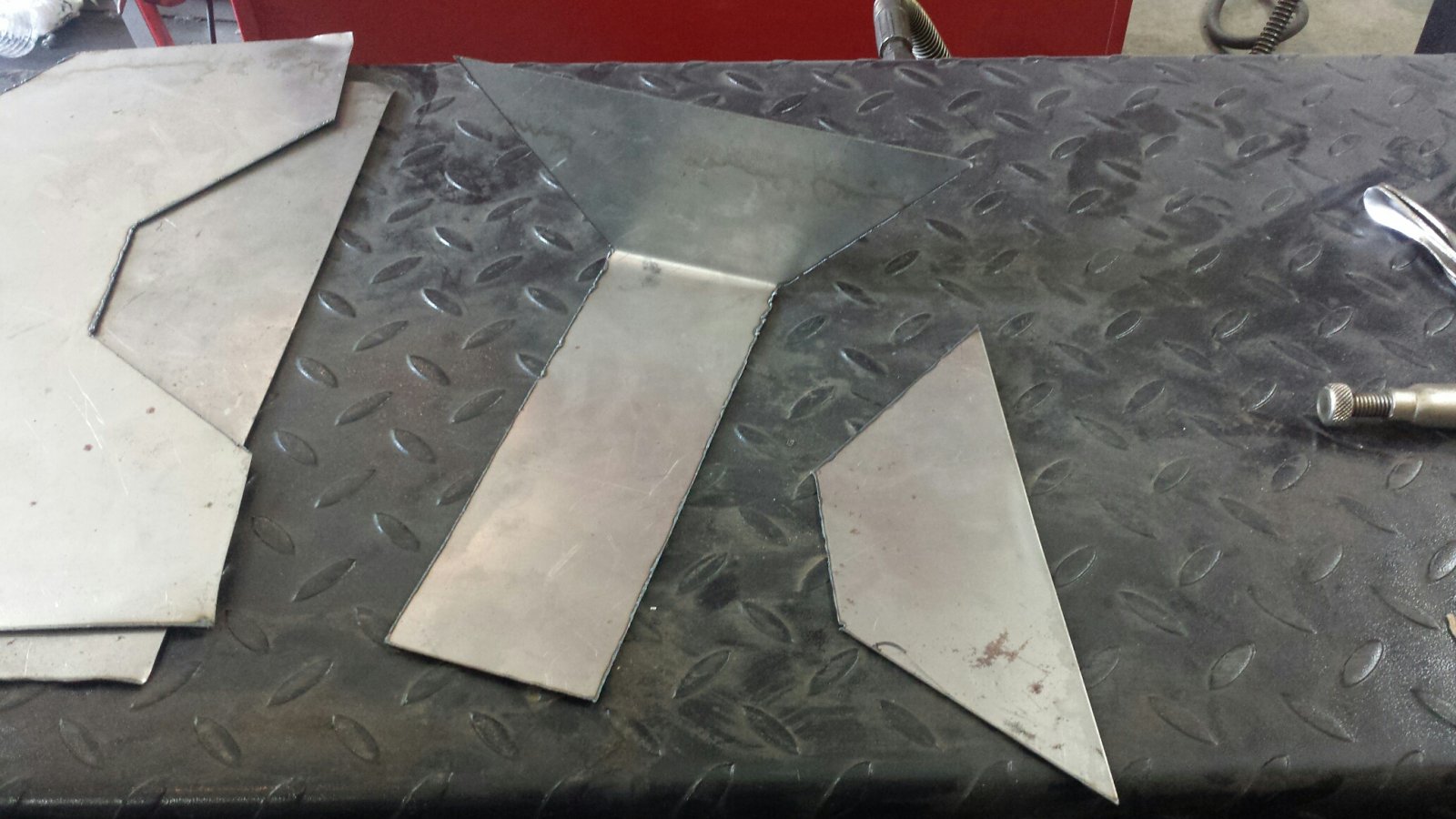

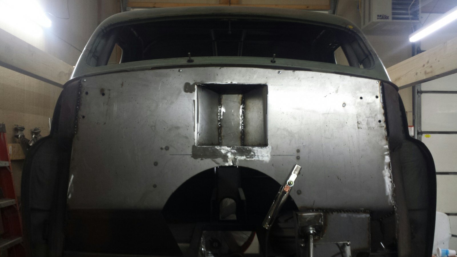

    Before we pulled the body off the ch***is last month, we marked the fire wall for what would have to be an indention for the distributor. It was close but we estimated at the time that we would need at least a 2" deep space. So today, I marked and cut a Capital "I" shape into the fire wall with the intentions of carefully pushing the area in and then adding pieces to complete the opening.
    Above you can see the original cut about an inch below the opening. I spent quite a bit of time laying out and marking those cuts. Making sure they were straight, level and centered etc. Now I ask you, what kind of yahoo goes to that much trouble with out at least feeling on the backside to make sure there is nothing in the way? Me... I totally forgot I had a piece of 1" square tubing welded there which is how the removable sheet metal tunnel is mounted. That first cut not only went through the firewall but blasted right into it as well. There was enough heat that it warped the sheet metal below it and I had to cut nearly a .25" relief straight down from it to get the area to lay flat again.
    We played with the area that had been pushed in until we were happy with the opening. Then made a pattern to cut sheet metal inserts for the top, bottom and back to complete the box. I thought it would be easier to leave the top and back insert together.
    After getting the top and back insert in place I started the slow process of spot welding it solid and then added the bottom piece to complete the indented area.
    While I was tacking in the bottom insert I also set about spot welding the mis-cut area as well. A bit of grinding and we will just forget all about that nasty little first cut.

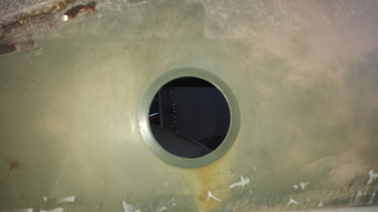

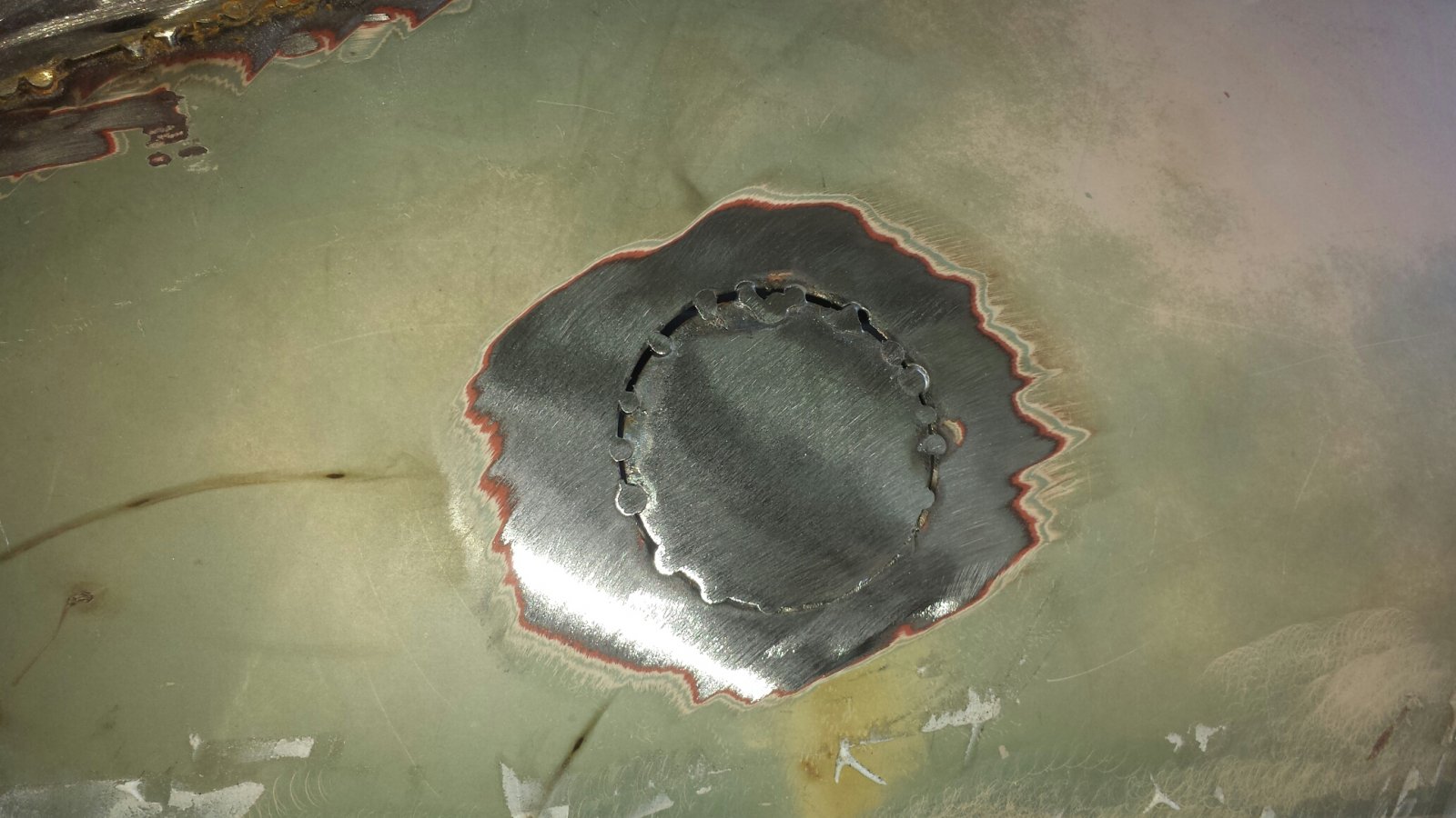

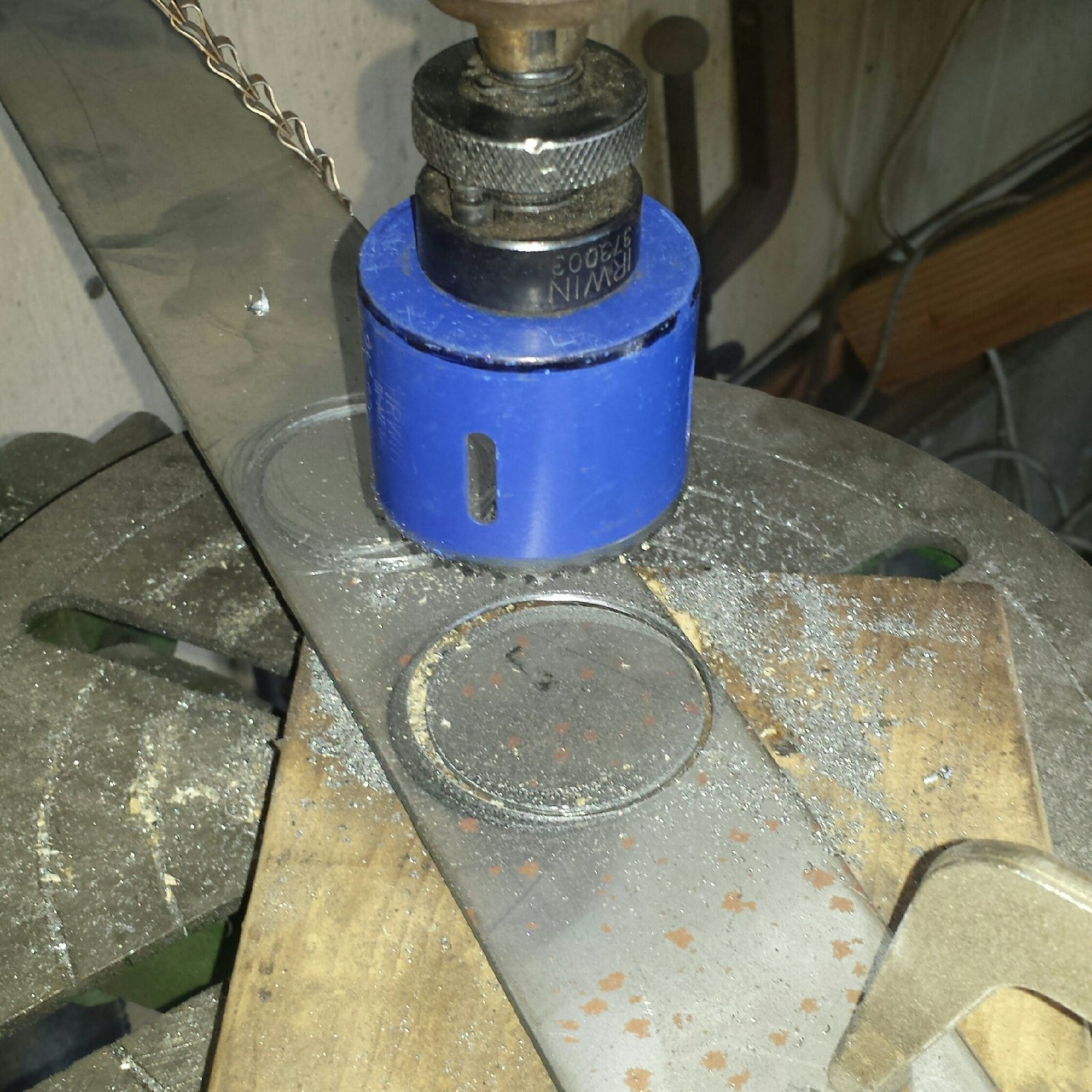

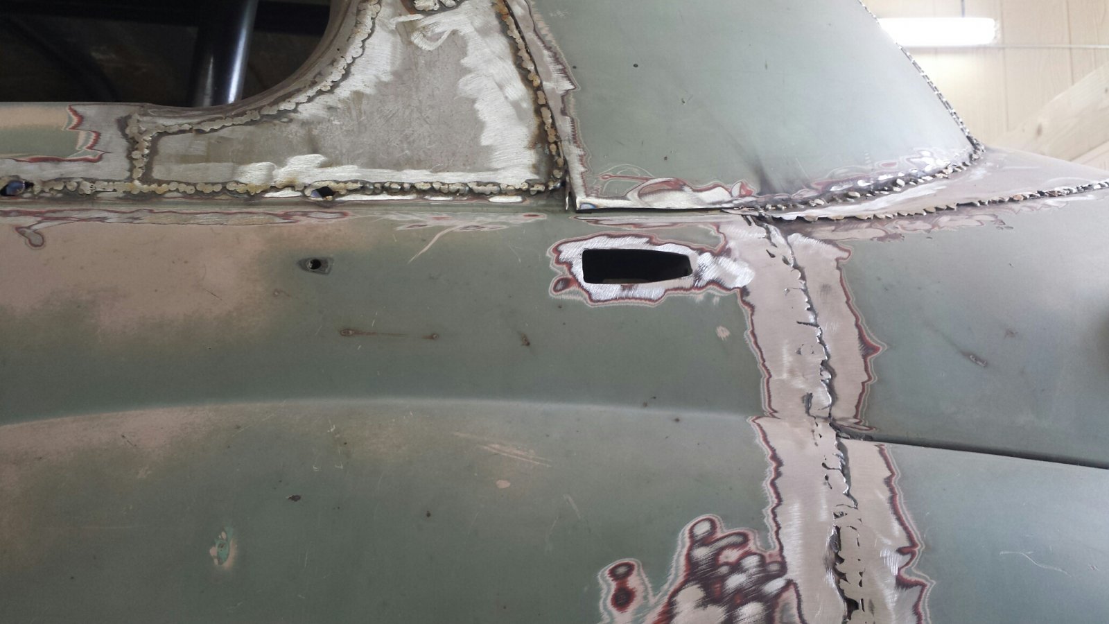

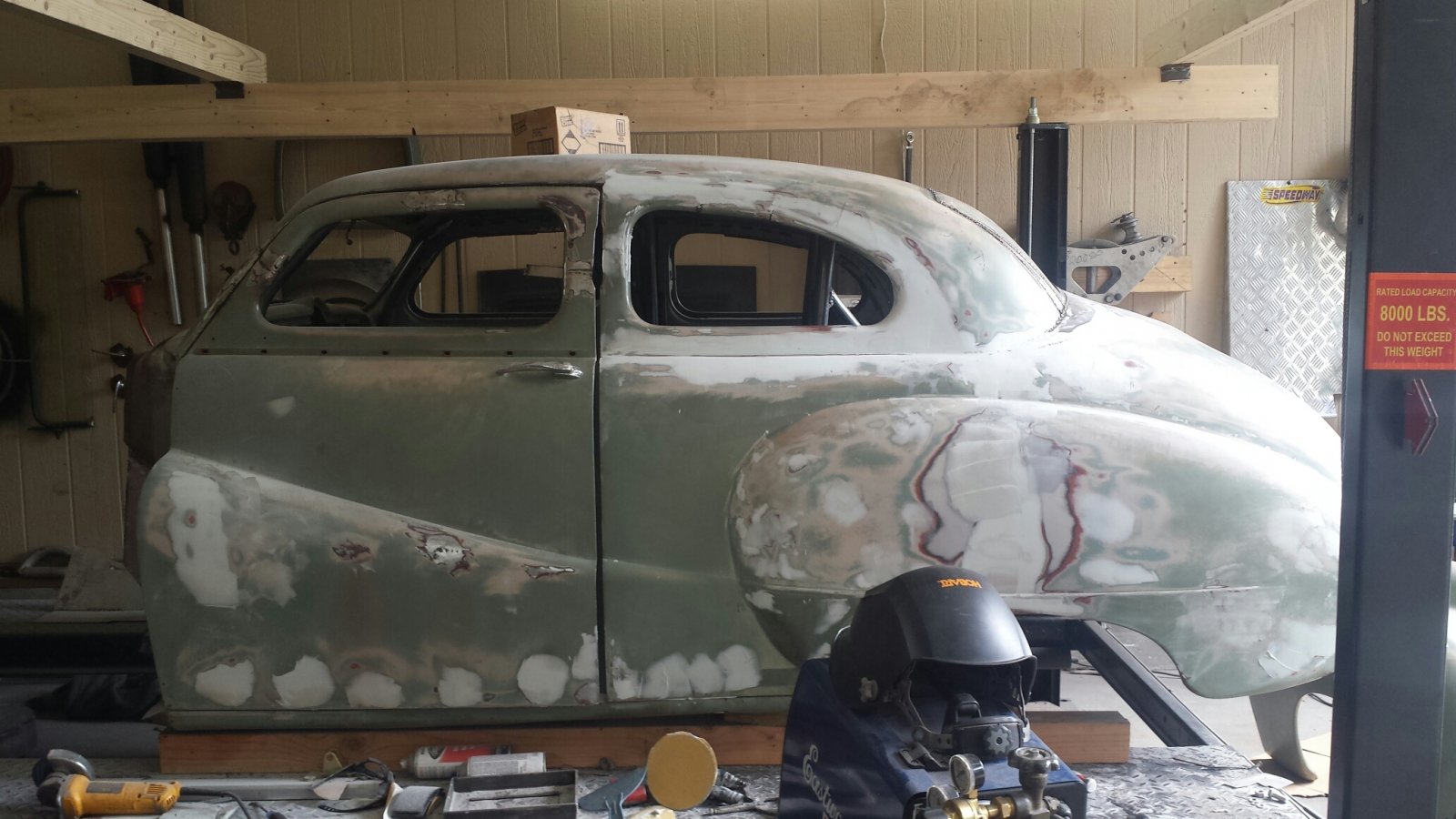

    We started this morning looking at the original gas cap on the driver's side hip. My original thought was to keep it in place and put the shut off switch in the cap. It would have been cool but not very safe. If the car ever got upside down or laid over on that side the switch might not be reachable.
    So we removed what was left of the neck and cap exposing a perfect two inch hole just above the rear fender.

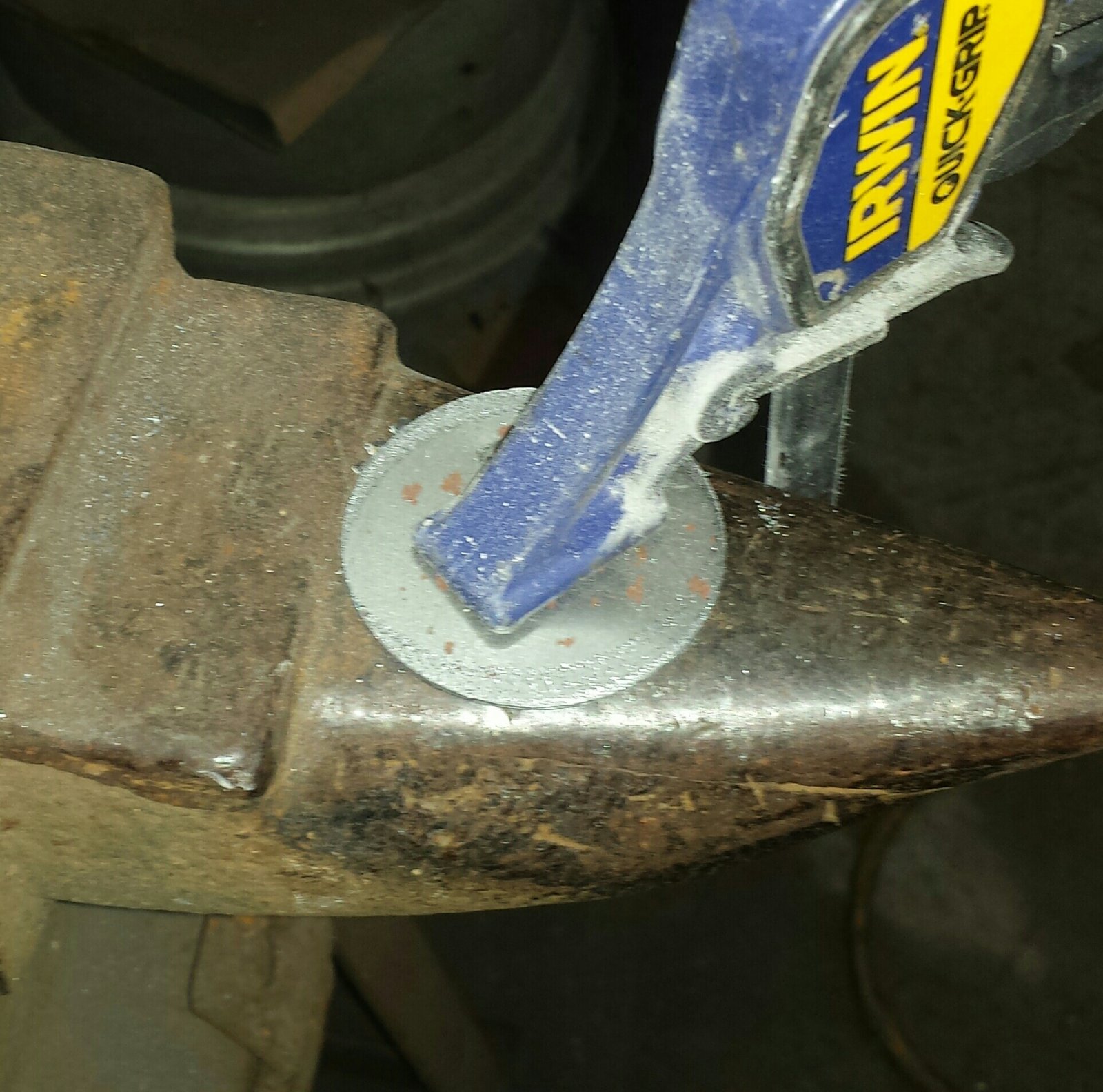

    We took a s**** of sheet metal and clamped tight enough on the drill press to get a hole saw to cut us a perfect patch.

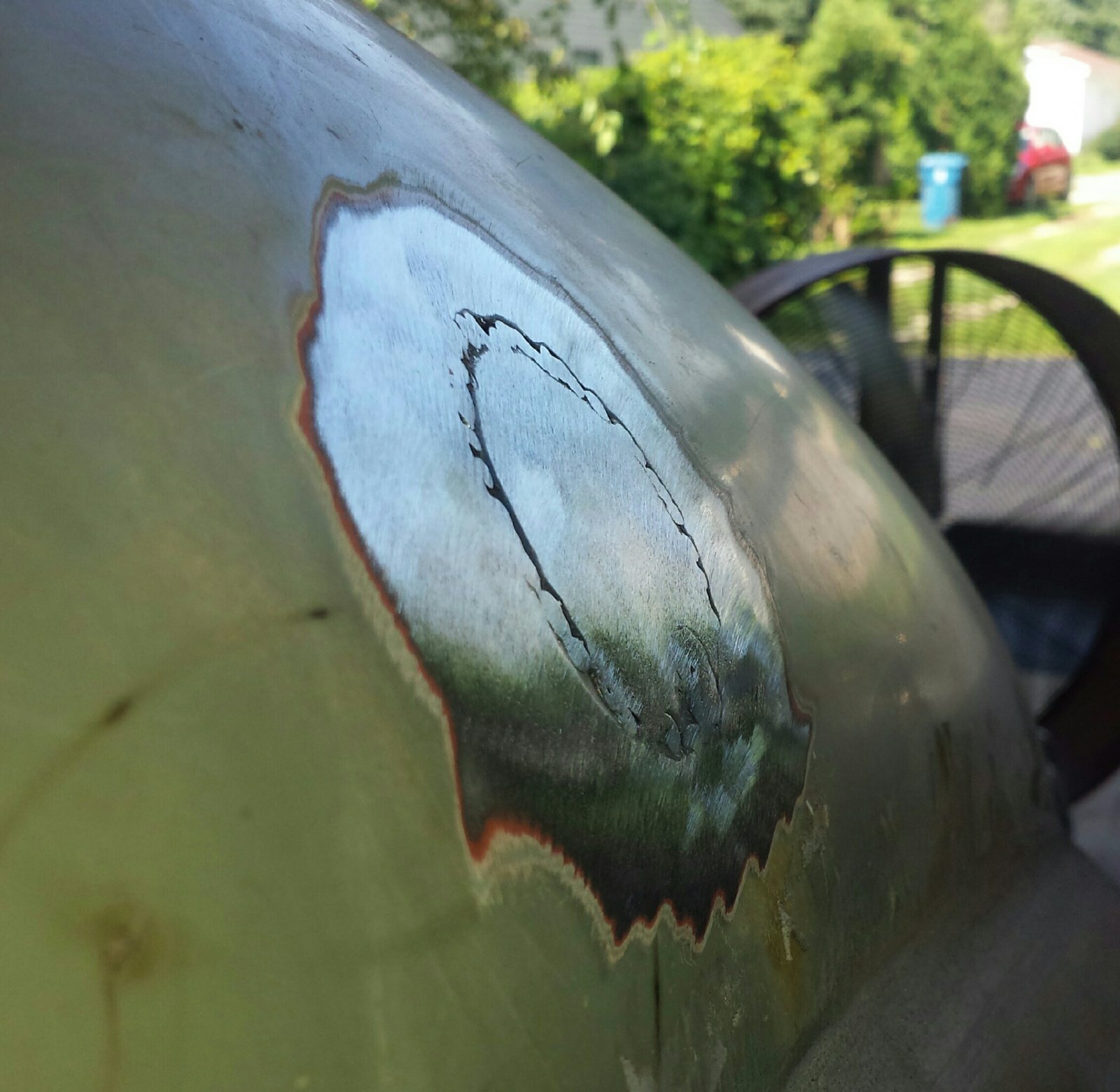

    However the fuel hole is not exactly on a flat panel. So I took our little circle and did a bit of hammering with a body hammer on the anvil. This gave it a bit of a concave shape which fits the hole like a glove.
    After a couple of rounds of tack welds we did a quick grind down to check the fit. Then after several cool down periods continued tacking until we were happy.
    The final profile of the patch is perfect and it will take a very small amount of filler to vanish the original fuel filler hole for ever.

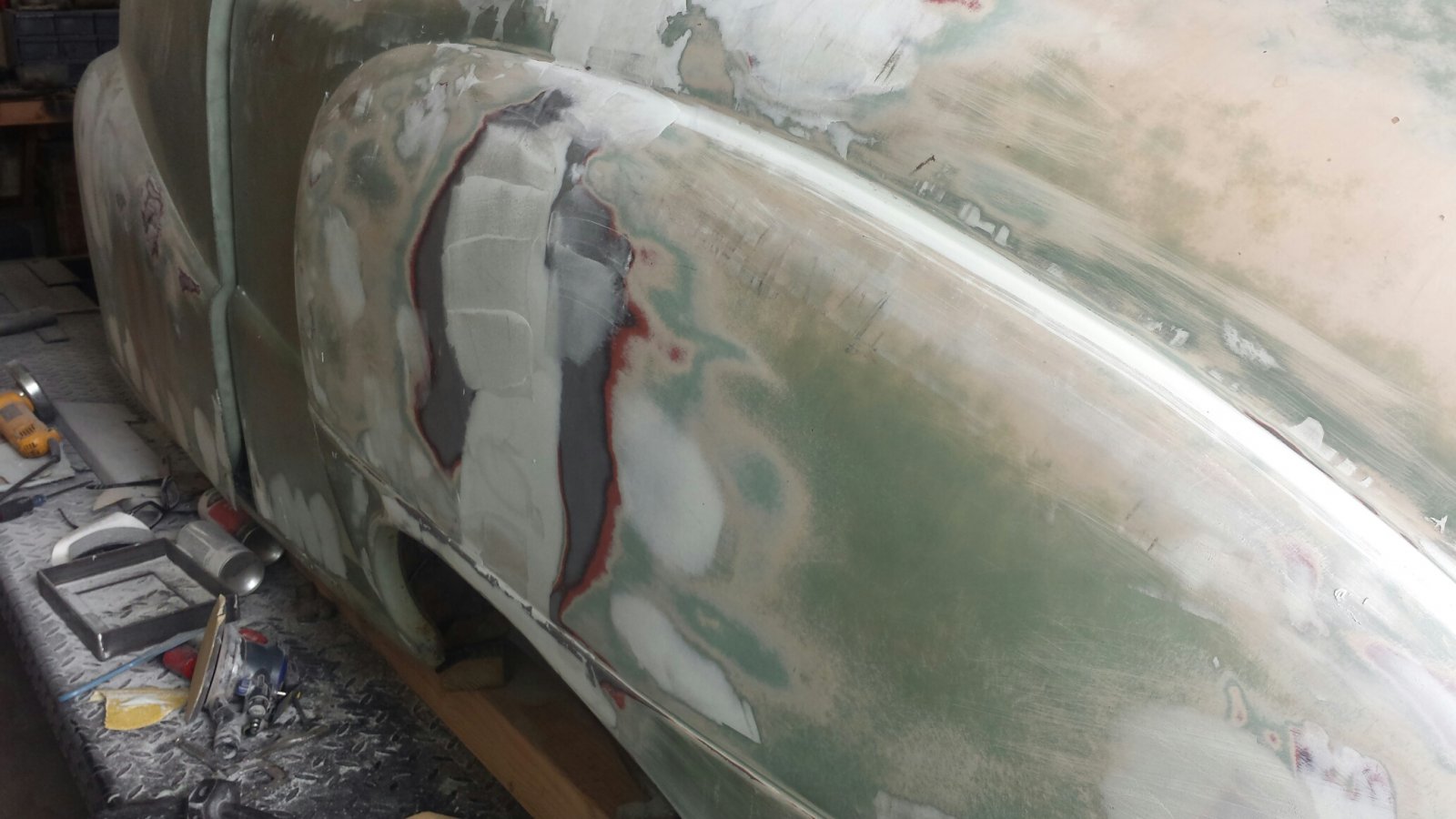

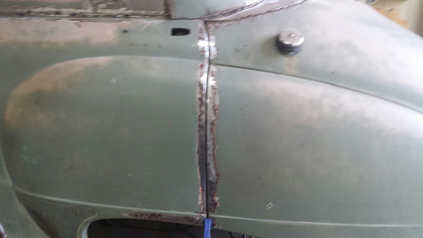

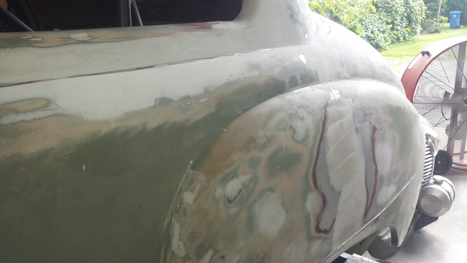

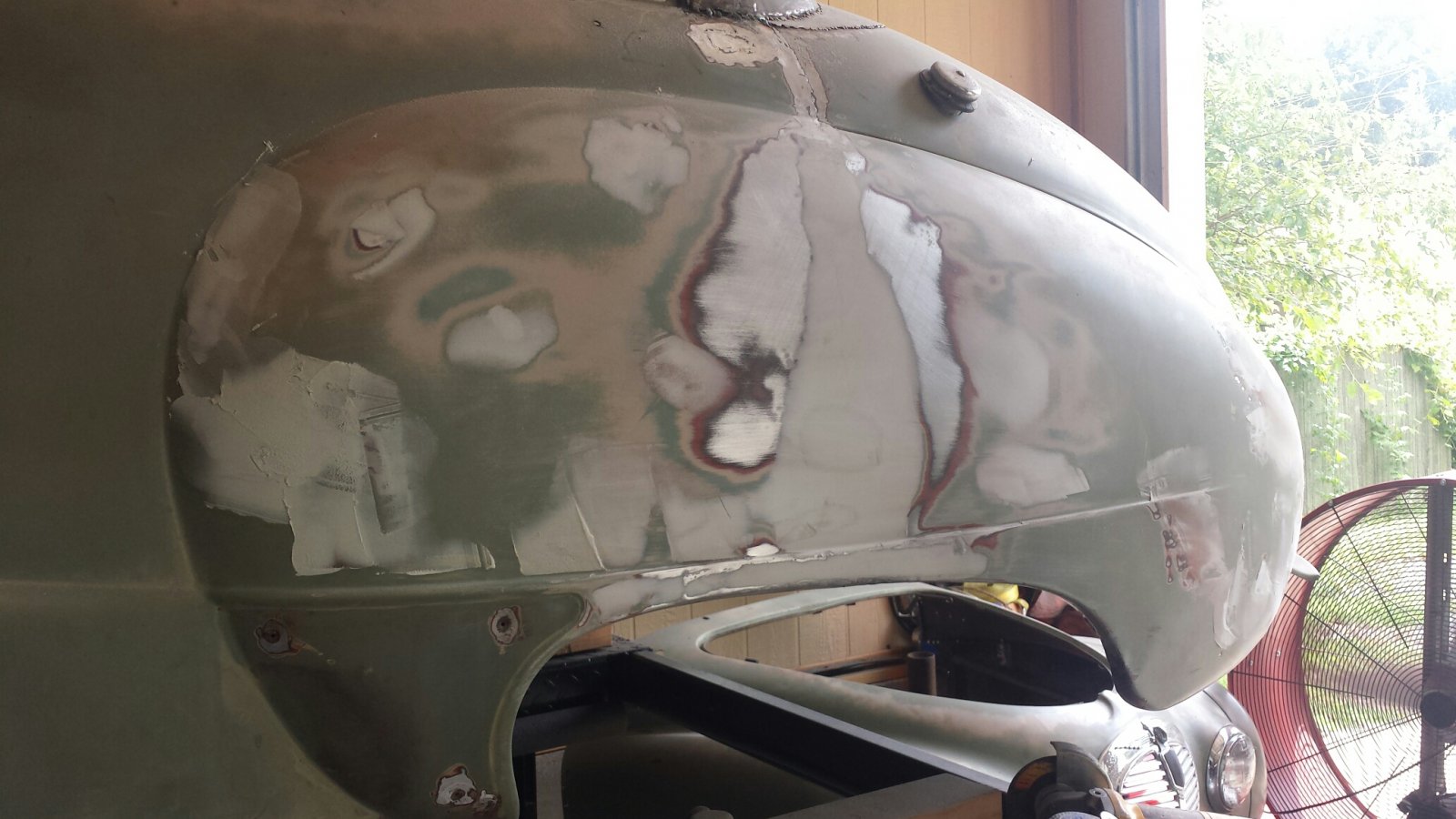

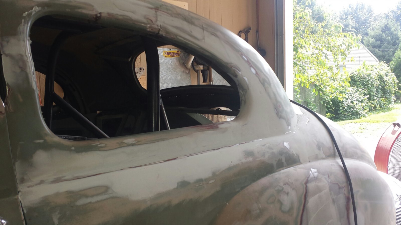

    Speaking of filler, we did some quick final grinding around the spot welds on the driver's rear side window chop work. The extra time we put in welding this area really paid off as there is hardly any filler, less than 1/8" max.
    We took our time cutting in the body lines on both the fenders and below the side windows.
    20150711_160211.jpeg It is hard to see in the photos, but all the lines are factory crisp. We have some final sanding to do on this side but the fill work and initial sanding has finally confirmed exactly what I anticipated when I first saw this body style several years ago: Chopping the top and loosing the rear door will simply make a perfect two door coupe!
    We also welded up and filled all the holes along the bottom of the door and rear quarter area from the factory moldings. Even though body work is about my least favorite thing, there was a lot of grinning this afternoon in shop.

    Actually I did get some clarification on the weight. Apparently, they START with a 20 pound piece of billet steel.
    Makes more sense.
