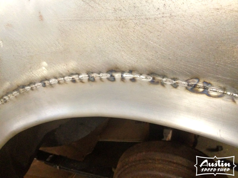

    tacked up the wheel wells, I made them in three pieces since the top was pretty much flat and the bottoms had to roll in to match the shape of the quarters.
    Once I got them all tacked in and fitting nice I welder her up, taking my time to avoid wadding up the quarter due to excess heat.

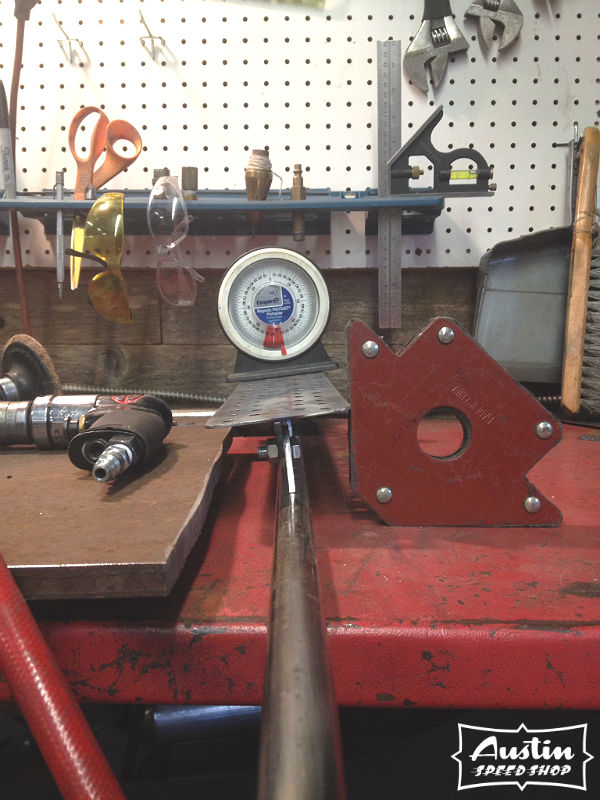

    I then bent some tubing to start the front end mounts
    I made these plates with brackets welded to them which will then be glassed in the hood to provide mounting plates for the tubing
    I then welded on small brackets the connect the tubing to the other bracket, this allows the bar to be removed for paint or chrome leaving the tabs glassed into the front clip. I had to weld them on at 7 degrees to match up with the shape of the hood area.
