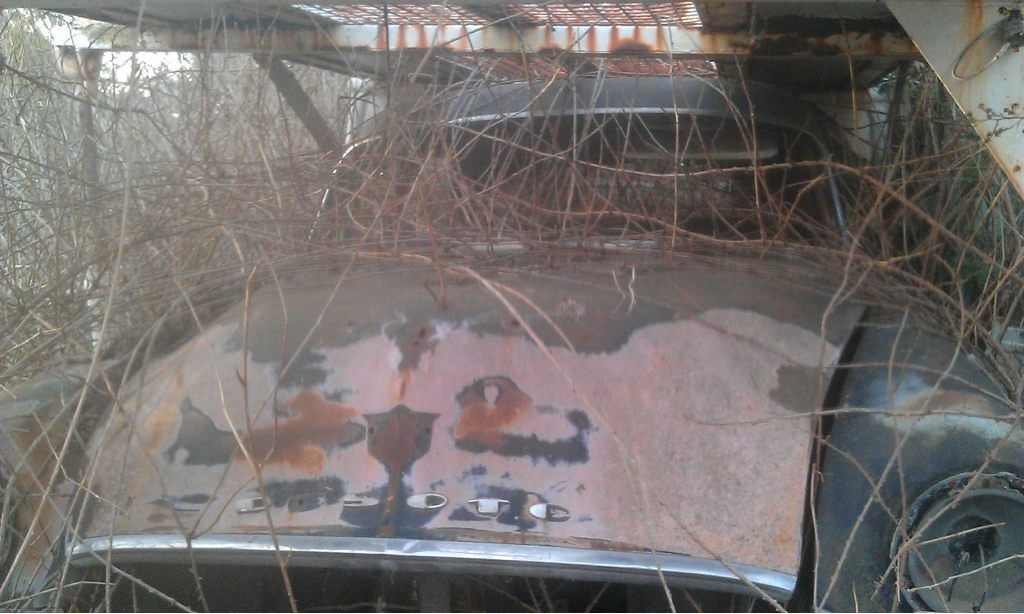

    Found this recently still on the back of the car carrier that was transporting it, full of blackberry thorns. Been sitting along time. Cool just the same.
    ImageUploadedByTJJ1353927319.469932.jpg ImageUploadedByTJJ1353927338.719230.jpg
