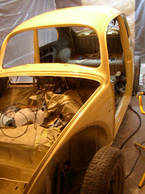

  1. I painted my sisters car a couple weeks ago and this last week I wet sanded it flat, followed by buffing it. When I was done I noticed a bunch of pin holes in the clear on the roof. I assume it is from the body filler(possible air bubbles). What's the best/easiest way to fix this? I am using all PPG paint products. Thanks...

  16. I looked the car all over again tonight. I ended up finding one more spot that had the same problem. And in this area there was no body filler. So that cancels that out. Here are the pictures I took tonight. Let me know what you think...
    Wesley

    yep solvent pop sucks. happened to me on my camaro (cough). If you use too fast hardener/reducer, the clear starts to dry before the solvents can fully evaporate, and as the solvents do evaporate, it creats holes. Normally the clear would continue to flow and you wouldnt have any holes.. anyways.. yes you can let it cure, mix up some clear, and dab it into the holes so it fills them creating a bump, and then let it harden and sand the bumps smooth and buff. It works well. or you can just sand it with some 800 without breaking through the clear or trying to get those holes out all the way, and put on a couple more coats until they are gone and filled (be careful, runs suck). If they were in the bondo, the same mothods would still fix it on a color where the pinholes werent noticeable. If it were a silver or something, you would see the pinholes through the basecoat real bad and youd just have to repaint. good luck.
    PS: upon close examination of the pics, those look like bondo pinholes to me.

    i agree that it looks like bondo pinholes.... could be some funky fisheyes, but doesn't look like solvent pop to me... they don't look deep enough to me to require primer, i would think you could just sand the material that's there down and the clear/base you sprayed should be enough to level it off. i'd use some sealer over it thought before re-base/clearing it though...

    what happens when you sand it!! see if they flat'n out or what!! its hard to see in that pic but you said this happened in areas were you had no bodyfiller so i am guessing solvent pop/fisheyes if this is true you should be able to just blend in some clear on just those pannels??
