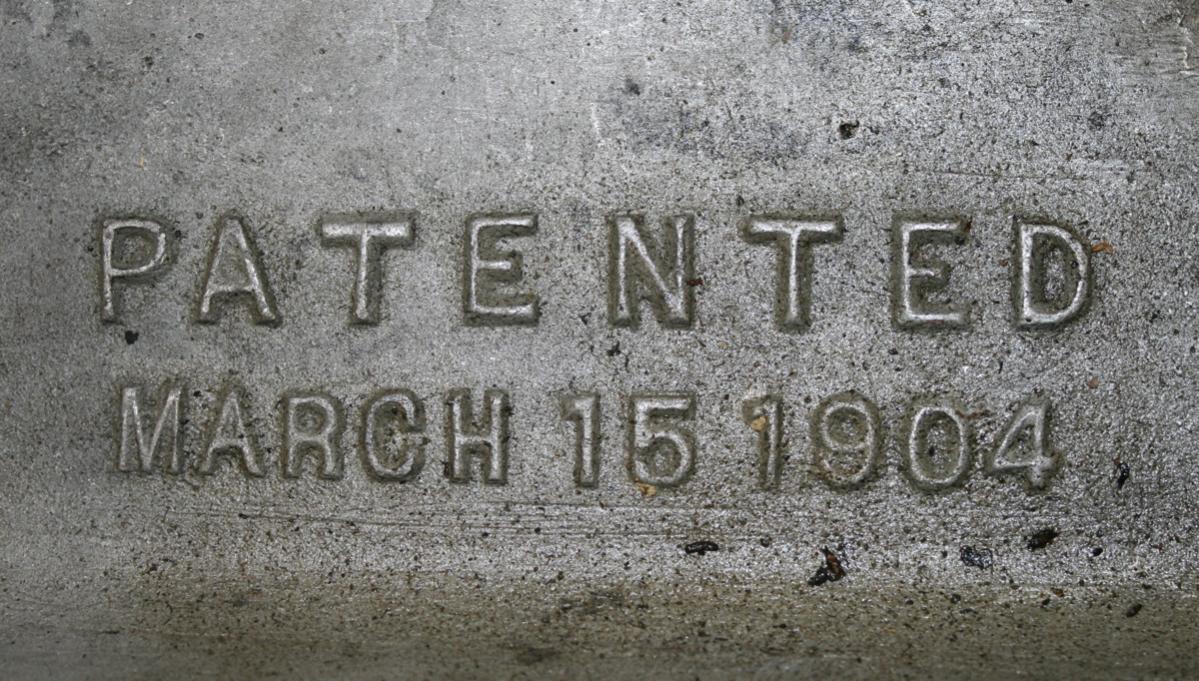

    I you showed photos of a Simplex chain drive trans-diff a while back and thought you might be interested in see what a Thomas unit looks like.
    This is the same type of unit that was used from 1904-1912 in their four and six cylinder cars. This same trans-diff was in the Vanderbilt car and other early racers and also in the Ny to Paris car. In the NY to Paris car they pulled this out of the car in the middle of Siberia as the ring gear had stripped some teeth. Just getting one of these out of the car is an ordeal and I was thinking about this as we removed this one from the car yesterday. It takes two days of dis***embly and rigging to get one of these out of the car with modern equipment
    They had to do this in the middle of nowhere with only the tools they had with them and no jacks or chains falls like we used. This ***embly is 18" wide x 38" long and it must weigh 400lbs.
    Schuster dissembled it and took out the ring gear and softened it in a wood fire. He then drilled and taped holes in a row where the teeth used to be and drilled and tapped holes with a hand drill !!! put in bolts or screws and then filed them to the shape of a gear tooth.
    They then re***embled it put it in the car and beat it to Paris, truly unbelievable, the guy was an Iron Man.
    I will post more photos when we get the cover off so you can see what it looks like.

    T-head, do you think Schuster might have shared some DNA with Burt Munro? Sounds like something Burt would have done.

    Just by way of a slight correction, according to George Schuster, in his book The Longest Auto Race, the stripped teeth were repaired by George Miller, his companion for most of the trip, while he was out looking for a spare transmission that had been shipped and lost.
    The transmission repair finally failed several days later and Schuster had to go 215 miles by horse to retrieve the finally located new one, then bring it back. He states that it took all day for he and Miller to install it.
    Boggles my mind how this was done with few tools or hoists.
