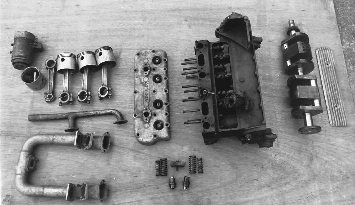

  1. In the early 20's Ed Winfield and Art Sparks created cranks for their Model T engines that had the 1 & 2 pistons up (at the same time); and 3 & 4 down. As Sparks explained that alleviated having two intake valves open at the same time. This then created more power!

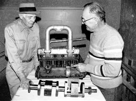

  3. A "Flat Plane" crank with a firing order of 1243 gives each cylinder an equal charge (the Fords are "Two-Port" intakes). Makes for a more powerful engine. Winfield "****ed the Goggles Off" many a fellow dirt track oval driver. The original race car, like many or perhaps most race cars of the 20's and 30's is no more. Rick Rawlins acquired the original engine. Pete Eastwood made a recreation of the car for the engine.

    I hope I can clear up the Winfield " 2 up / 2 down " deal , as there is incorrect info on here .
    On a stock T engine the firing order is 1 2 4 3 .
    Cylinders 1&2 share an intake port and 3 & 4 share an take port .
    So the fuel flow goes 1 - 2 and then a lag for 1 & 2 .
    Next the fuel flow goes 4-3 and then a lag for 4 & 3 .
    This results in an uneven fuel distribution .
    with me so far ?
    With the Winfield crank & cam , things are different .
    The new firing order is 1 3 2 4 .
    1 & 2 still share the same intake port and 3 & 4 share their port .
    The advantage is , with the new firing order , the fuel flow is even at each port ,
    #1 gets a shot from the 1-2 port . Then #3 gets a shot from the 3-4 port .
    Then #2 gets a shot from the 1-2 port . Them #4 gets a shot from the 3-4 port .
    Still with me ?
    The fuel delivery are spaced evenly , no " lag " so no " rich - lean " on the shared port .
    Fuel delivery is improved & the performance goes up !
    Any questions ?

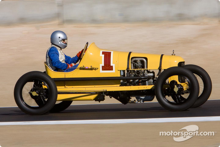

    I'm thankful for everyone involved, starting with Crazy Chris for finding and storing the engine for years, right up to Pete building a car for it. I'd rather listen to a "tribute", running the original hart than look at a pile of parts. Bob

    With the first two rod throws ganged together and the last two throws ganged together aren't there additional vibration issues introduced? It seems like it would shake the bejeebers out of the ch***is. That could be OK for a race car with a billet crank but I could see why no manufacturers embraced that concept for a street driven vehicle. The crank pictured sure has a ton of couterweight on it.
    How are the vibrations in the replica car?
    Thanks for the explanation Pete. I see now that the issue is similar to a stock headed inline Chevy six with siamesed intake ports.

    Yes , you are right , vibration was / is a problem with this set up .
    When Rick had the engine rebuilt , is was run on a dyno .
    It was dis***embled & rebalanced a few times before they were satisfied .
    Story I heard was , when they were chasing the balance problem , someone at the shop ,
    pointed out it was like 2 Triumph motorcycle engines stuck together , so they applied
    some Triumph balancing methods . Don't know if this is true , but I liked the story !
    I've watched & heard the car run , Rick says it's fairly smooth .
    When he ran it at Monterey he told me it was fast . He also races a Bugatti & an Alpha , so I asked " is it fast for a model T " & he said , no " it's fast for a race car " !
