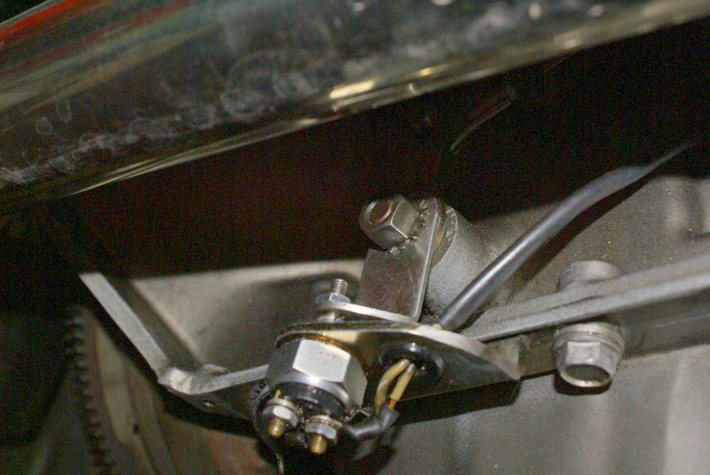

    I agree with "Blue One" regarding the neutral safety switch, however I decided I wanted a backup light.
    My RPU has some serious blind spots when running a top and I also occasionally drive at night. I need all the help I can get!
    Gennie Shifter supplied a bracket that bolts on using the pan bolts and I built a simple bracket that uses the shift lever bolt to mount and used 1.JPG 2.JPG 2-1.JPG 3.JPG the same neutral safety switch. I used a small ****on head bolt to depress the switch when in reverse.
    If your used to driving a car with a automatic column shift, the Gennie Shifter feels completely natural
    (the exact same shift pattern and lockouts).
