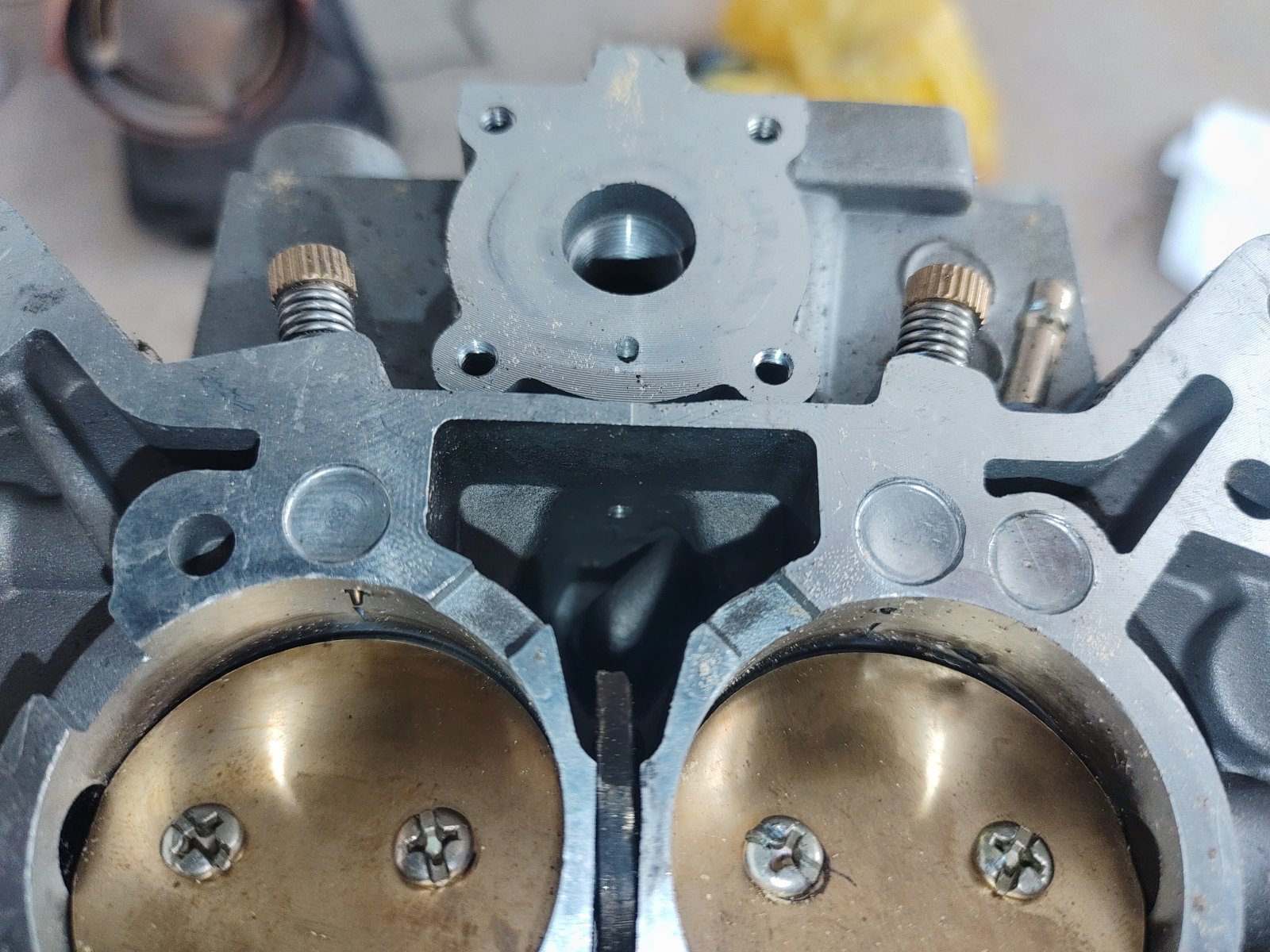

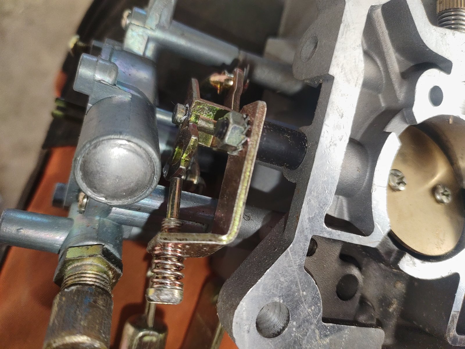

  9. Pontmerc
    Joined: Jul 13, 2013
    Posts: 463
    Pontmerc
    from Finland
    17151831590857099557341216045248.jpg For the high idle, have you check fast idle cam adjust screw?
    Oneball likes this.
  10. Pontmerc
    Posts: 463
    Pontmerc
    from Finland
    And if powervalve leaking thru you will not see it in venturis because power valve vacuun channel is in bottom between bores.
    And i just look one of my spare 4100 and it has total of 6 air bleed holes in booster ***embly. 17151830221572415832285562520564.jpg

    Oneball
    Yes. It was stuck on that.

    Oneball
    That’s the vacuum signal orifice, fuel will go through the venturis, it was also dry in there so I know the pv isn’t blown.

    I guarantee, if power valve leaking thru, it wil **** raw gasoline via that vacuun signal orifice.
    But you dont have to believe me and you are sure power valve is not leaking.
  15. Oneball
    Joined: Jul 30, 2023
    Posts: 1,913
    Oneball
    I see what you mean now, it’s definitely not leaking through there as it was completely dry when I took it apart.

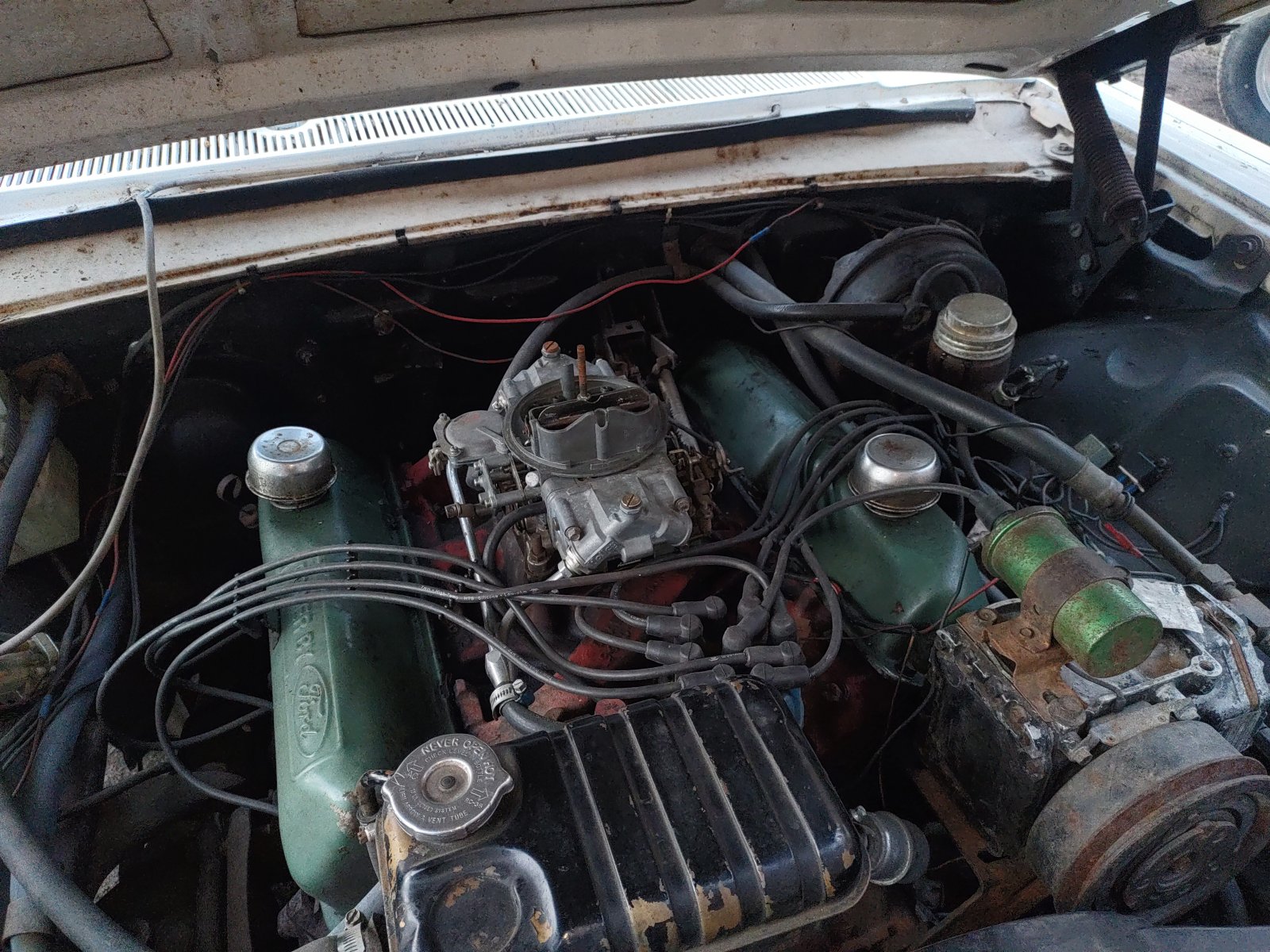

  20. Pontmerc
    Posts: 463
    Pontmerc
    from Finland
    Sometimes its better take break with difficult malfunction and just bolt temporarily known good holley 600 in place of autolite.
    Just wake this beaty up at my barn where it was sitting two years. 17151927029919056879623045990614.jpg 17151927236286883082523023454429.jpg
    Oneball likes this.
