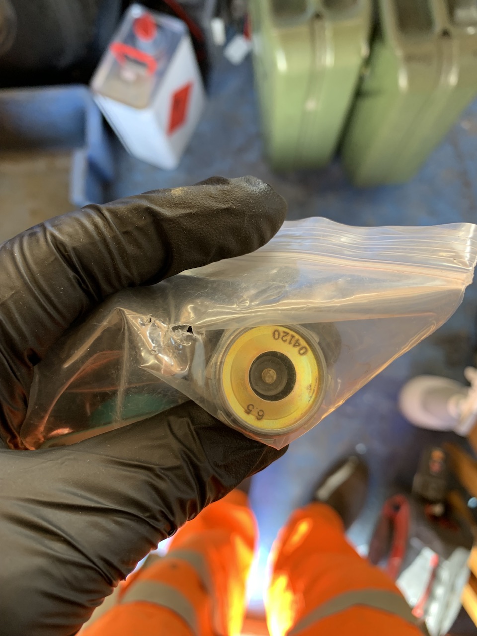

    I’ve confirmed that the new PV in there is ok but just because no one believes me I will put a different new one in when I get a chance.

    Ok, another new power valve to keep you boys happy.
    Nope, no difference, it ain’t the power valve.
