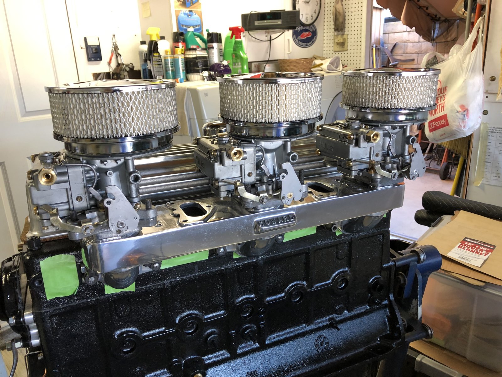

    1960 Mercury 292’s used a Holley rated at 280 cfm. They used the same or close to linkage on the throttle side. IMG_2585.jpeg
