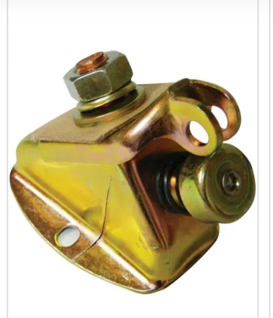

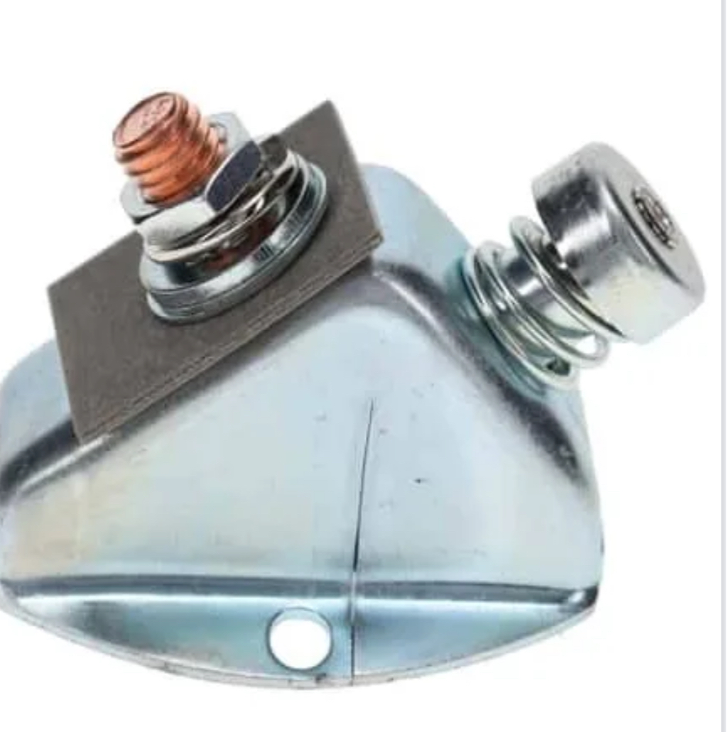

  9. Mount the OE starter switch to the floor with the end of foot pedal mounted to it
    Truckdoctor Andy likes this.

  12. anthony myrick likes this.
  13. Or an 8n ford

    Every automatic conversion kit that uses a newer transmisison ( Chevy V8 bolt pattern) uses a starter that bolts to the bottom of the adapter plate. At least everyone I have seen.
    The foot start switch like Anthony showed can be found at any farm equipment store or at the parts house or on Amazon. Flip it upside down and stick it in the hole the stomp pedal came out of and line it up and use it as a drill guide to drill two holes, Then go under the truck and hold it up in place and stick it on the two bolts you stuck in the holes and put the nuts and washers on.
    Get a piece of tubing/structural pipe with the right ID to slip over the top of the switch and cut a piece off about 1/2-3/4 inch long do some creative fabbing and welding to have a stud that fits the top off the stomp pedal and drill and tap the side of the pipe for a set screw and you have an original looking electric stomp pedal that will probably last a lot longer than you need it.
