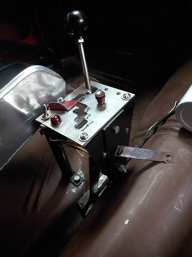

    This is a great idea. While I like both the Gennie and the Lokar as they will retain the stockish interior look. I could easily fabricate the plate, but if I did it on a smaller scale, I could simply replace the gate plate on the Gennie shifter and do both. I can put a line lock on off switch on the shifter and wire it through a toggle switch for either the line lock or the lock up for the transmission. As you don't lock the transmission on the drag strip, you switch to enable the line lock for drag, and lock up on off for the drive.
  11. squirrel
    Joined: Sep 23, 2004
    Posts: 59,180
    squirrel
    The toggle switch and light on mine are for the switch pitch torque converter...sort of like a lock up, but not really.
    The pushbutton makes the GV overdrive engage, if it's in manual 3rd gear (there's a micro switch to detect that).
    I don't have a line loc, I just do a burnout in 3rd.
    Neutral safety switch at the Park position. And spring loaded reverse lockout.
    I think I have some pics of how it works, if you're serious about making one. It's not rocket surgery, but it is close.

    Line locks may be old school, If the car works without it, I'll leave it off. I said no trans brake to the guy going through the 700r4 so no launch control. My OT car from the 70s had a manual reverse valve body in it with a factory shifter. I remember the joy and challenges of driving it in downtown traffic. It was a handful but when we were young that just made it a challenge to accept. The manual lockup works much like your GV overdrive. If it's not in OD it won't lock up. So I'll just need one switch. I appreciate the offer for pics but I have a knack for brain science and your explanation paints a pretty clear picture. I will play with some designs and see how they work with the bench seat. This could be fun.

    this is the picture I copied my design from.

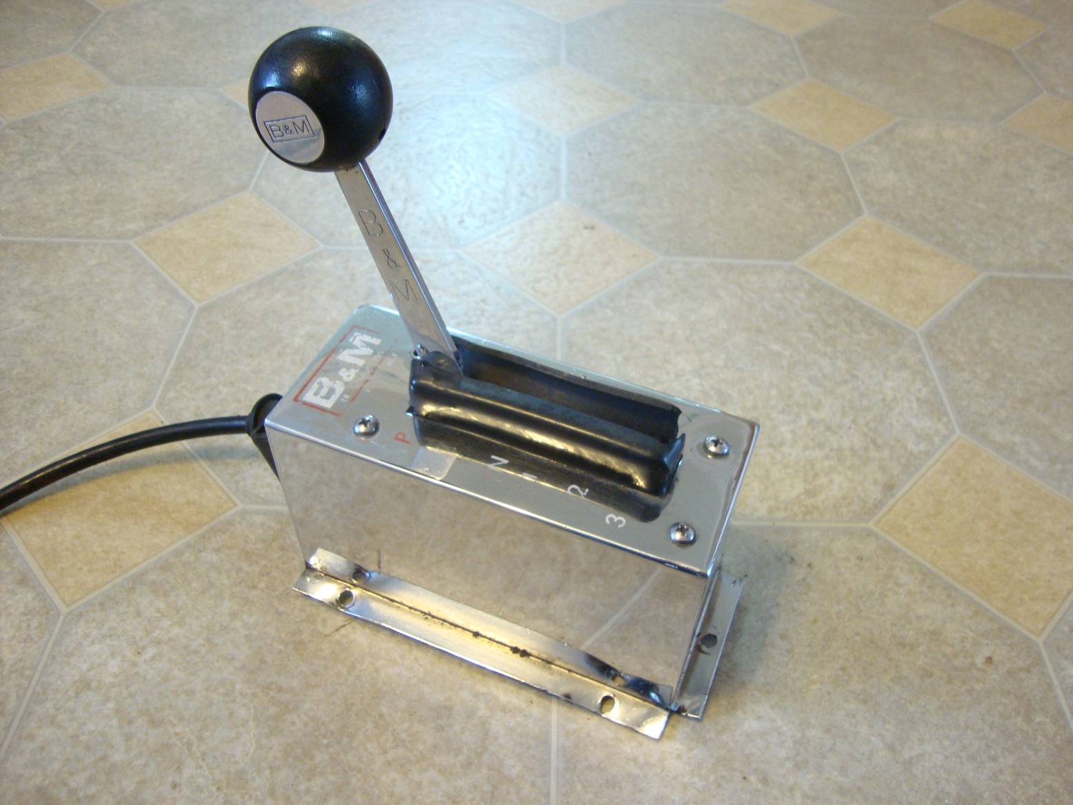

    The B&M 60 Series shifter was one of the gotta have automatic racing shifters in the 60 and 70's, I bought one new around 1977, curious how long after that they continued mfg.

    My dad has a B&M Quicksilver in one of his rides. It's fun at first, but the novelty wears off. It has a pull-up push-down gate system to get out of park and reverse, then it has a ratchet system for the forward gears.
    There's a reason Lokar and Gennie style shifters are popular in hot rods, their ease of use (and looks). The ratchet shifters get old quick.
