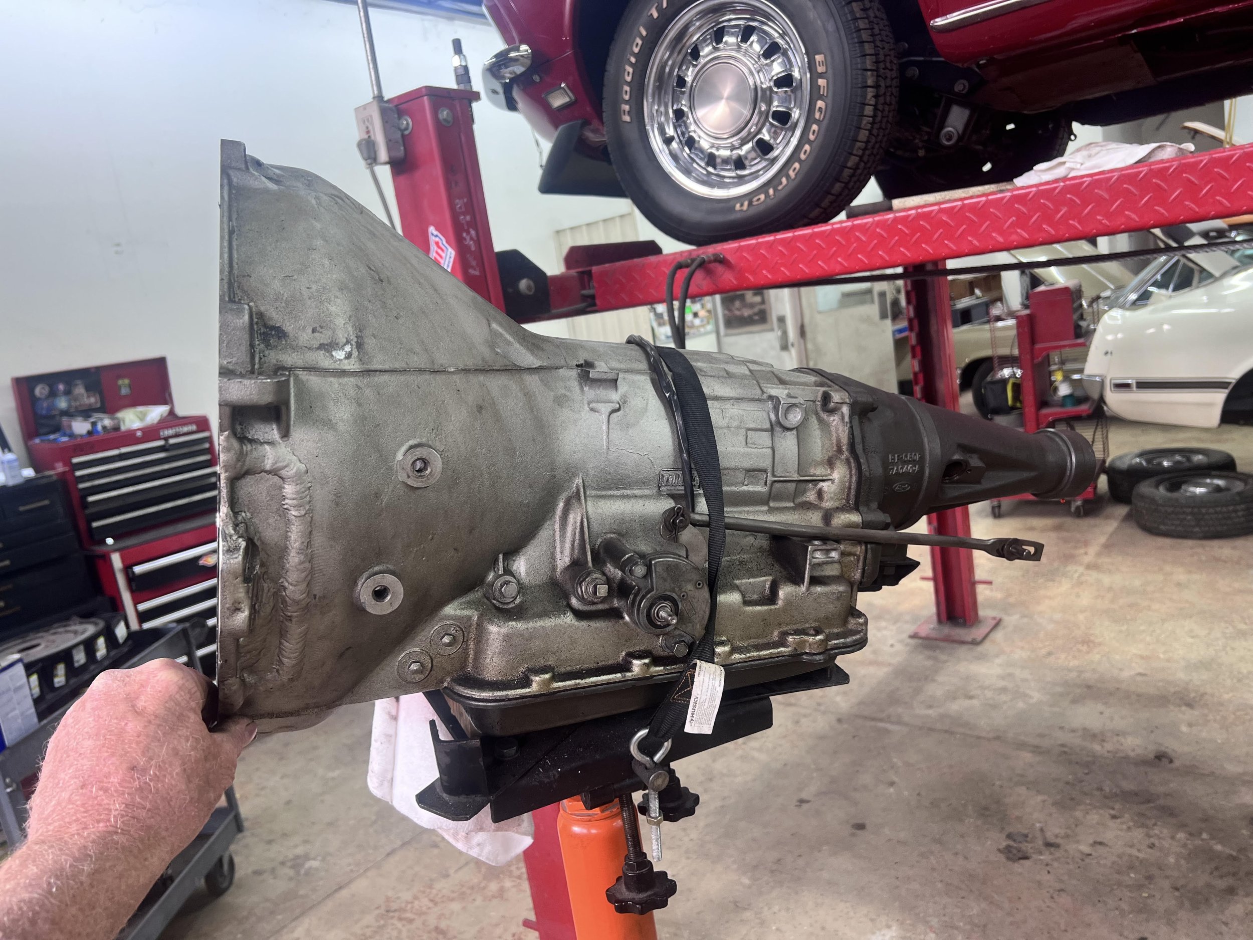

    Have a 1969 Mustang 428 CJ, C6 PGB-Af1 automatic transmission. The case is damaged and needs replacing. Unable to find the correct transmission or a case. What other C6 transmission is compatible? Engine, Felxplate, starter and shifter linkage

    The case is a case . I really don’t think welded case is junk .sand work down the weld gl*** bead it , call it done for me

    You have a proper C6 CJ trans with the cast iron tail housing. You should be able to use any FE C6 case with all of your guts transfered over. There could be some small casting differences but should be OK. Biggest loss would be your vin number right there on top of the case in front of the tail housing.

    Shouldn’t be too hard to find a core C6. Be sure to keep the r-code servo, the governor, cast iron tail shaft housing. Looks like a pretty good repair, whoever did it.

    I don't know, however, if I trans-1.jpg lay a straight edge across the bellhousing in the repaired area, there is a 1/8 difference

    I would find something more rigid and dead flat and then check for straightness. Those mid-plates tend to warp a bit, at least the couple spares I have for 429-460’s.

    The problem I have with that repair is the dowel pin. Was the piece welded back in the right place, not pulling the trans off center. As for the gap, it's wrong and probably pulled when welded. Should of kept it bolted to a block for welding. Anyway I would try building up that gap with some aluminum expoy, carefully sand it back down to a flat surface, that is if you feel the dowel pin is in the right place.
