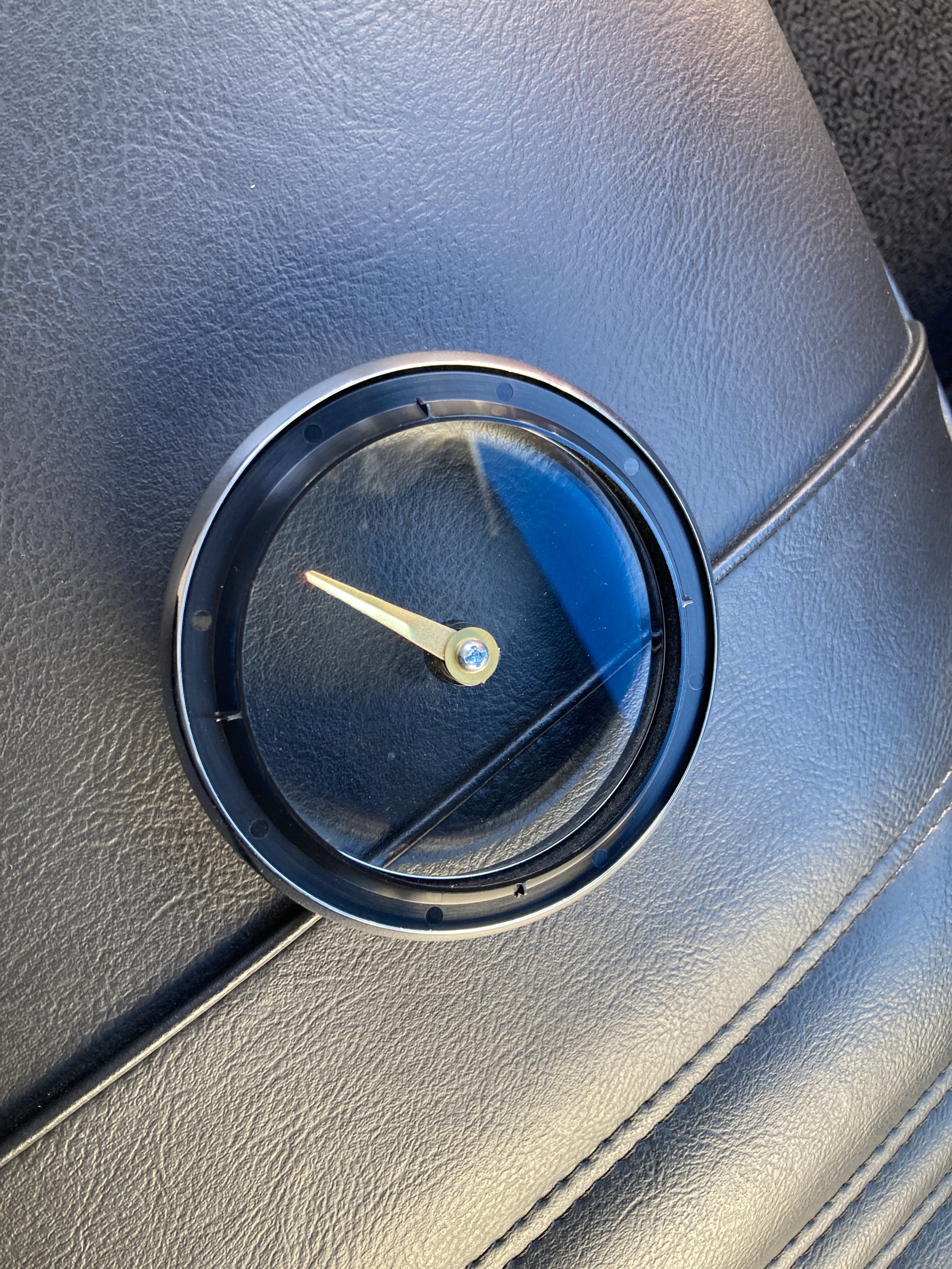

    Anyone ever have the bezel and gl*** lenses fall off a tach ? I went on a 290 mile cruise yesterday, got up early to clean the wagon, when I went to wipe off the tach the bezel and lenses falls in my lap. I will be calling AutoMeter in the morning as it being a Sunday would be pointless. The tach still works just fine and attempts to reattach it were not successful. Just wondering if anyone else has had this happen and if there is a home brewed fix for it. Thanks !!! IMG_3997.JPG IMG_3999.JPG IMG_4001.JPG

    is the crimp just a bit too loose to hold it?

    That would be my guess and a manufacturing flaw. Going to bend up a couple small flat 90 degree pullers and see if I can persuade it back into place as getting to the wiring to pull the unit out will be a pain.

    That would be a good plan if I can get the crimped area back over the housing, so far no luck and yet it came off !

    I wonder if heating it a bit might expand it enough to get it back on? Would definitely have to be careful with the gl***.

    Test to see if you can walk back on ,
    If So then see if you can easy remove,
    If So afew little dab of clear silicone or few dabs of superglue Re install ...
    I would start @ top try walking as move closer to bottom on both sides .waybe help with using .003 feeler gauge .

    Weird been on the car for 4 years with no issues, still trying to get back on without damaging it any, in case of a possible replacement from AutoMeter. *It is a no go without doing damage to it. I took the gl*** and plastic insulator out and just tried to see how the bezel would fit on the housing and it's not even close and can't even get it started. My guess is it was not "seated" on the whole way from the factory and stayed in place half ****ed until now. Guess I didn't inspect it enough when I bought it... Will see what a phone call comes up with tomorrow.

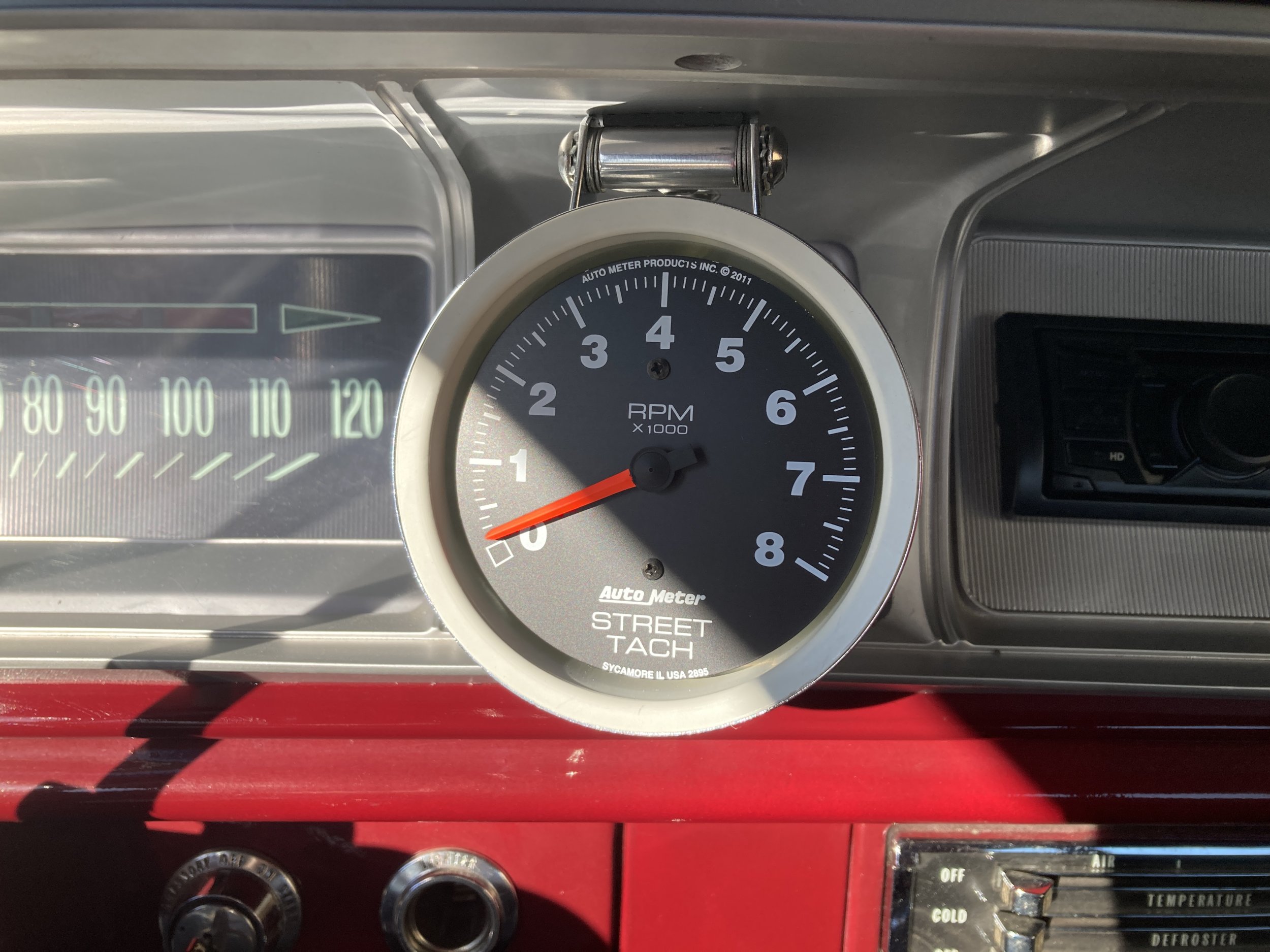

    Well it was a one week turn around and and things are back in one piece. Turns out the bezel ****s up to the flare on the can, so no clue how it's secured, maybe just snaps in place ? A little epoxy will be added to the seam for insurance for the future. Back to my regularly scheduled programming now. IMG_4023.JPG

    You redlined it!! Joking aside yeah glue is probably the method they used...the more you add the more solid the effect and seal. You could glue on 4 to six points and use a clear caulk around the cir***ference and wipe the excess making it possible to remove again easier if you have too.
