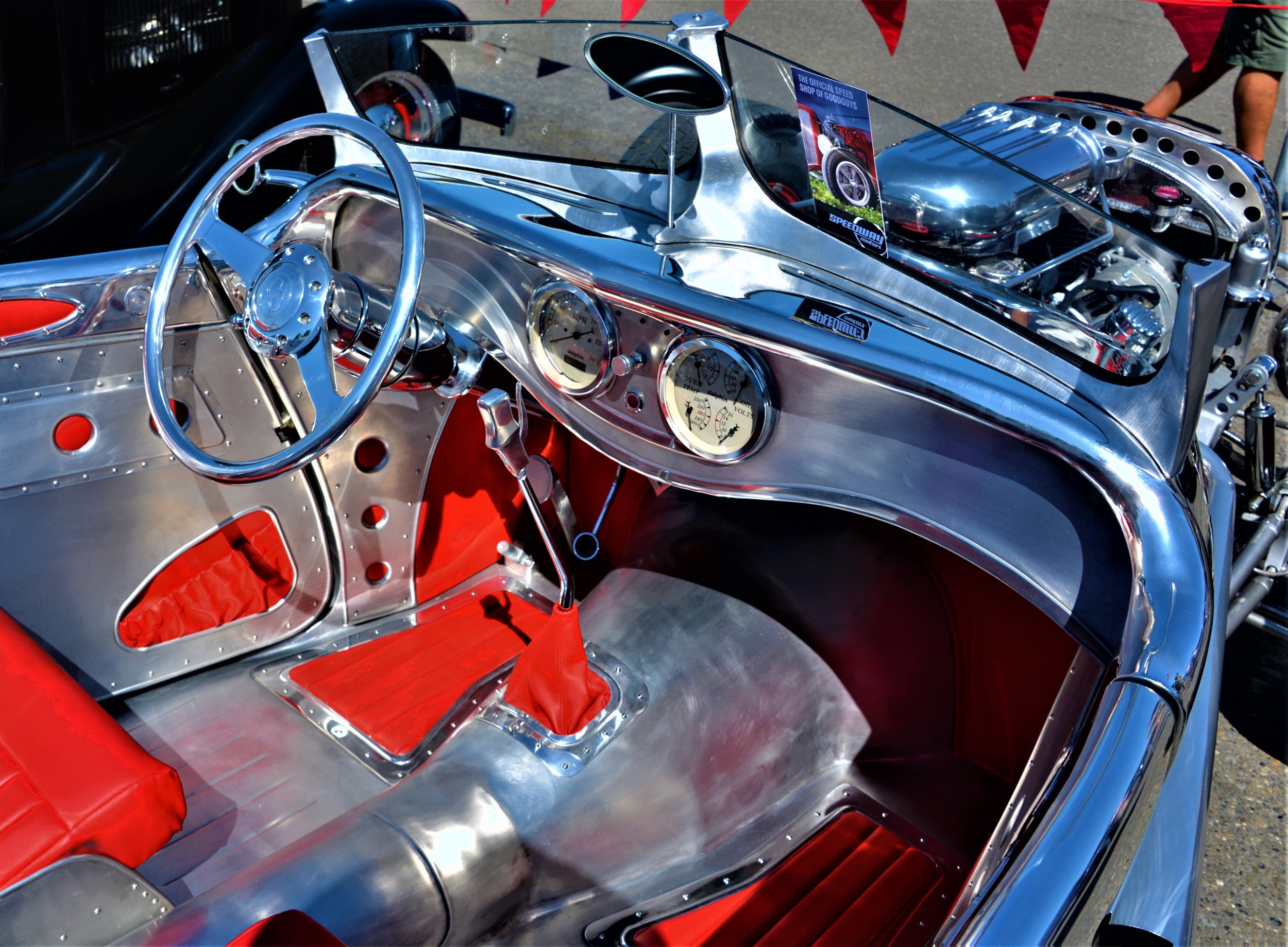

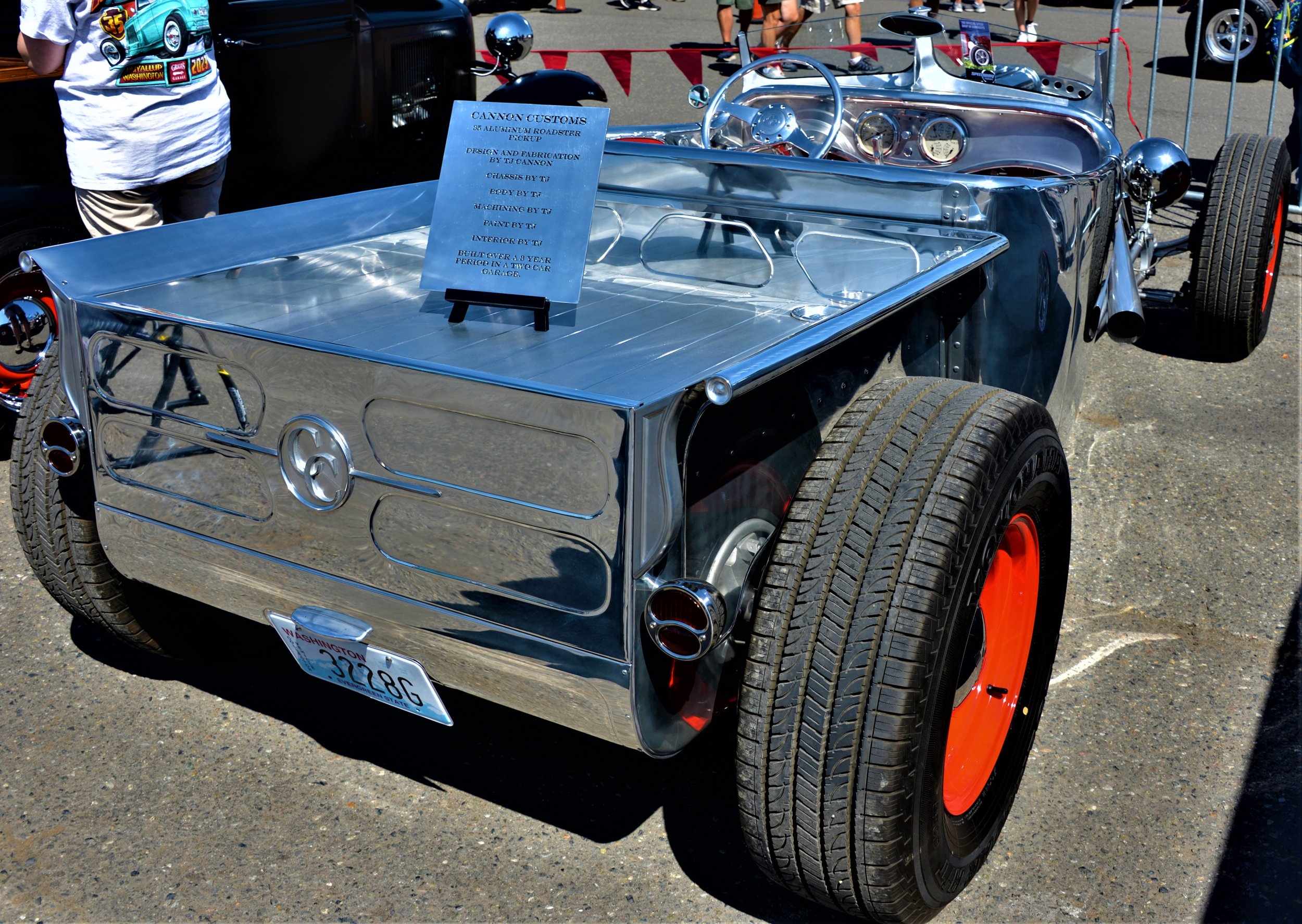

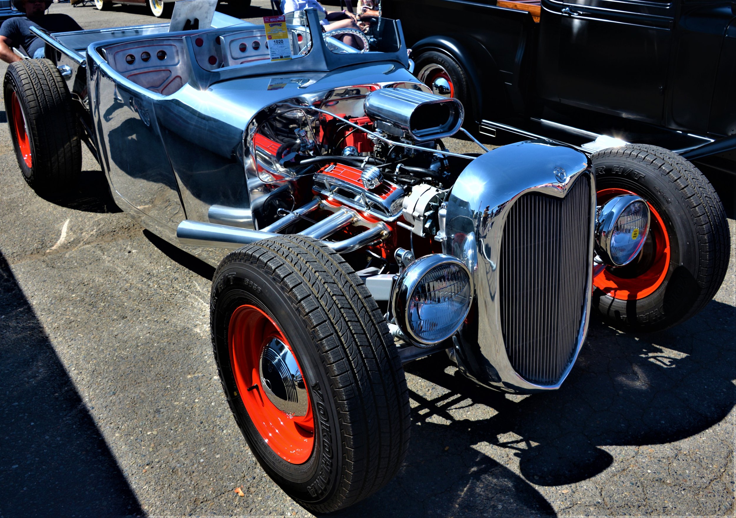

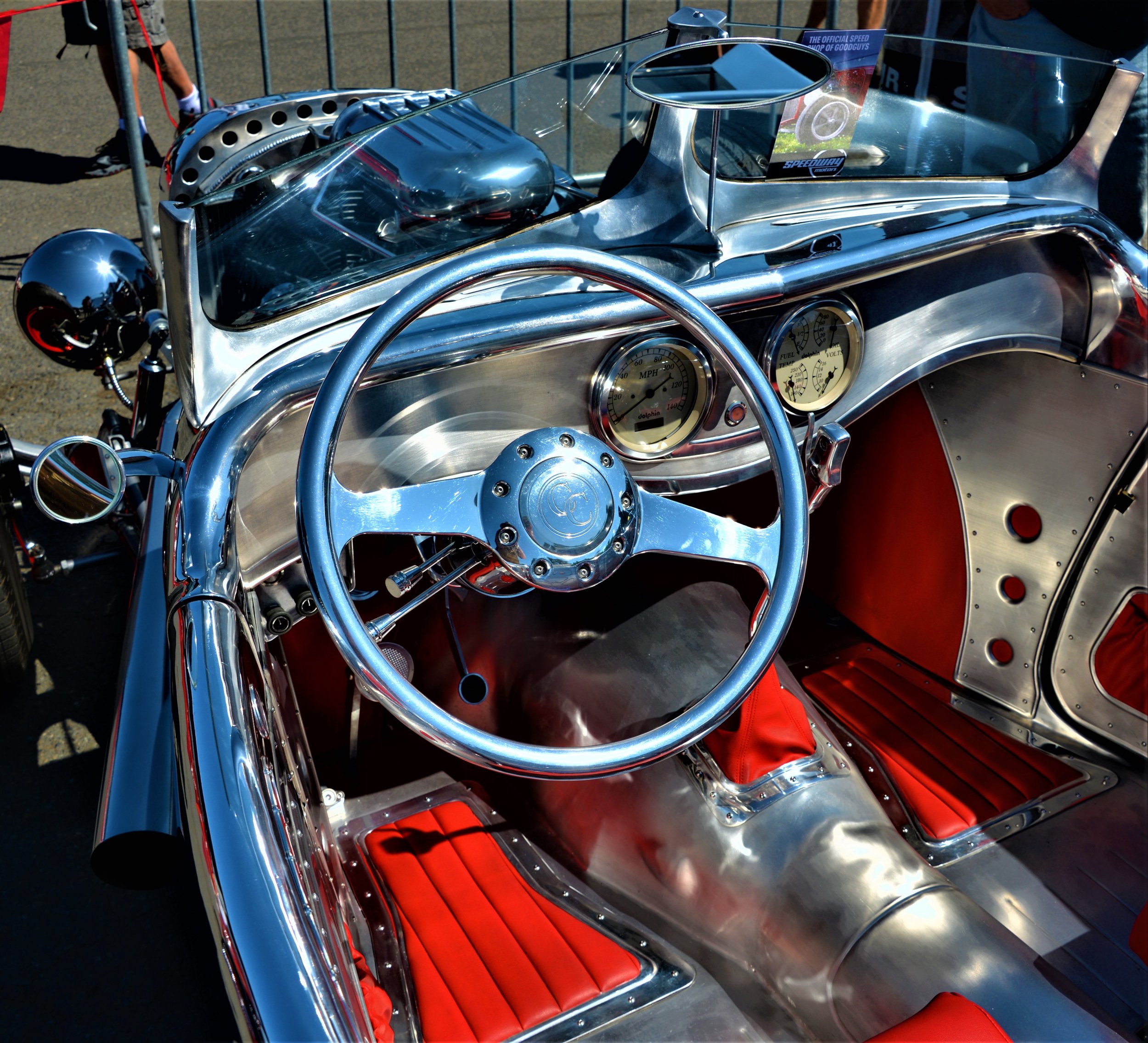

    This is a true bare metal, polished metal example, pretty slick, have to wear sunglasses on a bright day!
    GuyW, swade41 and rod1 like this.
