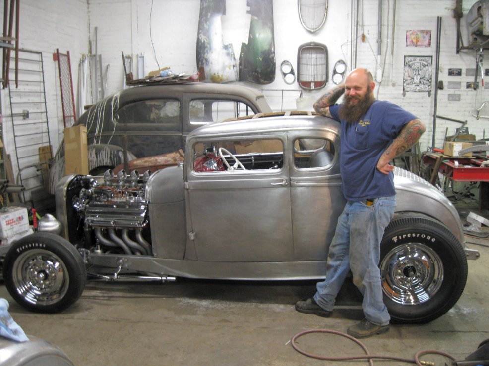

    There is a guy on Youtube that has a technique that might work for you.
    He basically takes a cloth with semi-dried metallic silver paint and rubs it over dry black paint. It has the right sort of tones so might have potential with more refinement.

    If I was to try something like this I would paint with the finest silver base coat I could find then tint with black to kill some of the brightness. About five coats then let it dry out for five days or so. Then start scuffing with 3M scuff pads of different, grit?. Then go over the car like you would cleaning the metal maybe scuffing in different directions around difficult areas.
    Then coat it with a clear urethane, flat, shiny whatever.
    You’ll probably want to use test panels to get the color you want, make sure you clear coat them because clear coats can change the silver color.

    This paint over a brownish primer coat. After plenty of drying time, a fine Scotchbrite light scrub! It’s metallic, but, what I would call a shitty metallic, so it doesn’t look very metallic…sort of dull, not shiny…like a chain link fence.
