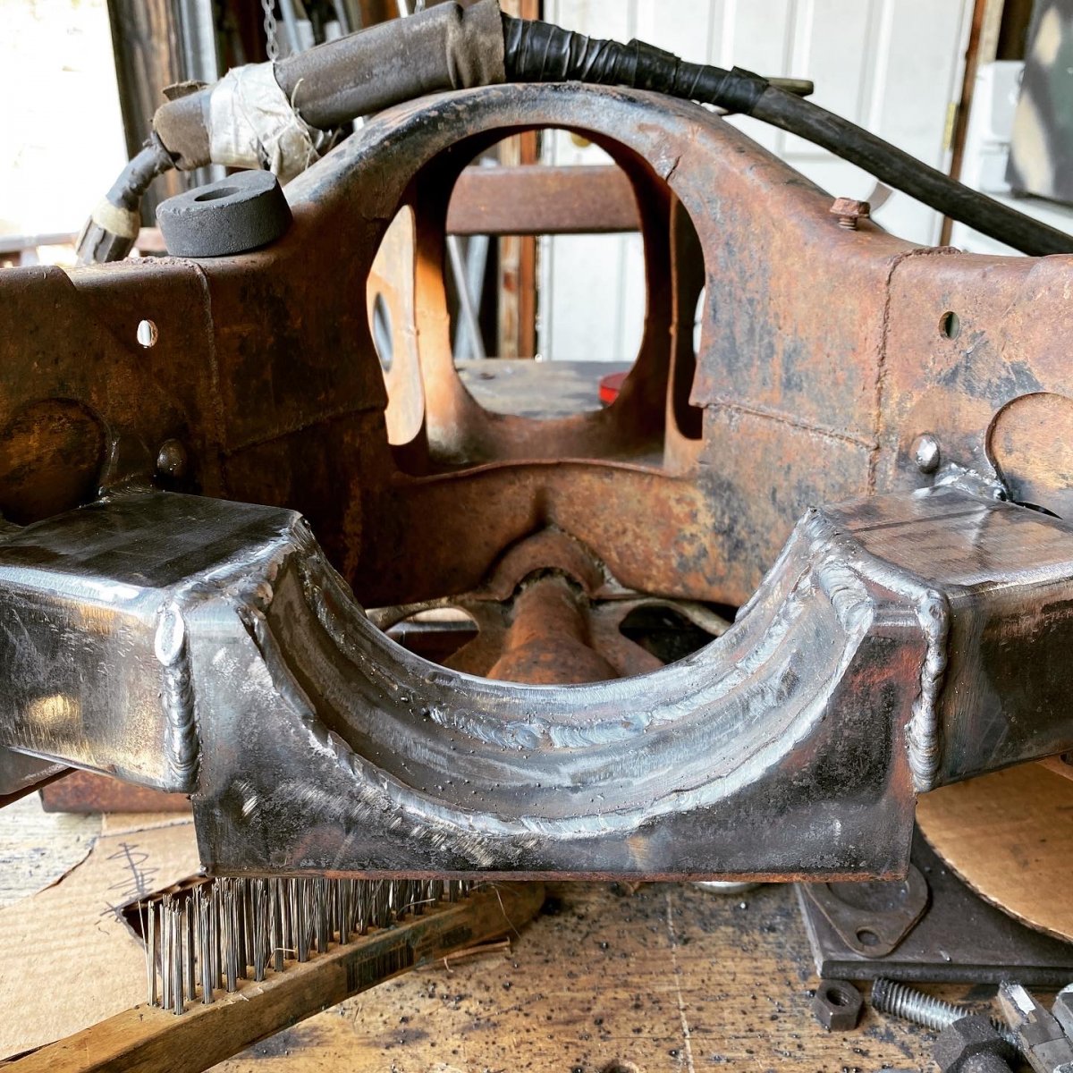

    I had to obviously fix this trans mount in the X-Member. I had to build up a few pieces of square tubing like a puzzle to make it work. I will drill new holes when I know where the trans sits. FDDD7DEF-445B-40DD-880B-2ACD86BF9AF0.JPG 7337C106-D587-40A5-8995-AF8A6BC4727E.JPG

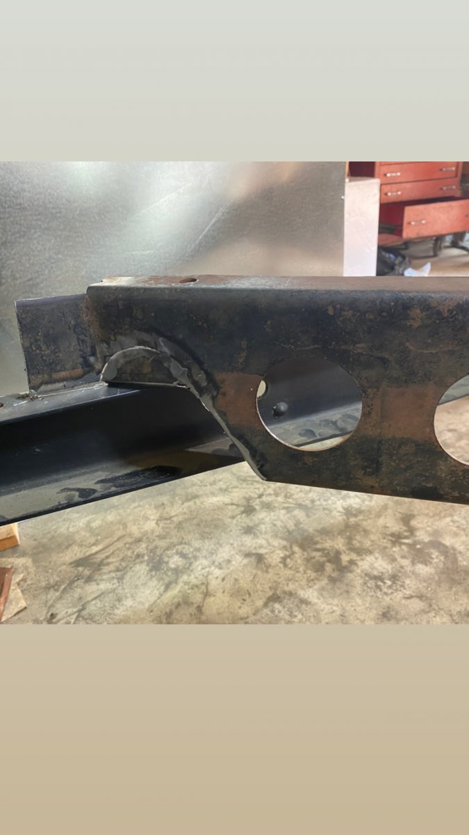

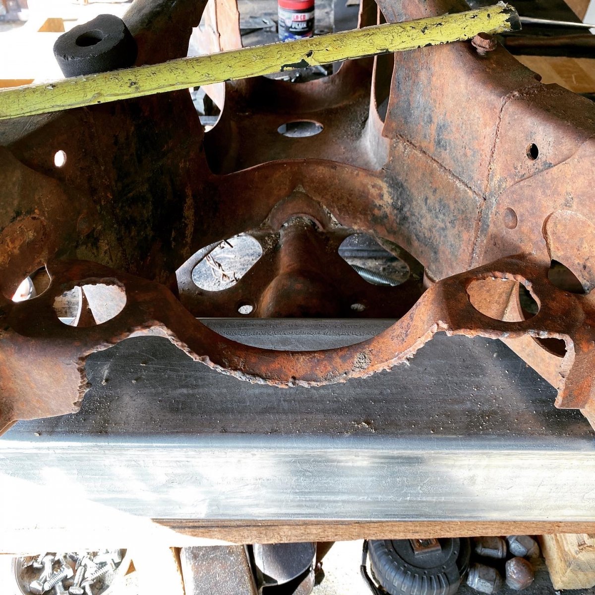

    been doing some X member work as well as pulled off the body from the frame. made the 2 ends at the rear of the x member thinner to fit into the frame. I took out about 2in. IMG_6721.JPG
    Engine is sitting at zero for now... just seeing where it was at.
    I cut out the rear of the front cross member for a better engine fit... pulley was needing more space. IMG_6685.JPG
    I also had to fill in one hole that was where the member was thinned out. I took this photo before the final welding was done. E913EDB3-C7A4-403A-9242-DFF8C8754D6C.JPG I

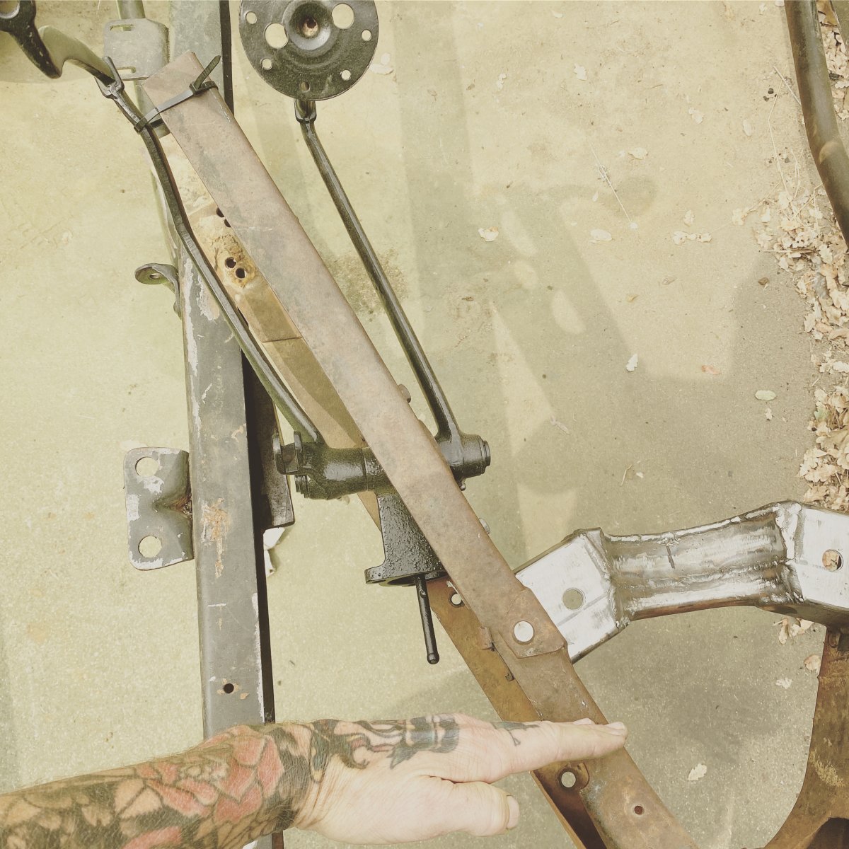

    back at it... I need some options on the pedals and x-member to frame connection.
    Photos would be amazing if you have some. thanks.
    1- The pedals need to be heated and bent to the right so they clear the frame. This will tell me where the x-member should tie into the frame.
    2- I was told that the pedals will be too far back if mounted in the stock spot they're in here in the photo.
    3- What are my options for the pedal side of the x-member (where my arm is in the photo) connecting to the frame? I am sure there are a few different ways due to the first two questions here.

    I put a 39 X member in my 29 frame. I just looked and the front lower mounting bolt for the 39 pedal ***embly is straight across from the front hole of the body mount tab. I think you are pretty close. You can see what I did here.
    13clicks, Tim, waxhead and 1 other person like this.

    Another thought. You could mount your radiator, mount your motor and trans, then line up you trans mount. Then you would have the right position.

    I found it. Thanks. The exact photos I needed.
