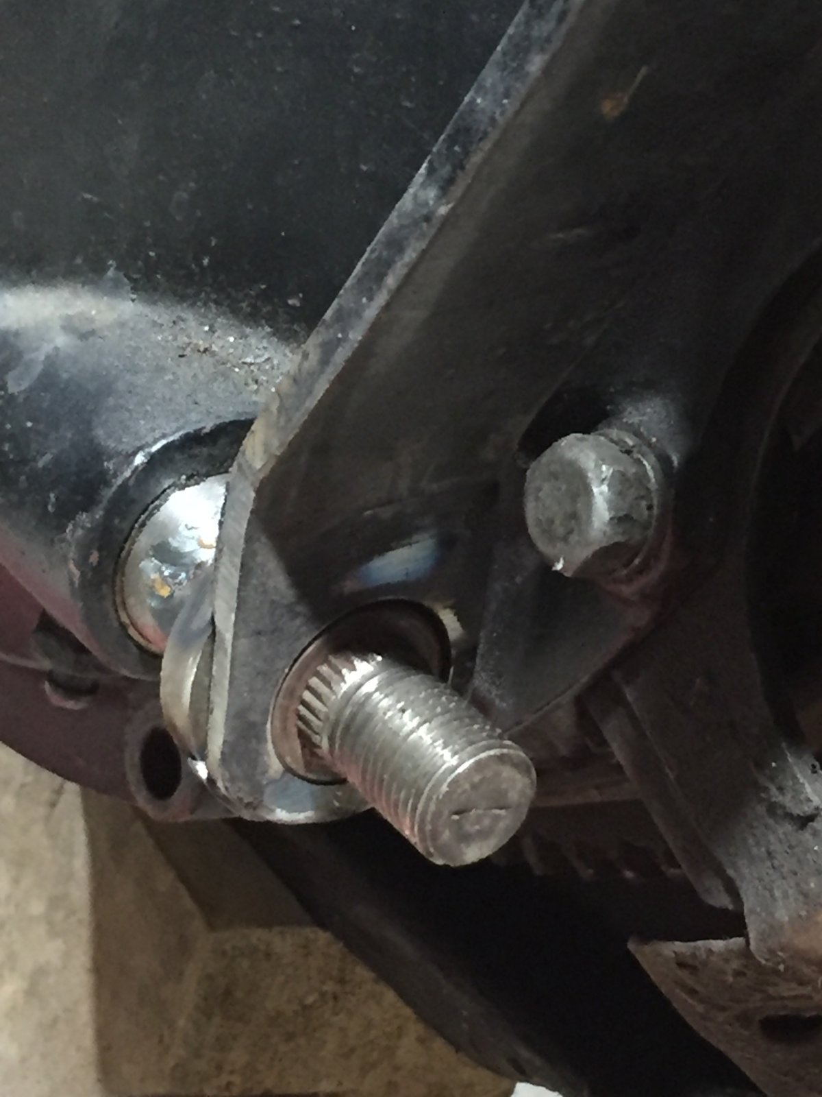

    Looking for a little direction before buying parts and appreciate the knowledge here. Got a 36 trans with 39 internals mounting to F1 crossmember and F1 pedal set. My clutch shaft was cutoff, so I need to replace. Any insight into connecting 36 shaft to F1 pedals? Can I connect F1 equalizer shaft to 36 clutch shaft? Helllp!!
    I used a '40 shaft thru the trans for the throw out, a '40 jackshaft and F1 pedals and crossmember. You need to shorten the jackshaft and make a mount off the frame for the pivot ball.

    This is what I’m thinking. Since I need to replace the clutch shaft, is it possible to install an F1 shaft in the 36 trans? Then the physics stay true to F1 design I’m hoping…?

    Yes it fits right in there.

    Nice work, 1935ply
