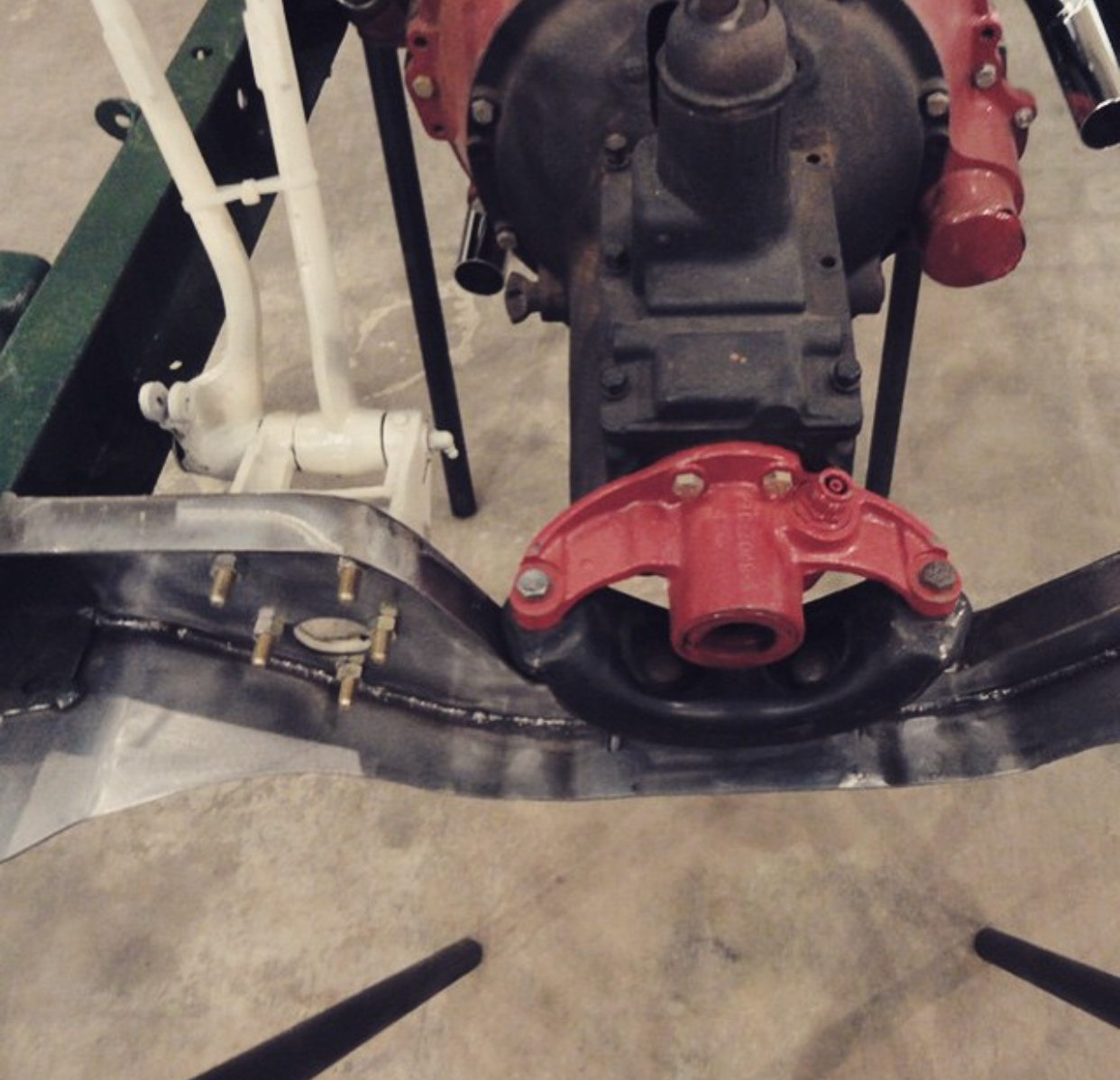

    It's quite easy to fabricate an F1 style cross member.
    Not mine but a pic I saved for future reference.

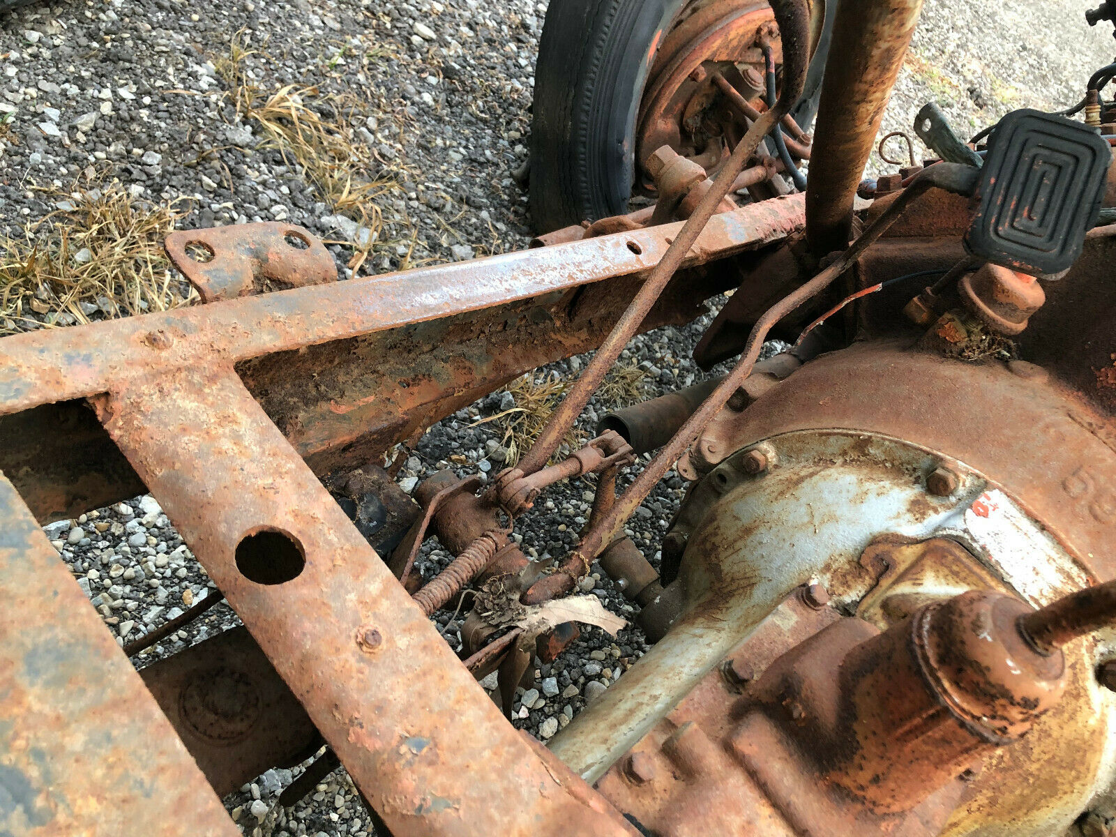

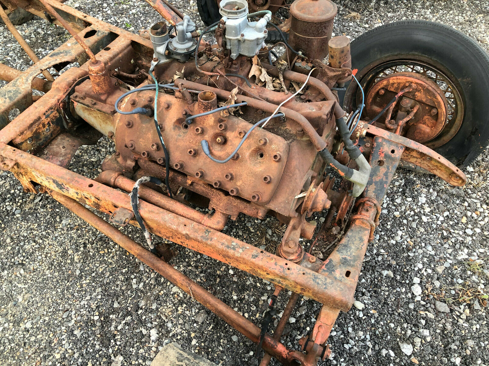

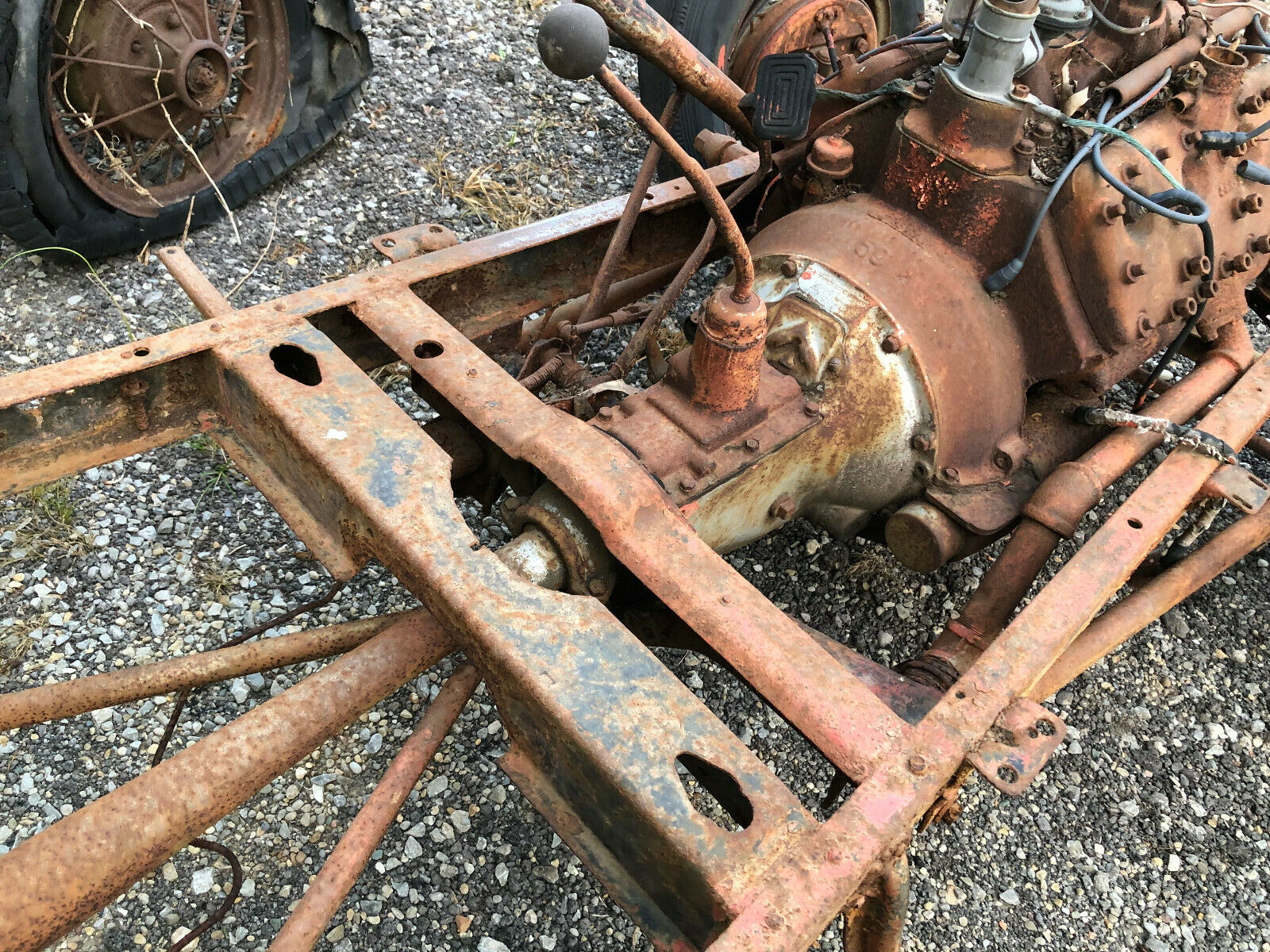

  6. Saw this on evil pay, but sold now. There are two threads going on this topic, so I'll post these here too. Enjoy.
  7. "Same thing I posted in the other thread." I bought an F1 ch***is for $300 scoring the crossmember, pedals, 9" ford rear end someone had put in, and the front beam and springs to build a small camper later with. Deals are out there, but not readily available. Both the F1 crossmember and the 32' K-member will require alot of fabrication to work. They do not just bolt in. If you do not want the cost of buying a parts truck or 32' Ford parts, you could fab your own crossmember utilizing what ever rear bearing retainer you have on your transmission and steel stock. All options require fabrication and trial and error. There is no template or off the shelf part to put a flatty in an "A" except for Salt City's K-member witch is similar to Tardels out of stock K-member. I ***ume your "toploader" is an early 3 speed and not a later toploader 3 or 4 speed. The later toploaders would not work with an F1 or 32' crossmember. If a budget is the restraint, mock the flatty in the ch***is with your engine hoist and wood blocks or whatnot and start cutting cardboard until your happy with the results. Transfer patterns over to steel and fab up your brackets.
