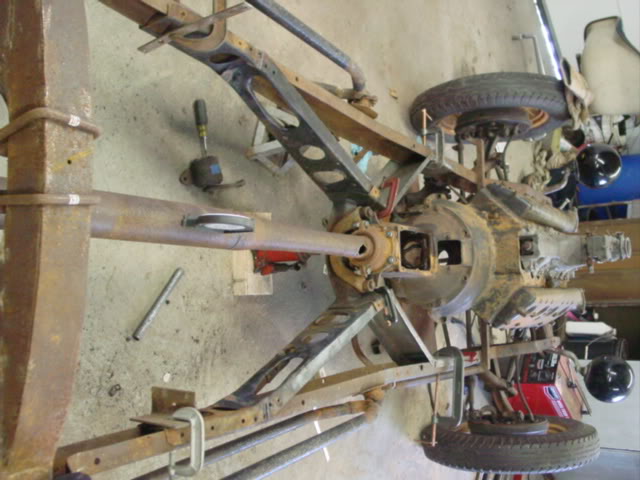

    I have seen '35-'40 type x-members used in Model "A" frames before, and that looked like allot of work. The '46 type that you have is quite a bit deeper through X-member rails, about the only thing you can do is slide beneeth the car and start measuring.
  5. It can be done, I've started a thread on it awhile ago. There are some pictures on it. They are very deep and will require lots of cutting to make fit in a A frame.
    If you want a x member the 33-34 are the best and the 35-40 work okay too.

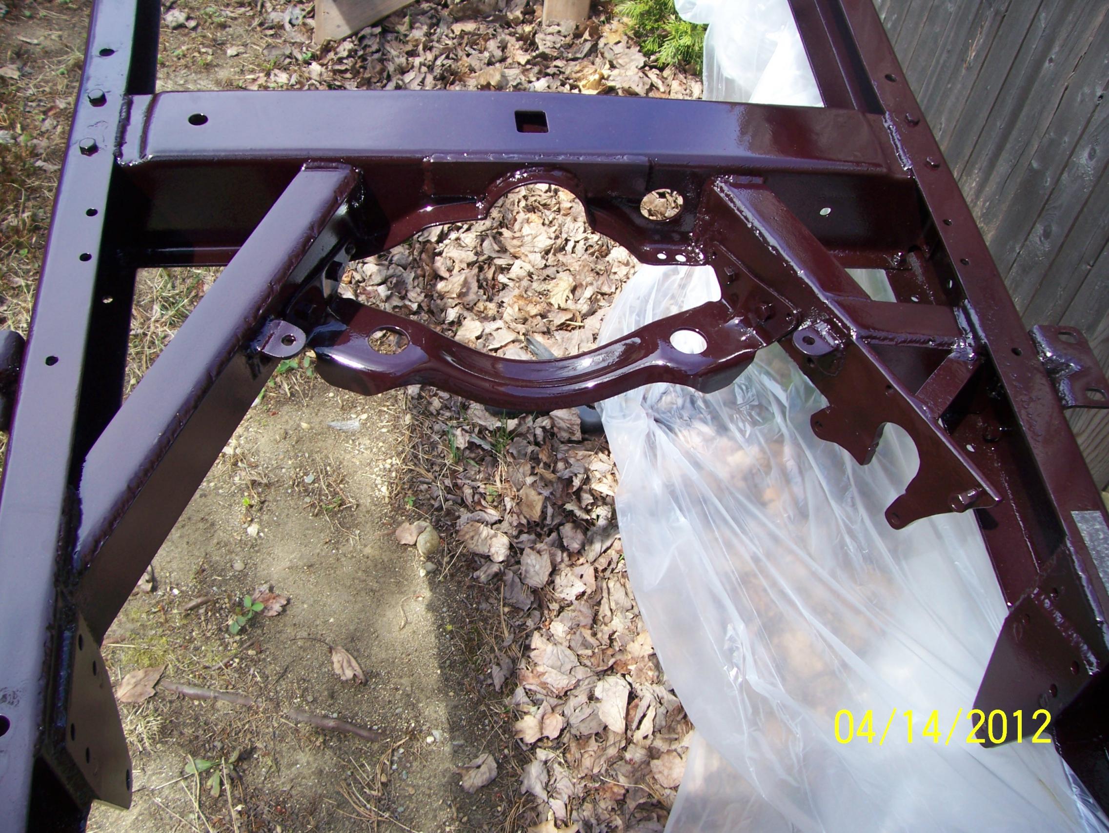

    I built a complete X member for my AV8. I will try and get some pics up.... PM me if I for get (im at work and the pics are at home on my computer).

  11. fiveohnick2932
    Joined: Mar 29, 2006
    Posts: 916
    fiveohnick2932
    from Napa, Ca.
    Here is one. I couldn't find the CD the rest of them are on.
