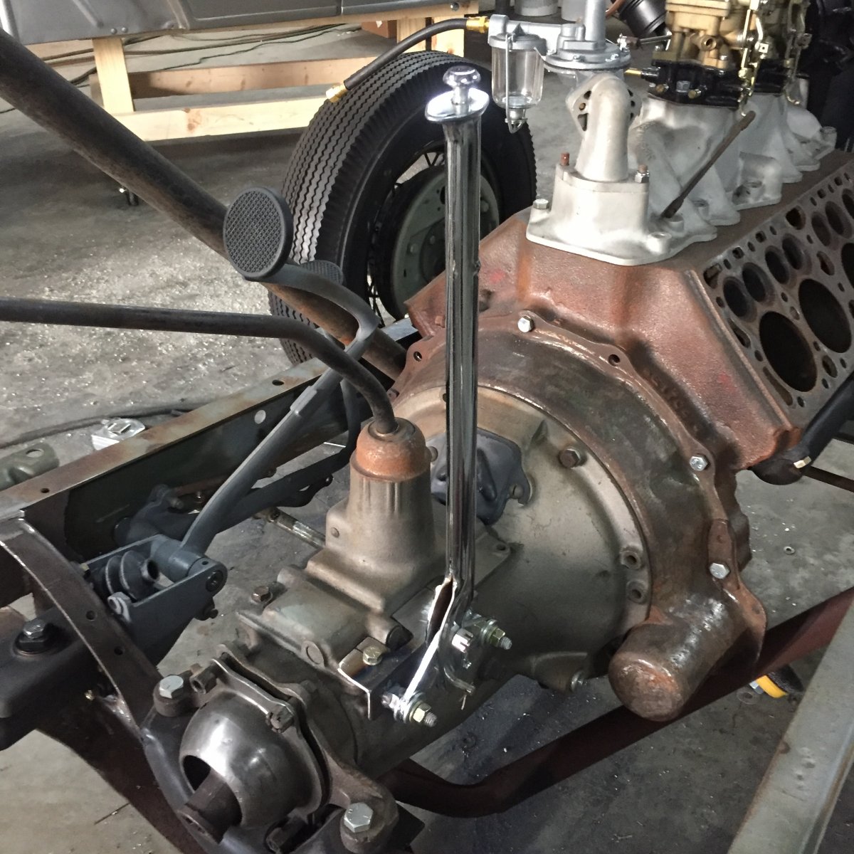

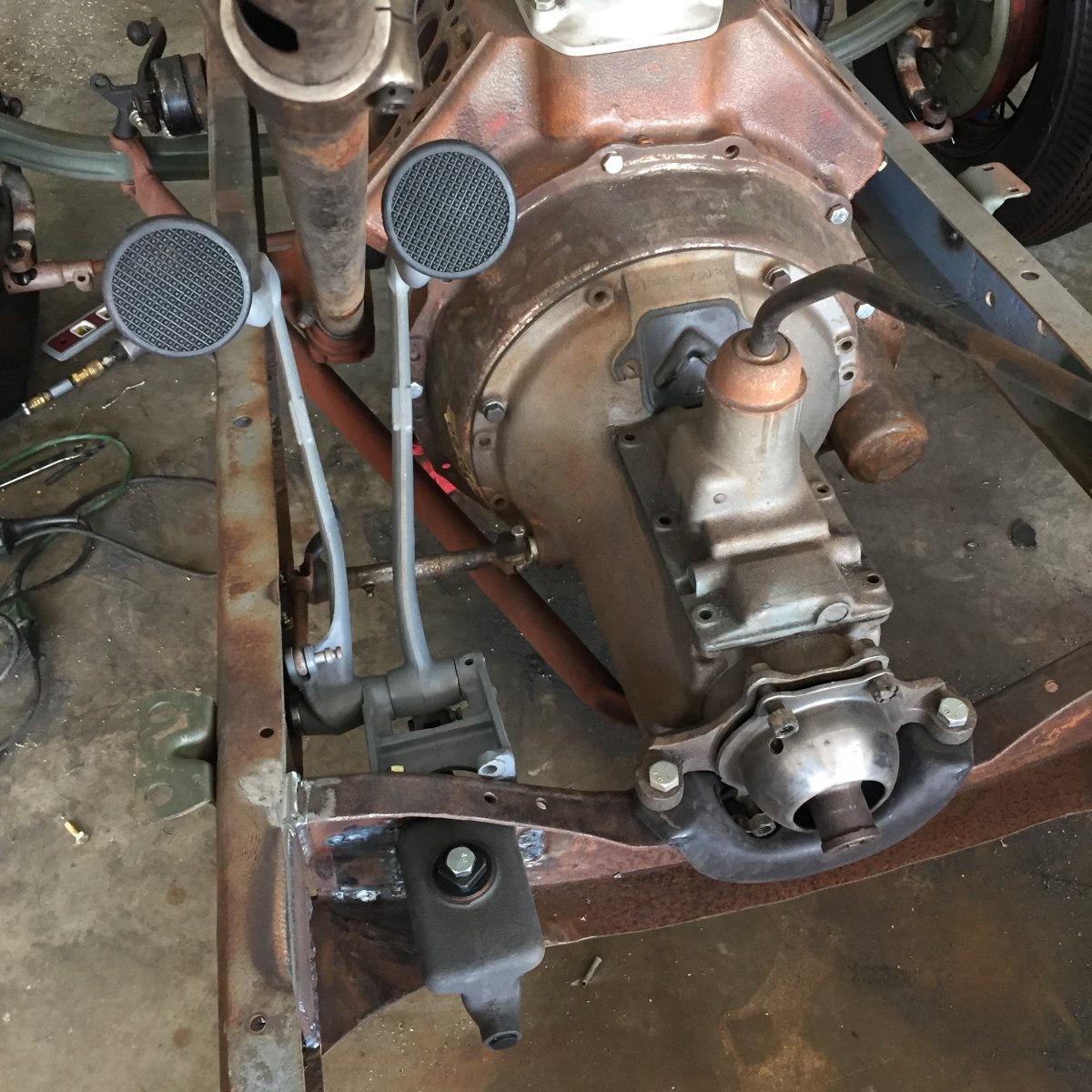

    No there are two more parts involved , a ball that matches the cup on the torquetube and the universal, its only about 3/16 of an inch by time its ***embled.
    This pic from Lodadyo's AV8 build here on the HAMB shows the inner ball and UJ, also the narrowed and fitted F1 Xmember and pedals
    I may be wrong but I think you will not fit the V8 and three speed in there with the A rear axle in the right place and the torquetube stock length.
    I think the wheels will be too far back or the motor too far
    forward. So the driveshaft and torquetube will need to be shortened!
    Also if the input shaft on your other gearbox is too big for the clutch plate , I think it will be a big truck 4 speed , no use in a hotrod... it's a crash box and the gearing is all wrong.
