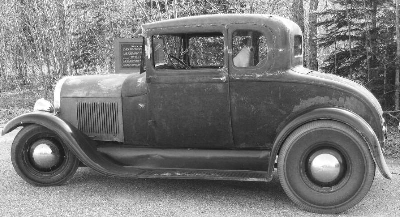

    40 ford rear is exactly one inch wider than model a.not a big deal,tires fit under fenders no problem,46/48 is wider yet by 3 inch I think! Model a 55.5 ,40= 56.5,46/48=60"
    7.50/16 fit like this on 5" rim,40 rear.
