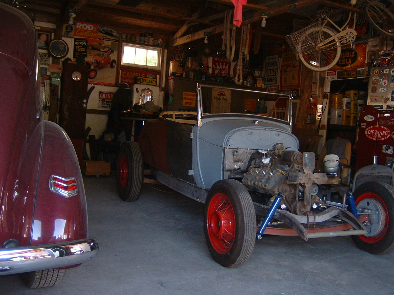

    A couple of pictures of my 28 roadster. All gennie Ford. Nothing newer then 1948.

    Started with a roadster body with the quarters cut out to the belt line and a original deuce frame all for $400. The quarters are Brookville, only after market peices. That was 10 yrs ago. Been collecting gennie stuff since. Love the hunt.

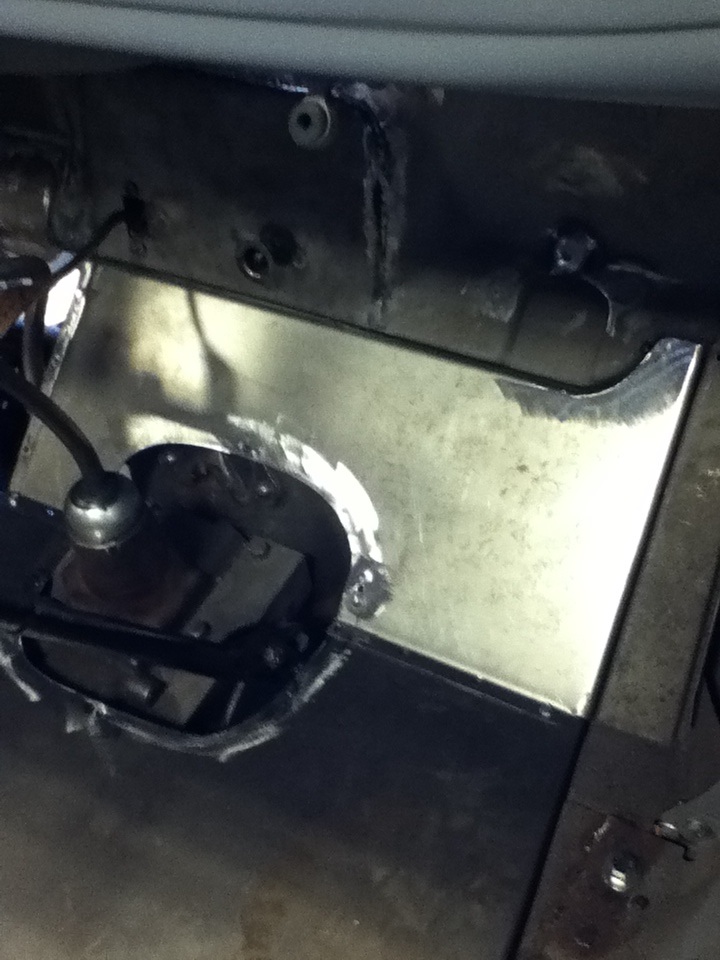

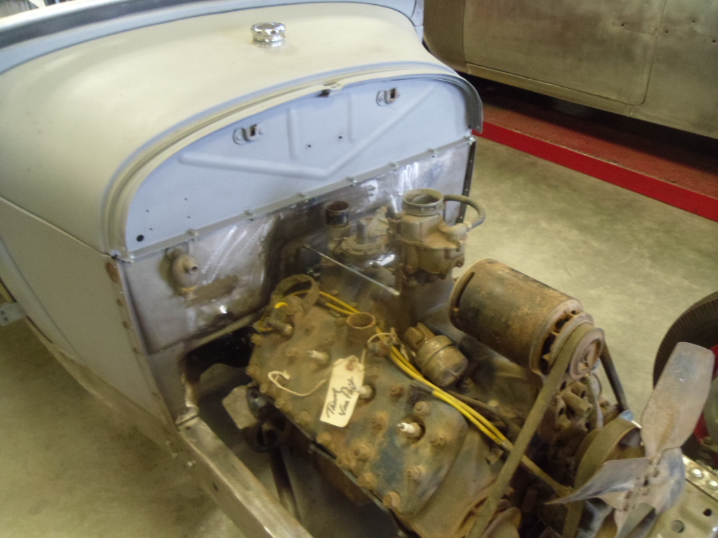

    I worked on this car for awhile while it was at the shop I work at. I did the firewall in this car. Thom wanted a spoon gas pedal. What I did was used a piece out of a '34 firewall where the pedal mounts and moved everything around to fit it. There is no metal in that firewall newer than '34
    Stogy and kidcampbell71 like this.

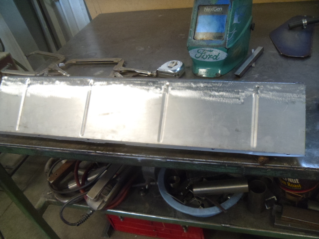

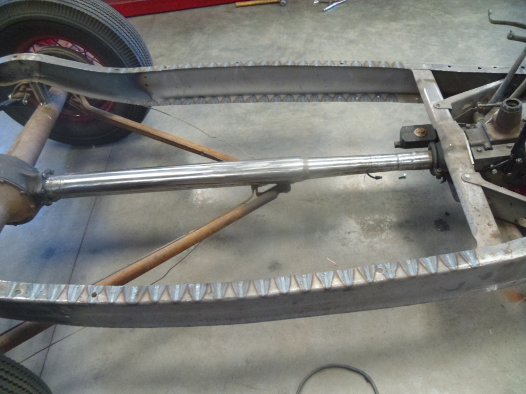

    The first pic I was finishing folding the bottom of the quarters over the subrails I just thought it was a cool pic. When I started working on the car the frame was already pinched but it did not fit the body properly or I guess the way we wanted it to. So I cut the top and bottom of both frame rails every 2 inches and pushed them around to where they belonged and welded it back up

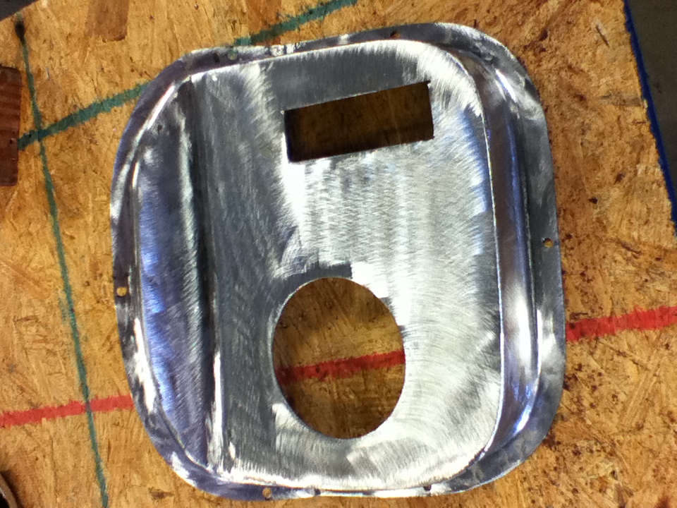

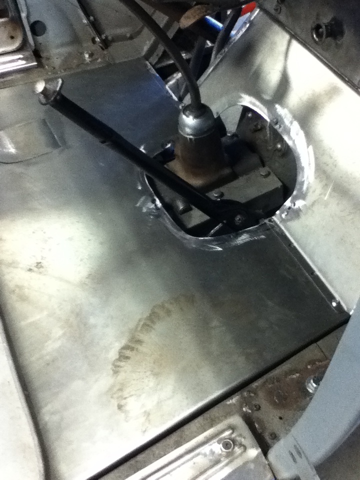

    I made this tranny hump for it too
    Stogy likes this.

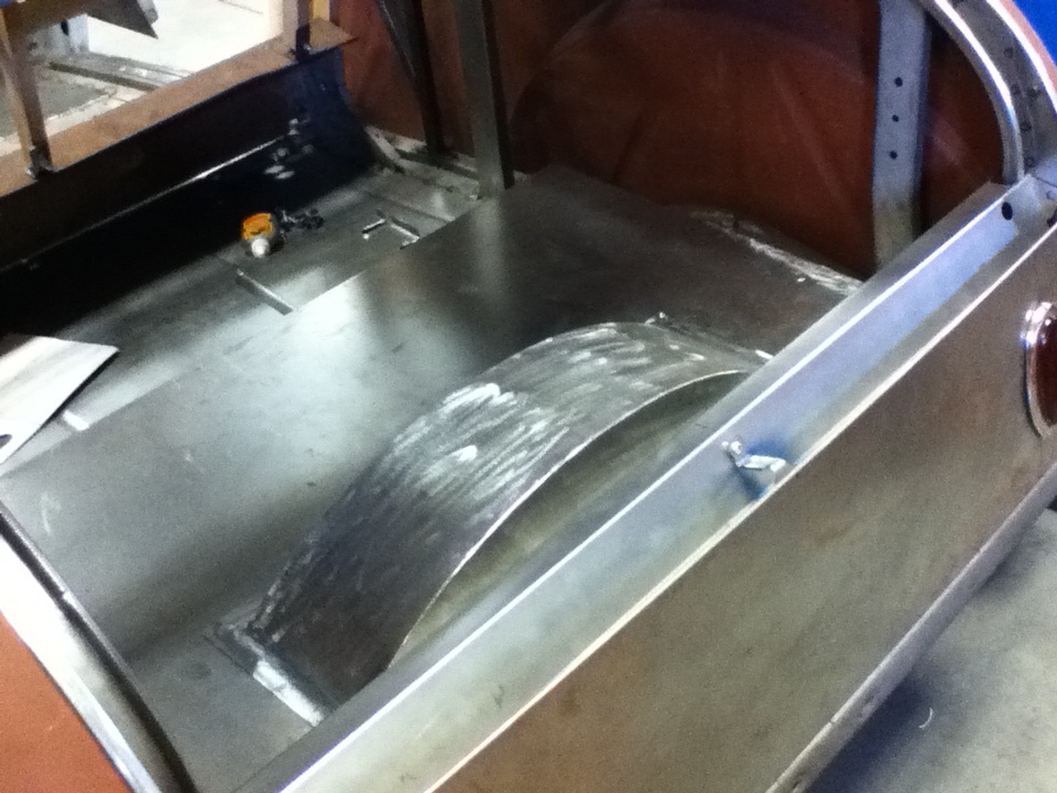

    I made new subrails in the back to fit the deuce frame. I also made the piece to cover the A spring. I cut the '39 tail lights in too

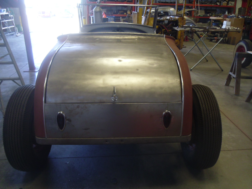

    here it is the day it left our shop. I hope Thom brings it back soon. It is one of my favorite cars to work on and one of my favorite customers to work for
