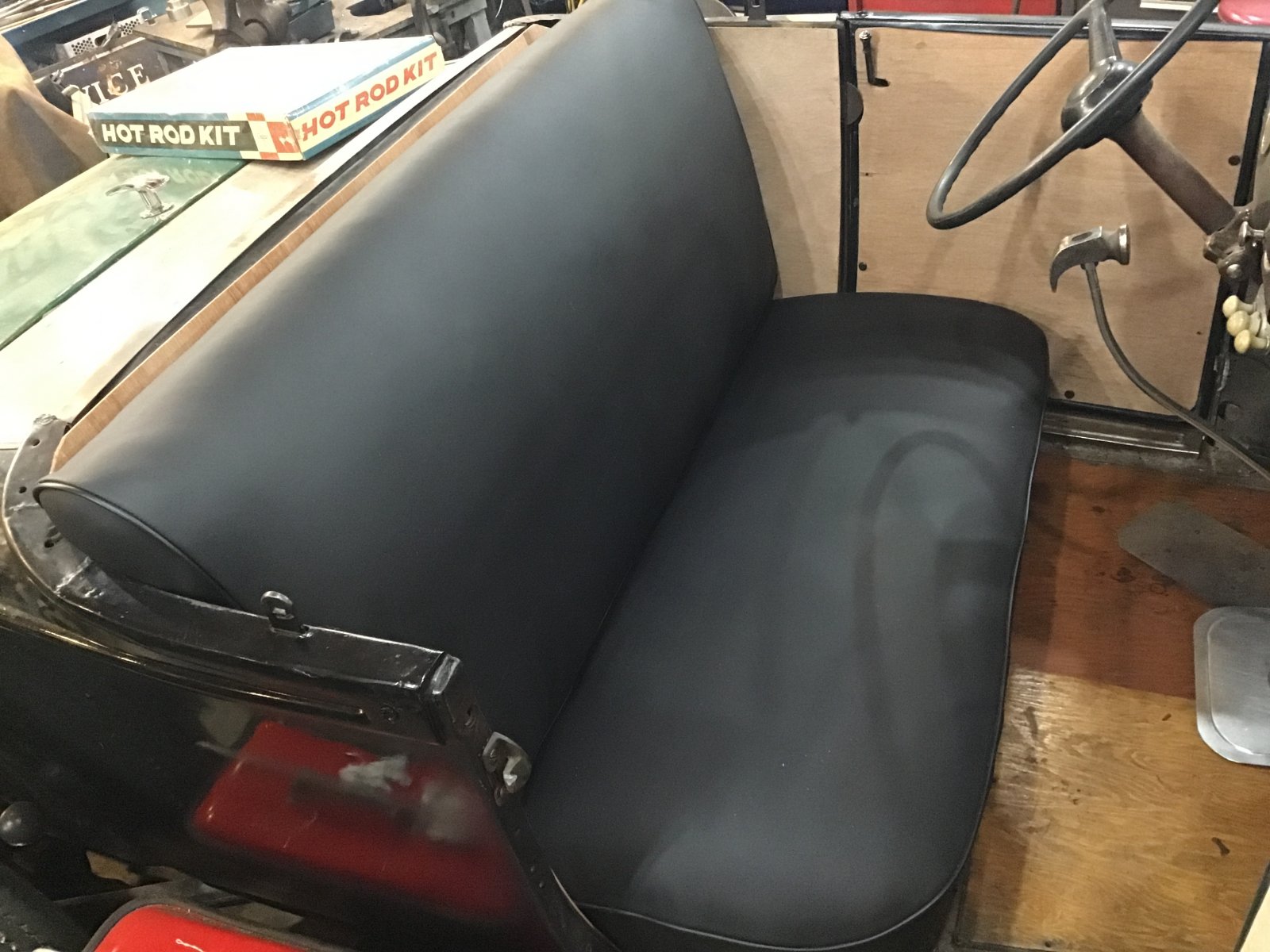

    My pops has a 28 A v8 and used tardels book as his bible. I built a seat bottom for him and everything else has upholstered in the car. In my humble opinion this looks the most traditional.

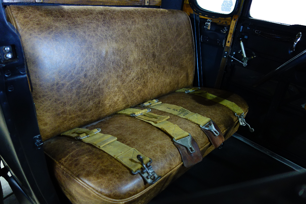

    Not a roadster but I have a van seat in my A coupe. Had it rebuilt to fit my ***......bought a distressed hide, to fit the era and had it reupholstered. Worked really well for me.

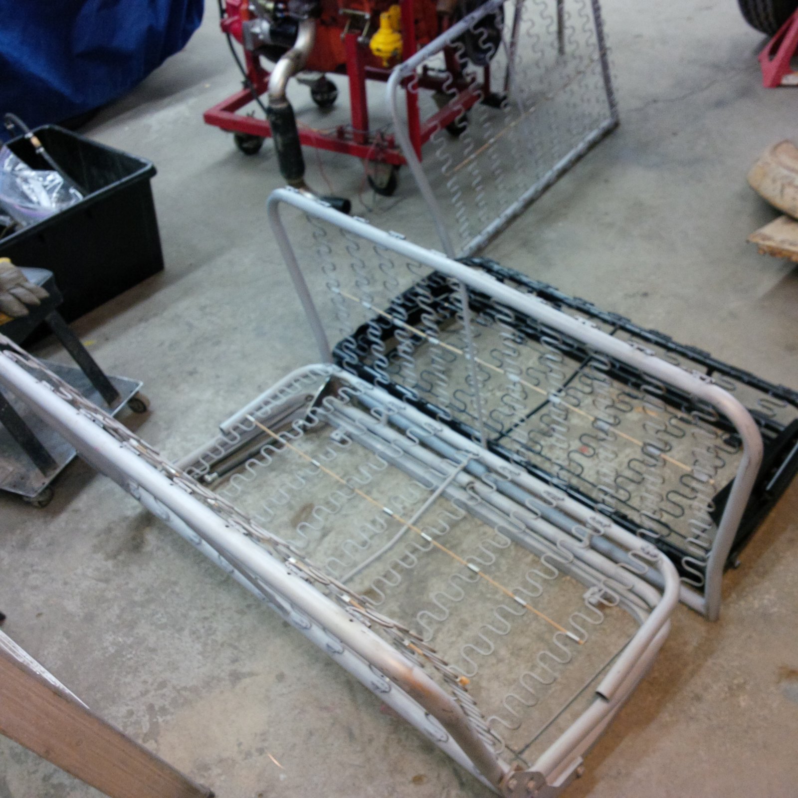

    I got a couple of school bus seats for around $10 from a guy who was building a party bus out of it. I cut the frame all to pieces and ended up using two bottoms. It's kind of crude but it fits the style of my early 60s build 27 pretty good. DSCN1108.JPG DSCN1109.JPG DSCN1110.JPG

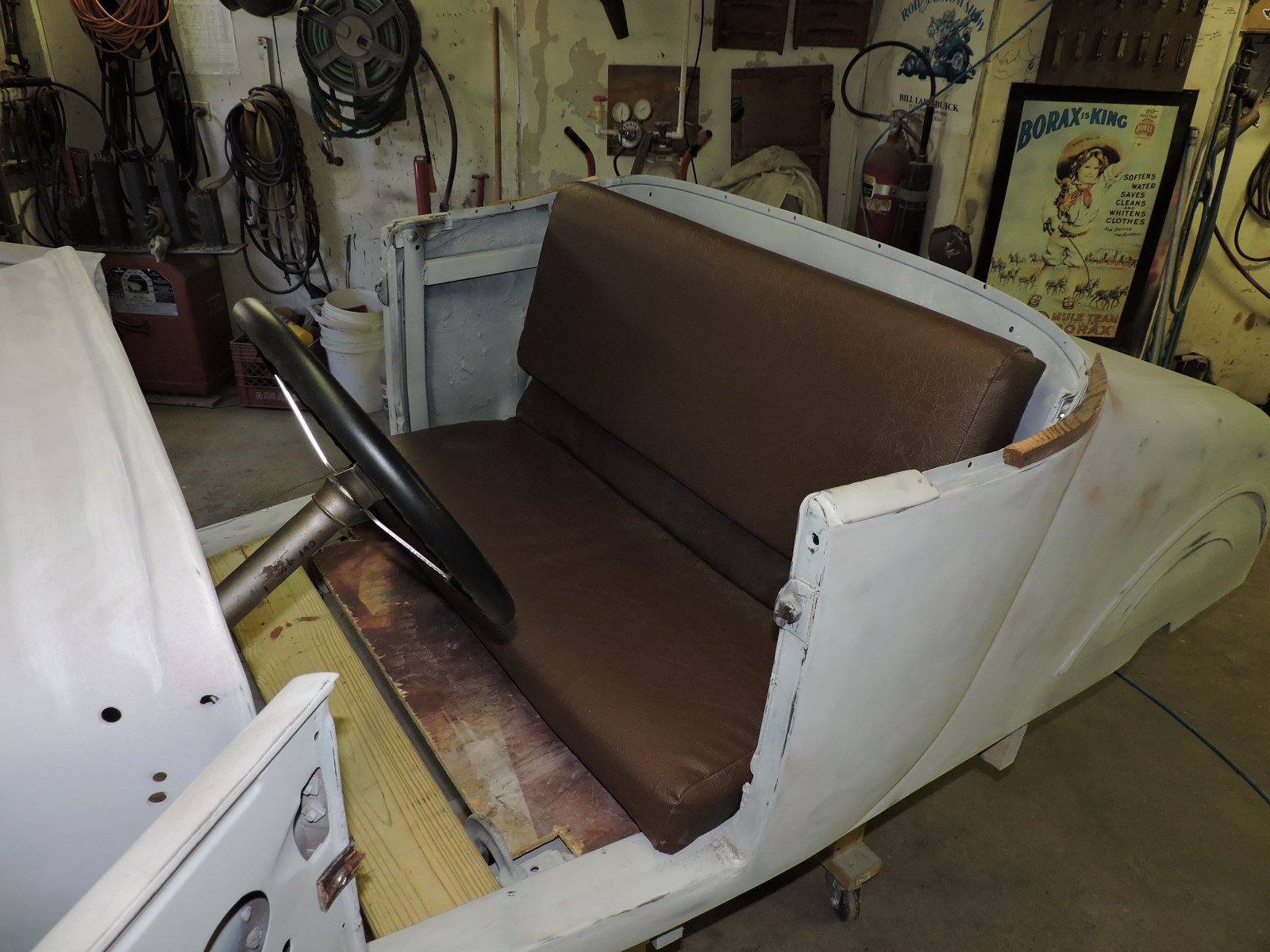

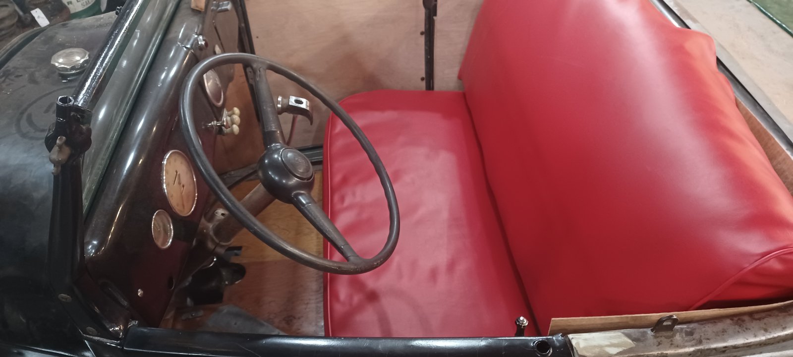

    If you have the original seat springs use them as they are very comfortable and will last for another 70 or 80 years. Some Cotton batting or foam over the spring will give you more comfort. Some new seat covers and will feel and look great. On my roadster I have original spring and change up the seat covers for a new look 736FEE92-E08A-471F-B88F-CC17B9934343.jpeg B85A6582-F1F2-4B03-8164-0D8818BD5F35.jpeg

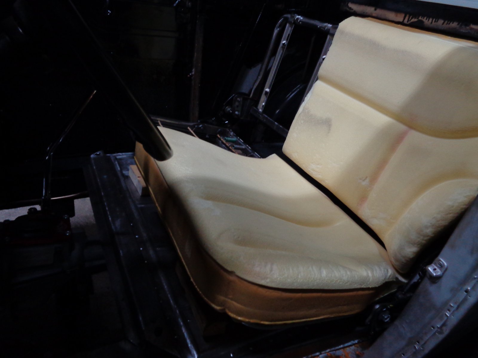

  12. If you have the riser you are half way there. Some plywood, some webbing and some med to high density foam and you have your bottom. No springs needed and you end up with a lower seating position that is also more comfortable. Pics stolen off google but from the HAMB

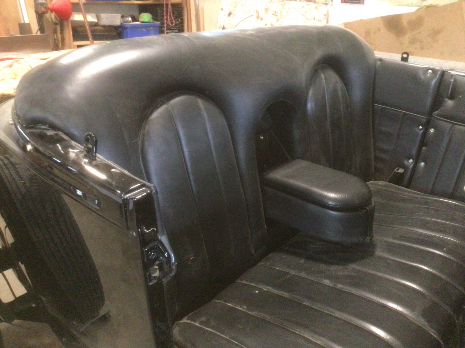

    F765CA28-EAE4-4380-B589-7D451844EAD1.jpeg 9F157789-4645-428D-ADBC-728422D26BE5.jpeg I have really enjoyed having an armrest in mine. It has a lid and works as a glove box too. If you make it strong enough it helps in getting out of the car.

    Tman, it's kinda hard to tell if the plywood on the bottom is inside the rim around the seat riser, or sitting on top of the seat riser. Can you tell?
  17. Typically it sets down inside the lip. I helped my old boss redo his years ago, the webbing, which we added, made a HUGE difference in comfort. I am doing the same on my 51 GMC. It also allows easy access to the storage under the seat.

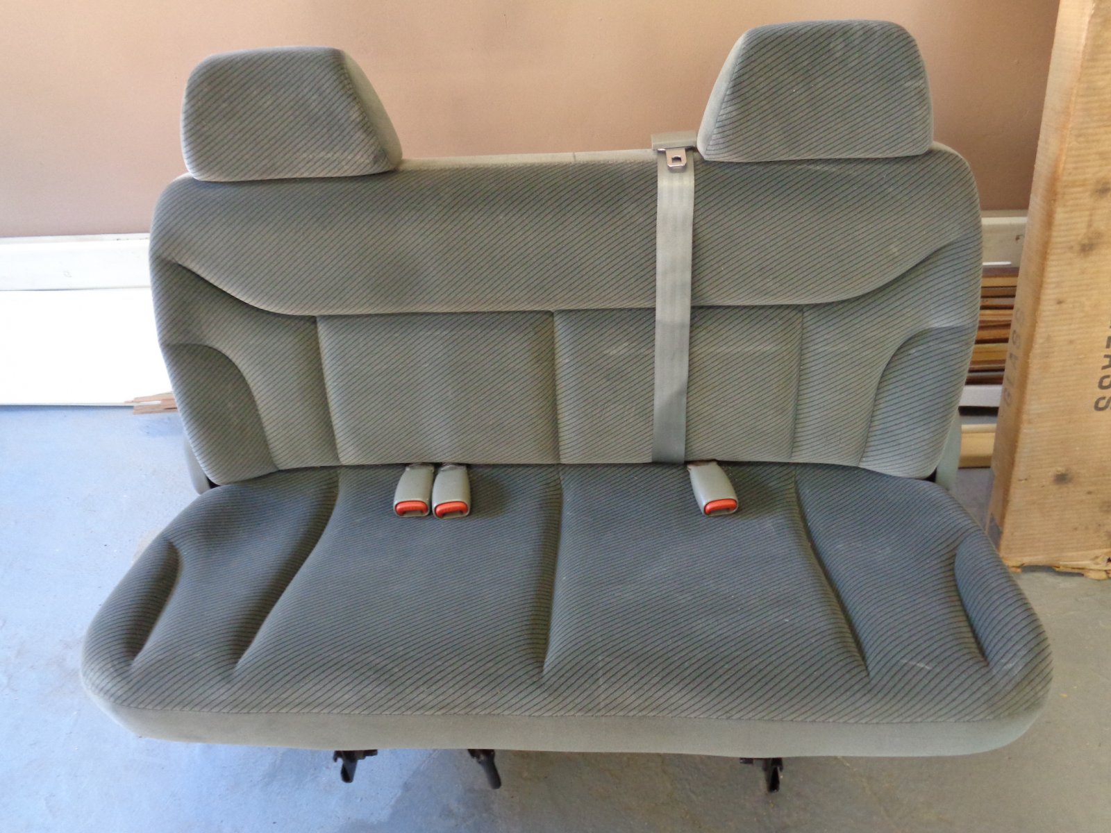

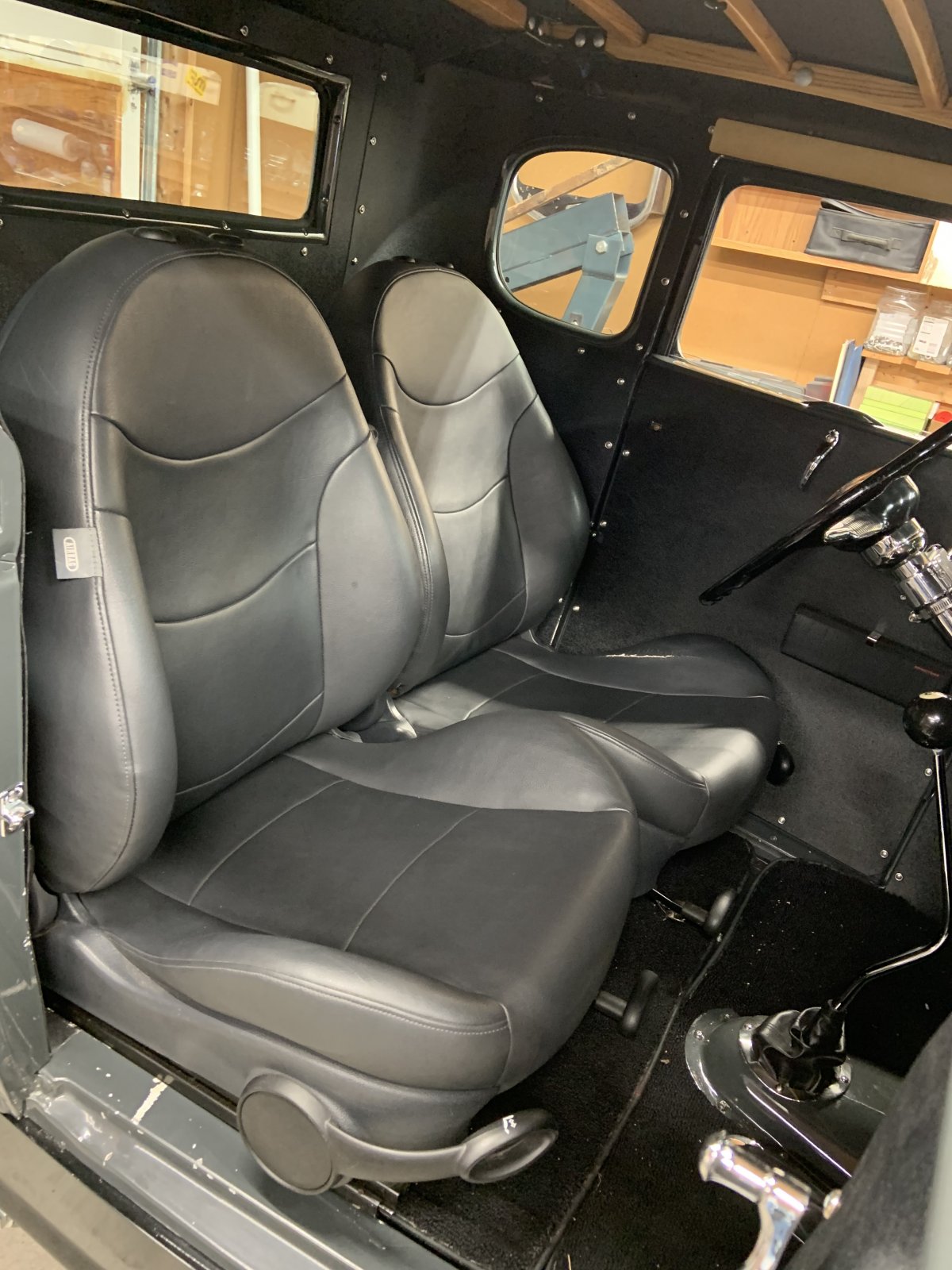

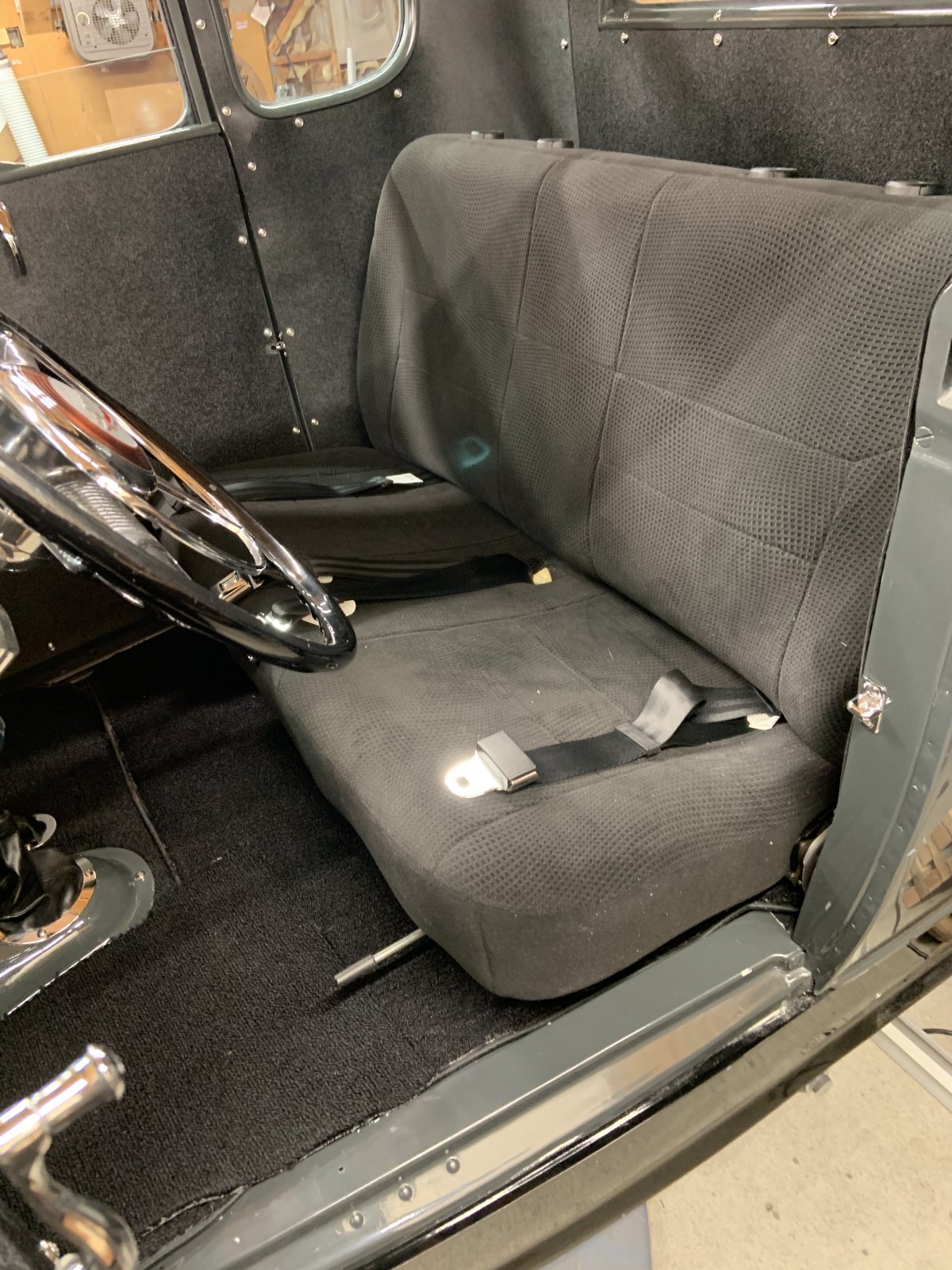

    I used a Caravan middle seat but I found it wasn’t very comfortable. Found a pair of Mini Cooper seats on Craigslist. Much more comfortable 02B3FB14-9A44-4D91-87EC-69A79E2DB352.jpeg F731B8EE-C834-4207-BF11-8341FE71AAD9.jpeg

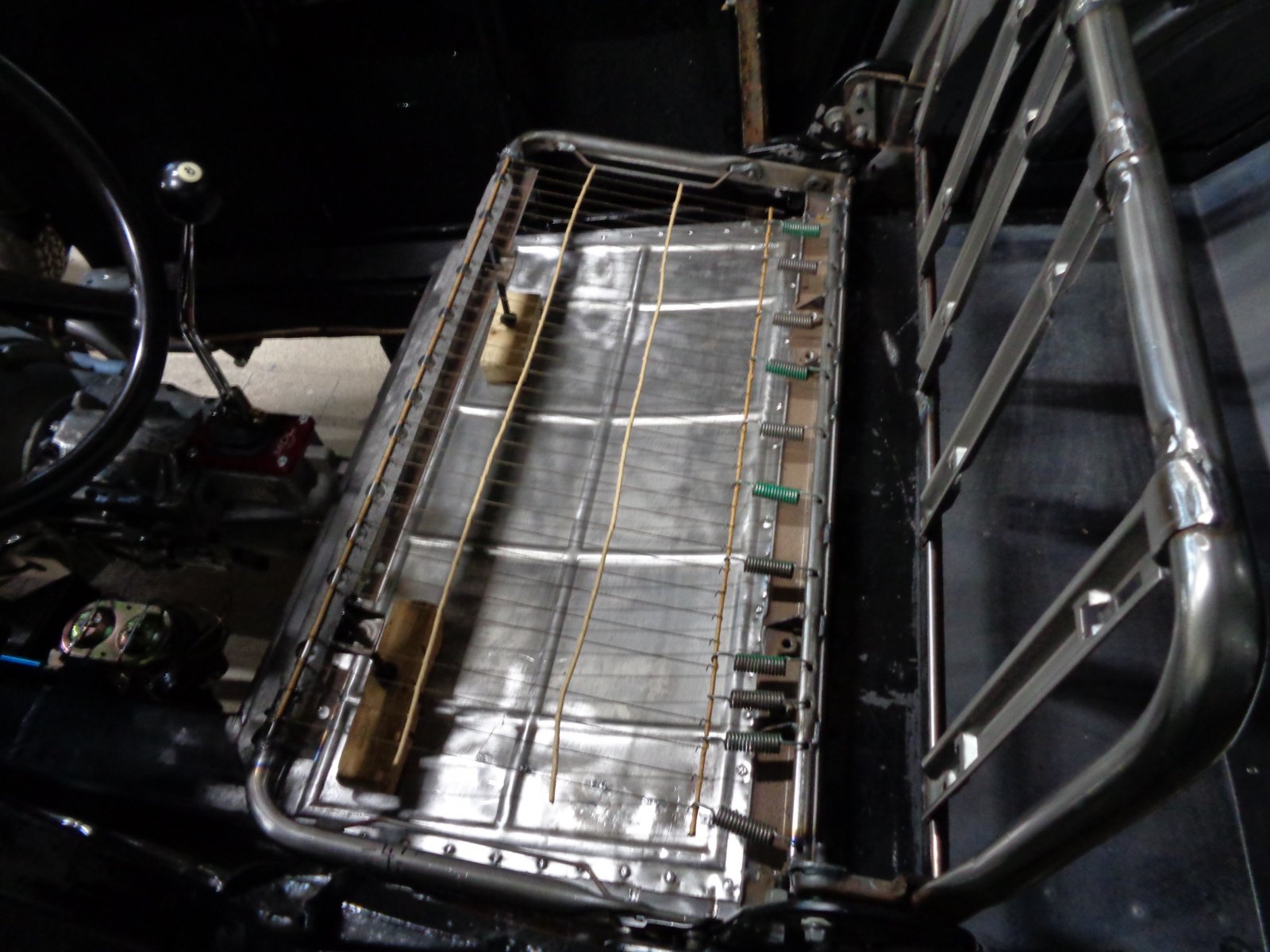

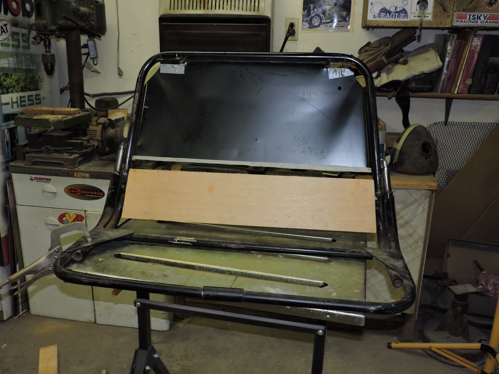

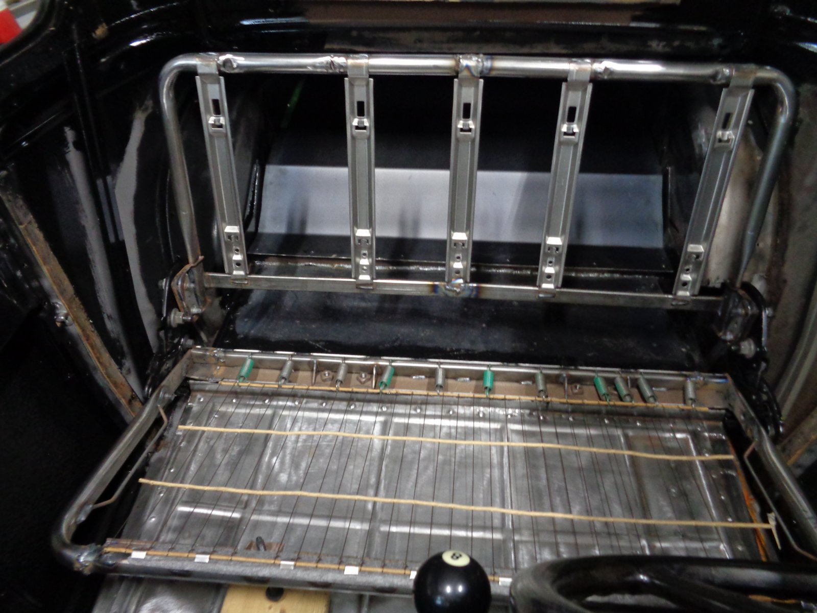

    I had a Dodge Caravan 3rd row seat taking up space, so removed the covers, foam and then narrowed the frame 5 1/2". This gave me a perfect fit for my channeled 30 A coupe. The back tilts forward for access behind the seat and the seat raises up for storage underneath. The back has an adjustable tilt and the seat front can be raised or lowered. I just started this project and am going to reupholster it once I figure out a simple slide set-up for fore and aft. The original was too bulky and heavy. I am going to trim the original foam thickness and build some lower density foam into the new uoholstery to try to improve on comfort. DSC07089.JPG DSC07095.JPG DSC07096.JPG DSC07098.JPG

    That's probably where I will end up with my seat. Nicely done by the way

    Thanks, I still have the stock bench seat, which is not too bad in the comfort department but I couldn't get it to set down low enough and it didn't provide storage under the seat or access behind and was heavy. If I opt for a modest chop, this seat gained me about 2 inches of additional headroom. The price was right too, free.
