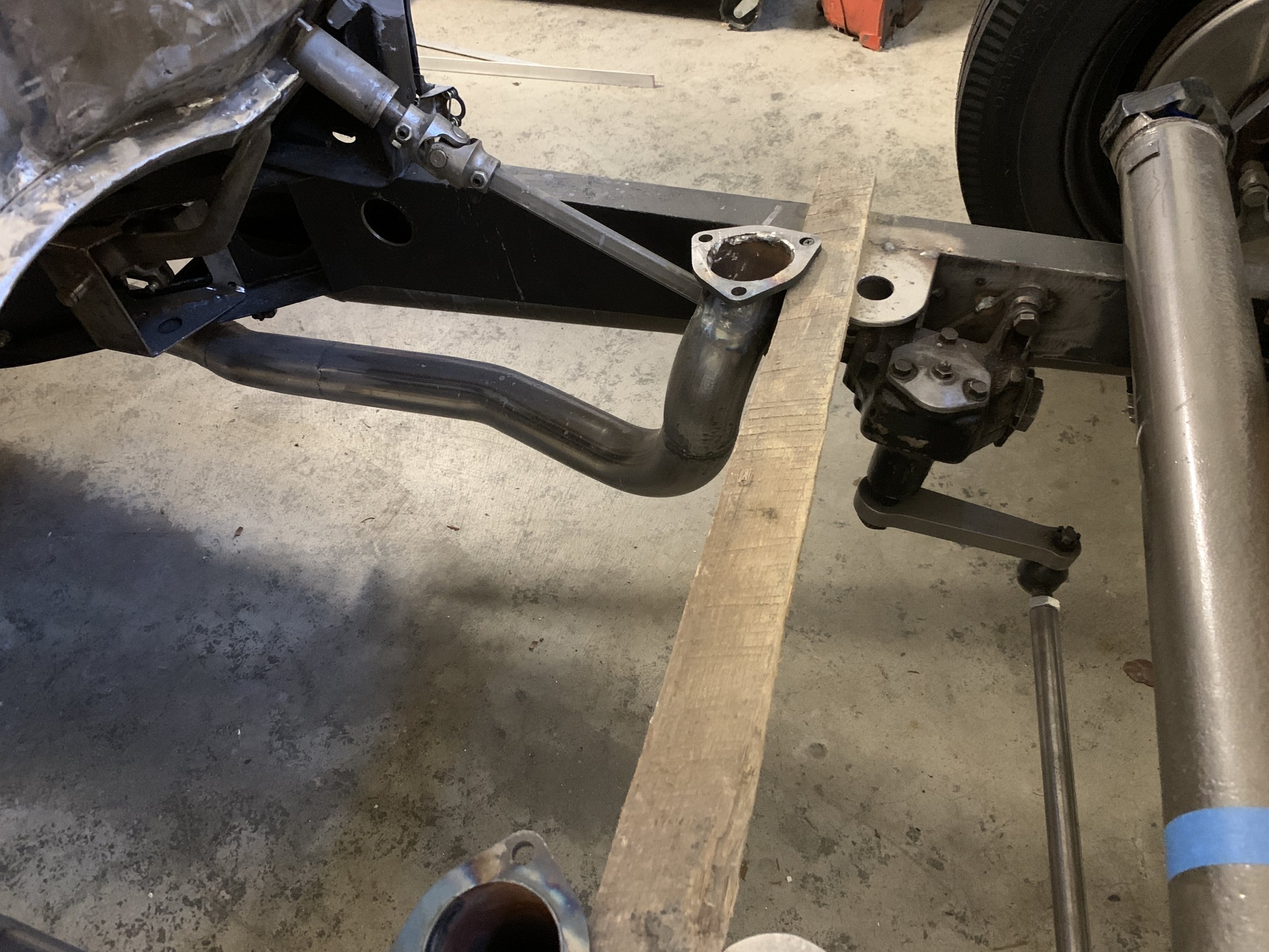

  2. 1 u-joint at bottom of column and 1 at the vega box...shaft snaked through the lakester headers.
    The column was homebuilt out of stainless steel tubing with a bearing on the top and bottom. I used a cut down original Ford inner shaft.
    leadsled, AVater and rusty valley like this.

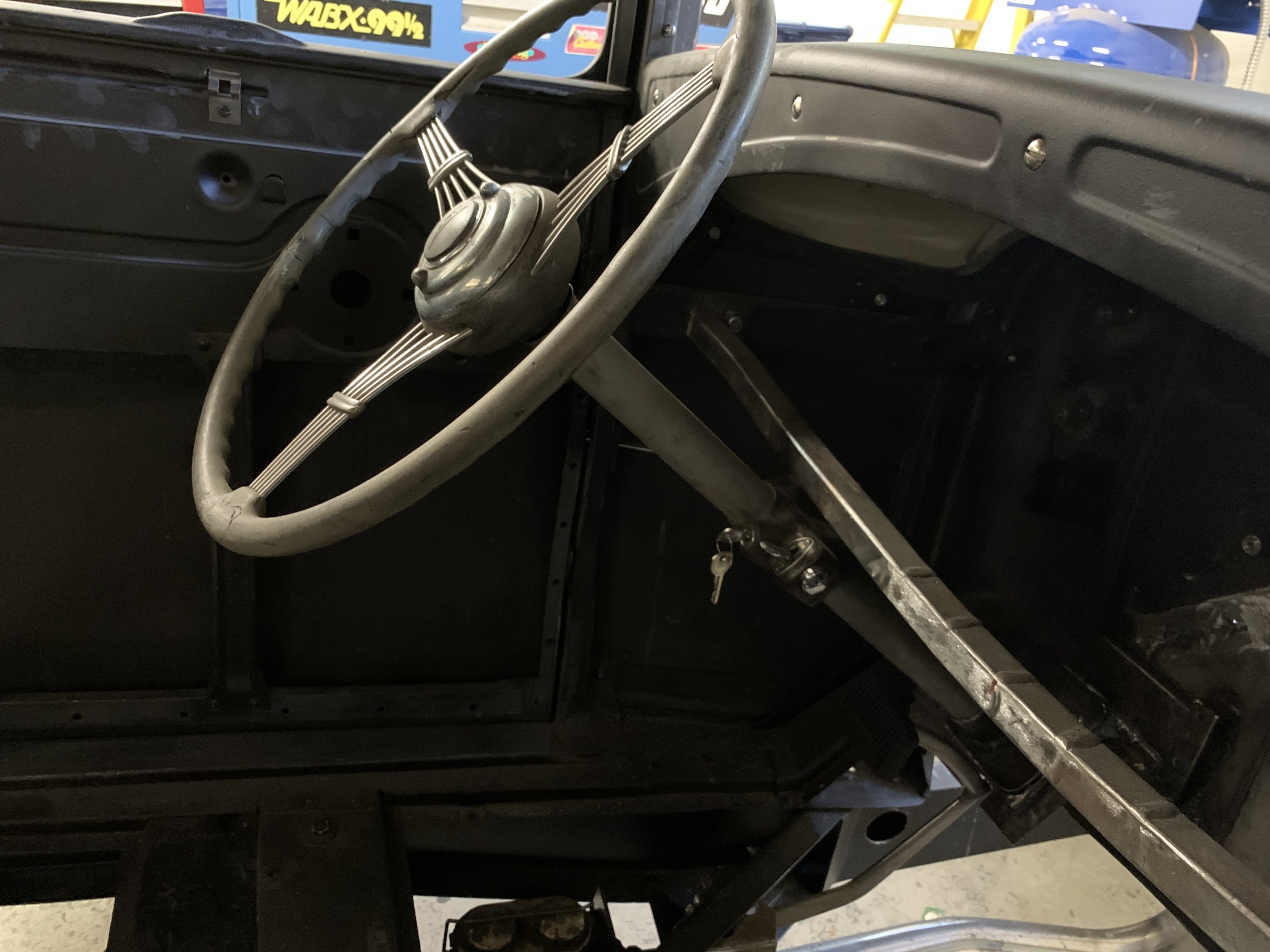

    Mines a 35-36 column with 40 ignition switch/lock. There’s a second universal joint at the steering box IMG_4245.jpeg IMG_4244.jpeg
    AVater likes this.
