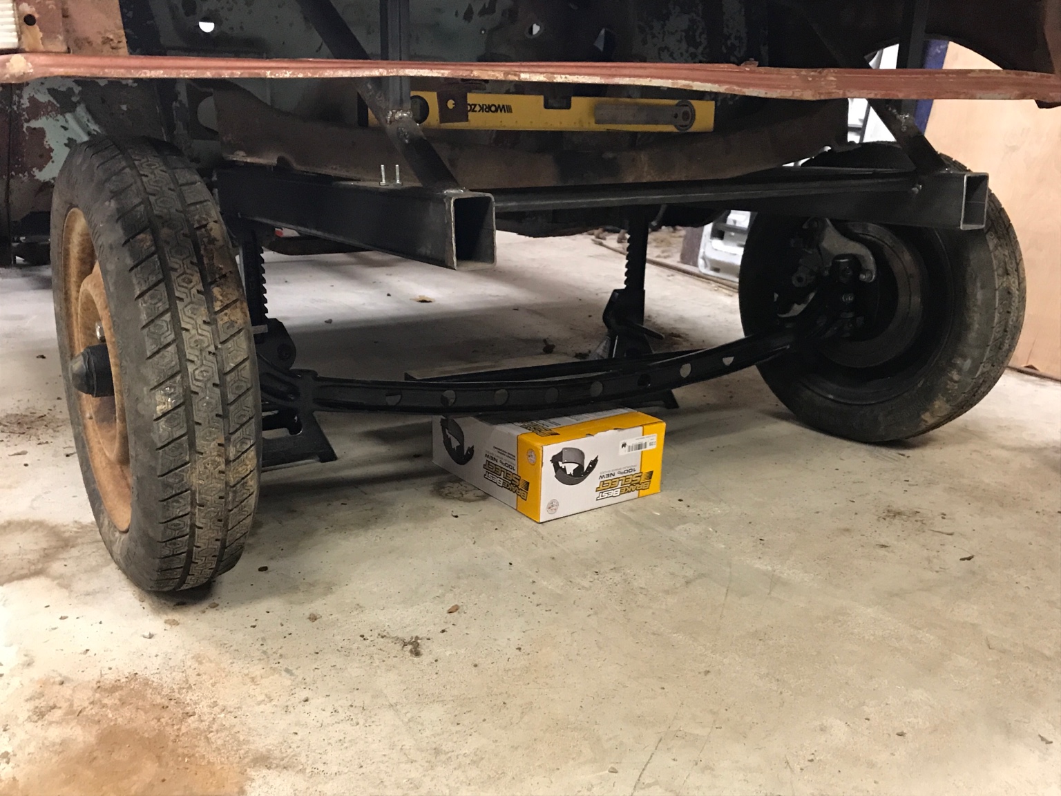

    So do I just keep the rear end fixed to the springs by clamping them down with the u bolts?
  2. saltflats
    Joined: Aug 14, 2007
    Posts: 13,597
    saltflats
    from Missouri
    You would weld these to the axle tube after you have set your pinion angle then use U bolts.
  3. Doctorterry
    Joined: Sep 12, 2015
    Posts: 686
    Doctorterry
    This is squirrels, the mono leafs have the little round keepers on them on the bottom, I'm guessing they go through the plates under the spring. Either that or he cut them off.
  4. DDDenny
    Posts: 22,444
    There needs to be a locating pin, not just relying on the clamping force of the u-bolts.

  7. Doc, As Jim said, the nubs are on the bottom of monoleafs. They are spun or friction welded into place . That process leaves a bit of weld there. So, you need to make your bottom plates tight on the nub, then maybe chamfer the hole a bit so the plate clamps down tightly on the spring. Or clamps UP, I guess I should say.
    That's the only thing that locates the rear end with cal-tracks or ******* bars.
    loudbang and Doctorterry like this.

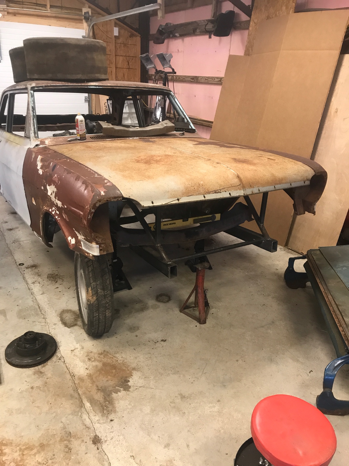

    Well I got the front of the rear leafs mounted and tacked in place... but this is all I have to show for the shackles and mounts [emoji28][​IMG]
  22. Least of your problems, Doc.
    But...you're going to have to spend a bit for some new parts eventually.
    Contact Lyn Smith on this forum for Chevy II replacement parts
    Now, you can drill holes in the rear frame and insert a piece of tube of the appropriate size for the rubber bushing.
    Hate to keep harping on this, but if you had planned and plotted this ahead of time, you could have used a drill press to drill the holes. Going to be a bit harder to get them straight across now.
