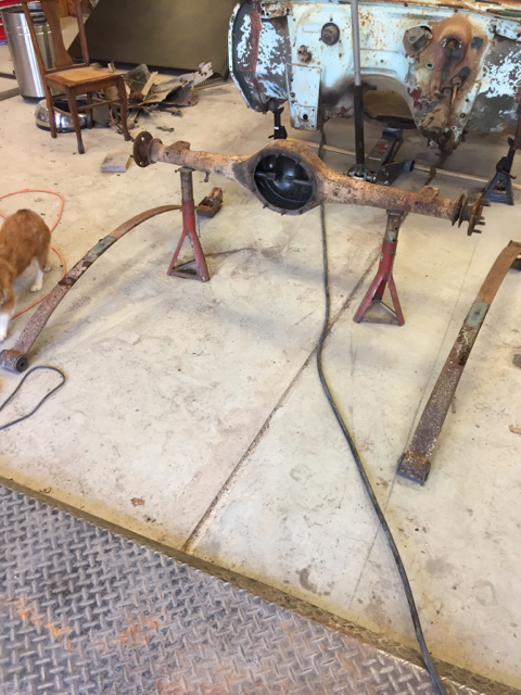

    Look what I bought! Lucked out this time... mustang 9 inch so it won't have to be narrowed. $100 later, I don't think it was too bad of a purchase

  17. DDDenny
    Posts: 22,580
    Those mono's would buckle under a six cylinder, that big Cad motor will make pretzels out of them. What is your plan for traction control, ladder bars maybe.
  18. squirrel
    Joined: Sep 23, 2004
    Posts: 60,039
    squirrel
    heh...I have the original monoleaf springs on my car, and it's been in the nines. Don't be afraid of them, they're nice springs.
    I made my own bars that look like Traction Masters, but work like CalTracs.
    Might be a good score on the rear end. See if you can find some brakes for it.

  19. Doctorterry
    Joined: Sep 12, 2015
    Posts: 686
    Doctorterry
    The man I bought it from also said he would move the saddles for me for free... he just likes helping a man out. He also is going to give me all the parts numbers to put disc brakes on it for $200... I know this isn't era correct but I don't wanna worry about stopping.

  20. chevy57dude
    Joined: Dec 10, 2007
    Posts: 9,716
    chevy57dude
    You did well on the housing. The Ford 9'' is like the SBC of rears. You can run 'em near stock, fill 'em with aftermarket stuff or go all new. Thought I had it licked when I got my 9'' big web 31 spline truck rear. Now all that's Ford is the housing itself. Poor man's quick change.
    Super Stock Dodge racers used to clamp the **** out of the front leaves on the springs to prevent windup. With only a snubber, it was effective and won a lot of races. Jenkins ran mono leaves with ******* bars, and stood the world on it's ear!
    Personally, I feel the setup Mr Forbes has on his Chevy II (see above) is a track and street proven combination and the way to go. No arguing with the man's success! His car leaves HARD!
