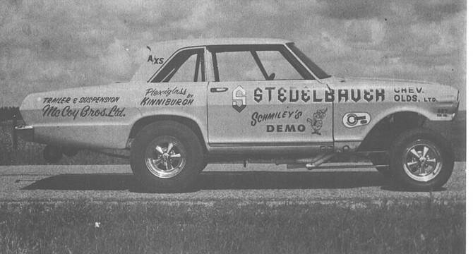

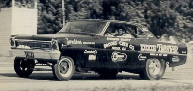

    [​IMG][​IMG][​IMG][​IMG][​IMG][​IMG][​IMG]
    These guys didn't get the memo that they had to run parallel leaf front ends to be correct. Build it the way u want. I'm pretty sure if u look hard enough u can find a chevy II from back in the day with a drilled I beam axle. They were using whatever they had back then.

    The problem with those are they are dropped. I like this axle because it has the smile through it, and it has no drop...

    It's a neat car. Dropped tube axle...pretty common in those days! You can still get them made, you know

    But try to follow 2017 rules with regard to the scrub aspect ( that being that no suspension component shall be lower than the wheel rim, should a tire go flat)
    This one looks dangerously close, but it's hard to tell.

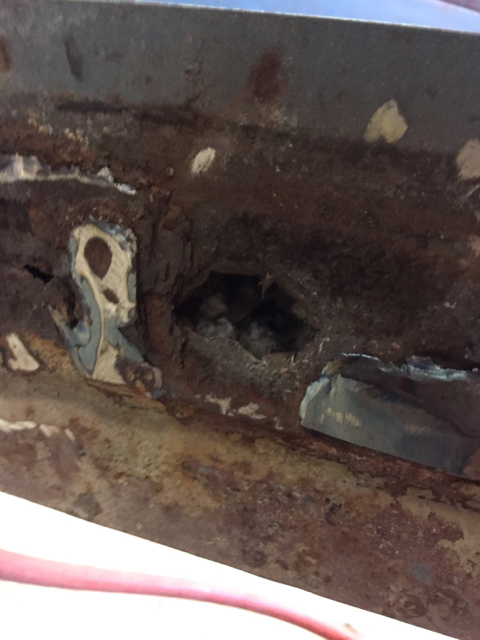

    I cut more of the floor out to prepare for the front half of the frame
    I plan on running from the front sub frame straight back, bending up over the rear end (8 inches sooner than the factory frame), and then continuing back. Seems pretty simple?
