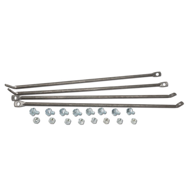

    Of course this isn't proportional, but this is what I pictured. I accidentally drew the rockers all the way back, so the shaded in part is behind the rockers. Do you guys think I should tie in to the rockers in more than 2 spots on either side? I planned on bracing the quarter panels to the frame with 1/2 inch solid rod braces like you'd see on a pick up truck to keep the bed sides from flapping.

  25. I don't see any real problems so far.
    Don't limit yourself with tire room too much, after doing all that work on a frame.You might decide to narrow the rear a bit some day.
    You ought to find a rear section from another car , and put that back together ,before you get too deep into the frame layout, like I said earlier. Could be from a 4 dr parts car. I'll bet somebody here has one.
    The bumper bolts directly to it on those cars, and not to a frame or subframe.
    Are you going to use leaf springs, in stock location, or moved in? The rear shackles will need to be mounted to something back there.
    Forget the rod idea. Tie it all in, in a normal manor.

    The leafs will be moved in a few inches for more tire clearance.. then I will make a spot to mount the shackles. The only reason I thought of the rod idea was that I don't know how to tie an aluminum floor into steel quarters... I could run 1x1 square tubes from the frame all the way out to the quarter. That will probably be necessary anyways to help brace the floor.
  27. Tie the quarters together in the middle first, like I said, twice now.
    Then tie the back piece to the frame rails. You need something to attach the bumper and trunk latch to, anyway.
    You could always use some small 3/8 " rod braces from the frame down to the lower lips on the quarters, if needed.
    You don't attach anything to the quarter skins, themselves.
    You need a parts car, or at least a rear clip, unless you are one hell of a metal man.
