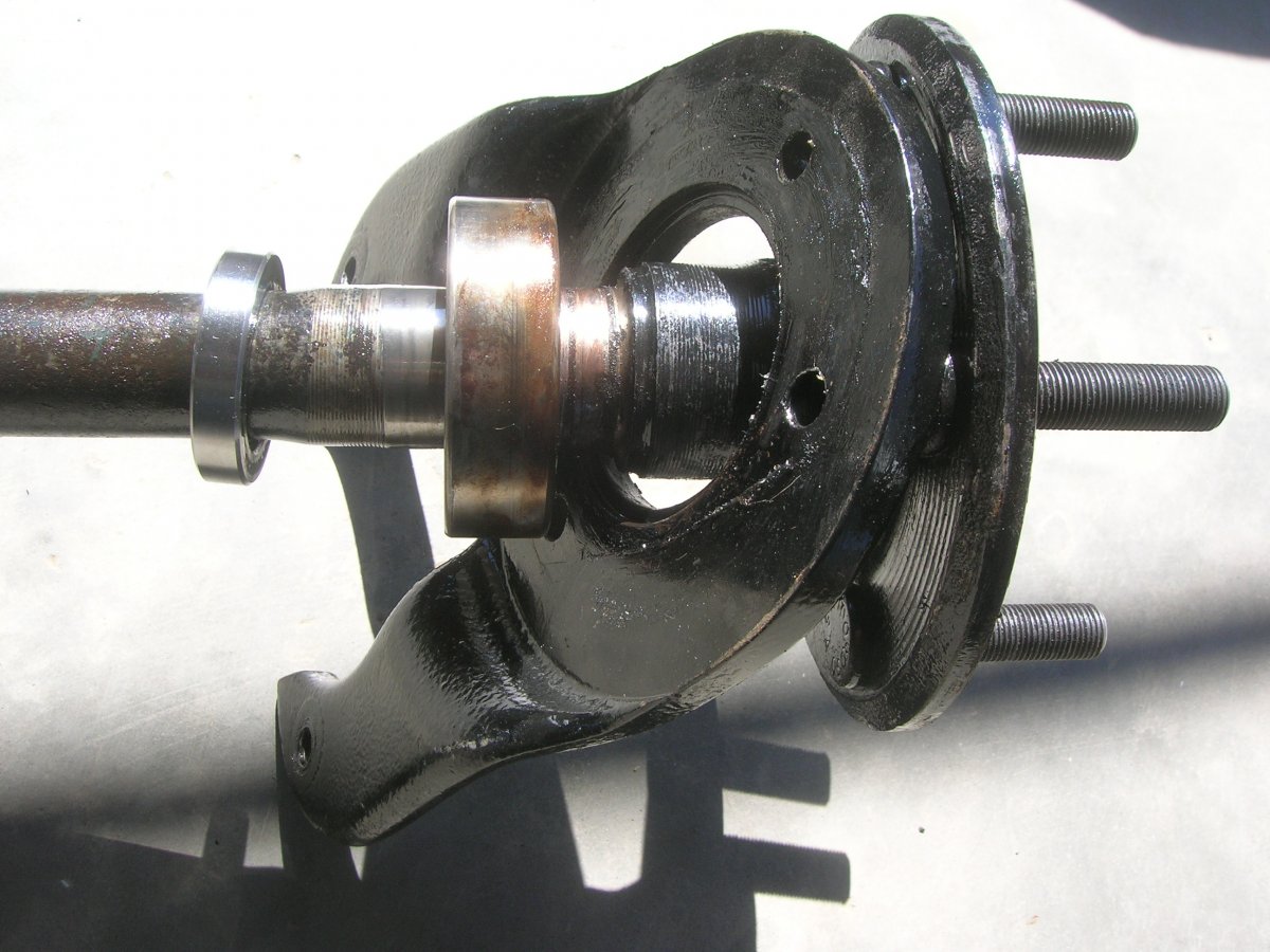

    One of the guys just brought his axle to show me. Ford 9" that the axle has walked out of the bearing. He has replaced the axle once already because he lost it.. Yep Axle came out of the bearing that time too, so he pulled the other side and saw the axle had started to walk out of the bearing. NOW it has done it again after he replaced both axles and bearings.
    Totally has got to be something wrong.. The bearing and lock show no heat damage. Measure the axle and bearing looks like about a .002 interference fit on the bearing and lock.
    Keep in mind this is his second set of axles. They are doing the same thing as his original axles.
    Car is an aftermarket ch***is under a 36 GM Sedan. Runs 10" wide rear wheels and tires. axle housing was checked for straight and true- Car has been in an alignment shop to check rear axle square to the frame.

    that's a stock ford axle i think the Axel mite be a hare to long and with that cal bracket it is pushing on the bearing instead of just retaining it and it working like a press putting preacher on it and pushing it off

    One thing I would check. Put a bearing in the housing without the axle. Put the caliper/ retainer on and see if there is any clearance between the retainer and bearing. Make sure the bearing is fully seated in the housing. It looks like that caliper bracket has a pretty deep pocket for the bearing... May be allowing the bearing to move enough to act like a slide hammer. You have to remember that if you are using a tapered axle bearing the retainer puts a bit of pressure on the race for preload. If ball bearing... It just keeps it in place.

    Retaining ring is a bit to large . If properly seated and correct size it isn't moving if it had a caliper bracket or not . Green bearing retainer is good stuff , but it's a bandaid ! Find the issue and green snot to good parts and never look back ,
