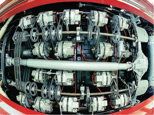

    I got yer line shaft driven alternators right here.
    TCATTC, 49ratfink and Ned Ludd like this.

    What's that in?

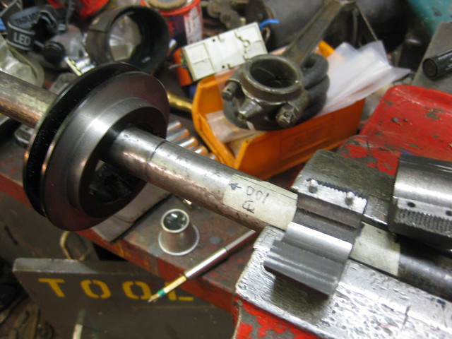

    I've done two conversions on otherwise stock 1920s/30s cars where a Kubota alternator has been driven by a belt off the driveshaft. The owners were not prepared to have a modern alternator visible on their motors. Both conversions have worked (and are still working AFAIK) fine. The ammeter shows charge from about 20 MPH. But these cars don't have a high electrical demand, nowhere near the nominal 40A output of these Altys; it's also the case that this type of car is more likely to be found pottering around on country lanes than stuck in an urban traffic jam in the dark.
    Fitting the pulley on the stock driveshaft where the shaft diameter is smaller than either end of the driveshaft was a bit of "ship in a bottle" issue that needed solving:
