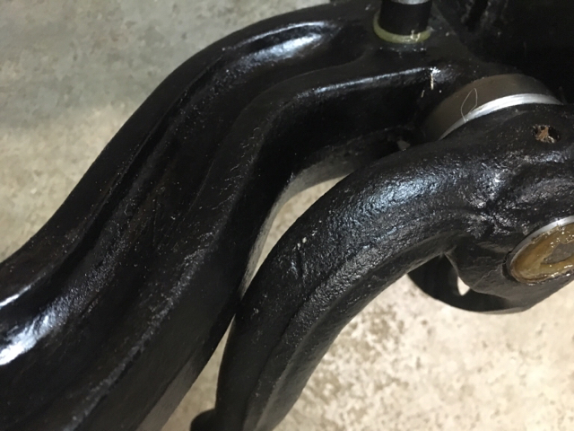

    Need a little ***istance, please....
    Model A axle, dropped 2.5"
    Everything else is '40 Ford
    Mounting the spindles went well, for the most part...
    That is until I turned the spindle...
    I'm thinking I'll need to hack off the '40 arms and use these...
    Is there a way around this modification??
    Thanks
  2. heating and bending steering arms has been going on as long as there have been dropped axles for hot rods. Pete & jakes shows how in their catalog. i have done it dozens of times
    i prefer the look of heated and bent arms over bolt on ones

    I think the only fix is with a torch and a pipe wrench. Duplicate the profile of the aftermarket arm. the process is mentioned in the Bishop/ Tardel A v8 book. I personally have not performed the heat and bend.

    I guess this will brand me as an old guy, but when I started building an oxy/acc torch was a necessary tool. If you didn't own one you hoped a friend did so you could cut steel, bend it to shape a bracket or pedal and most importantly adjust steering arms to clear a dropped axle and correct the Ackerman.

    If you do decide to heat and bend the arms it can be done without a rosebud tip, I just used the largest tip I had but I kept it moving until I heated a large enough area and a dull red will be enough, no need to heat it really hot. Look where the interference is, heat, bend, check and once it clears you want them to slow cool, for sure no water quench or even compressed air. Next move on to the Ackerman. I won't go into that here as there is plenty of info available on line, but basically you need axles mounted on the frame and squared up to the centerline, some string and a plumb bob. Knowledge is power, you can do this!

  14. heat and bend the original steering arms. That is the better solution of your current options.
    I would do it on the vehicle not before hand but that's just me.

    Well, I am an engineer, and I am not.
    If you do this properly, there is no issue. As has been mentioned, if you are working with aftermarket components, of dubious origin, you are far more likely to have issues than if you are starting with Ford River Rouge Steel.
    I heat and bend all sorts of steering and suspension components. I cut and weld pitman arms. I have created spindles nearly from scratch (used a few off-t******lf parts). I have made adjustable width center links. Not a single one of them has broken, not even on a compe***ion level off road rig.
    powrshftr, RICH B, 302GMC and 2 others like this.

    Get after it with the torch, no big deal. PLEASE don't cut the arms off, if you do have to go the bolt on arms route sell the spindles and but aftermarket ones.

    About 70% away from the axle and 30% down. . Let the first heat zone cool a bit so it wont move when the next area is heated and bent. I had a measurement from the rear face of the spindle flange to the center of the tie rod hole, checked that it was the same and level as all was bent. It really helps to have someone helping as this procedure is done but can be done alone. Also, make sure you have all needed tools at hand before you start heating things up. That pic is bare metal.
