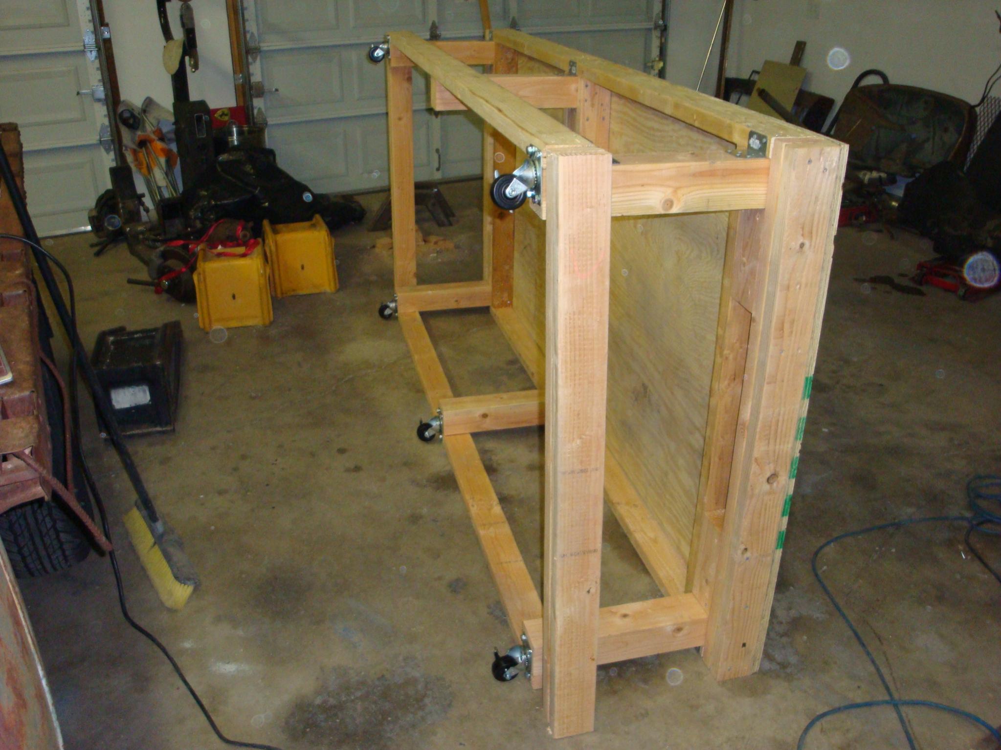

    The frame rails, k member and cross member are working there way to me so:
    I built this while I wait - I know its not much but I managed to squeak out a Body table last night.
    I needed something to get the body off the floor and at standing height because of a bad back.
    It will also allow me to move the body around my shop and have a solid foundation for striping, body work and chopping.
    I still have a few more gussets to add, but I should have the body on it tonight.
  2. Body table looks good and solid. Having it on casters is a smart move. Your body should be bolted to the frame when you chop it. Alternately, you can bolt it down to your table with the stock body blocks. 1/2" plywood shims under the blocks will give clearance so you can open the doors.
    I am 6'2" tall and long in the torso. My 31 Model A coupe is chopped 3". Just about the max for me.

    Bib,
    Thanks.
    Thats the plan. It has a 3/4" plywood top and was designed w/ supports under that that run in sequence with the coupe body mounts so I can lag it down.
    I can also do any cross bracing of the interior of the coupe by screwing to the wood and limit the welding to the body.
    I am currently thinking of doing a 4"F x 3"R chop.

    N8B
    Got the table finished and the body on tonight.
    This will work out perfectly for setting up the body work and the chop.
    It also gives me 4' x 8' x 12" of storage below.
    I have already started to do mark ups and measurements for the chop.
    I placed four strips of masking tape down the doors and cab.
    Having a level table allowed me to measure up on those four strips 65" from the floor.
    I then marked down each strip in 1" increments giving me plenty of options.
    This was primarily for photoshop visual before I actually dive in, because I don't think I am going to do a typical straight chop on this one.
