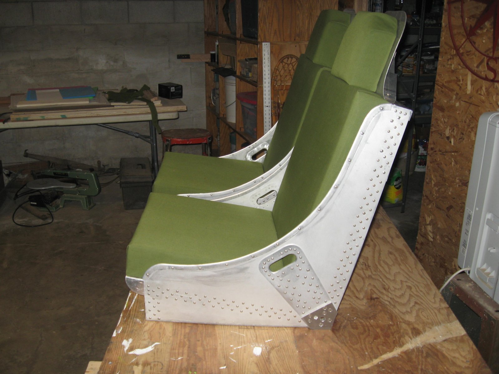

  2. Not because of the problem you are having, but because I had very little room side to side, I made my own seats. I found 2" of foam to be plenty on a seat back. If you stand the steering column fairly straight up and down, then the seat back can also be closer to straight up and down. I think you could save almost 6" between seat back and firewall over what you have mocked up now.
    These seat backs are 3" foam, 1/2" plywood, 1/8" aluminum and a 2" lip (where all the rivets are) that could be left off. I have more angle than most would need because I have bad discs in my neck and must drive laid back with my head tipped forward.
    BTW, bucking rivets is a lot easier than it looks. An air hammer, a special peen, an air regulator and a chunk of steel does it.

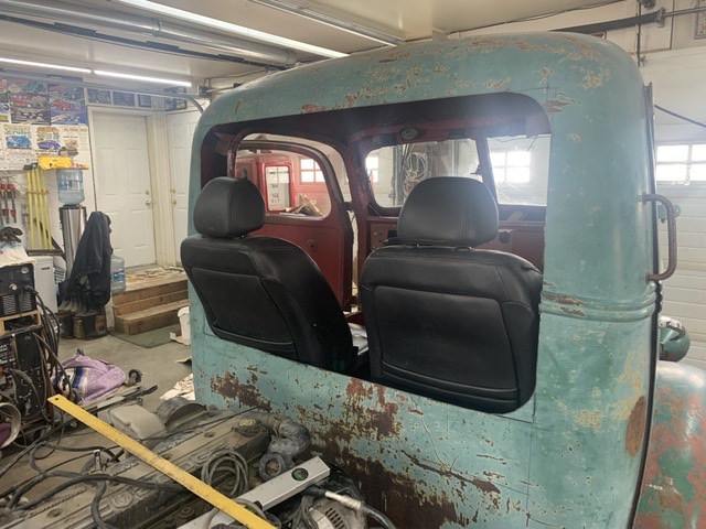

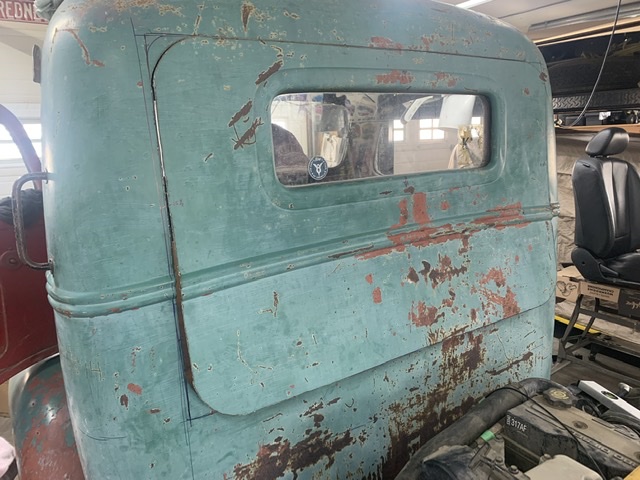

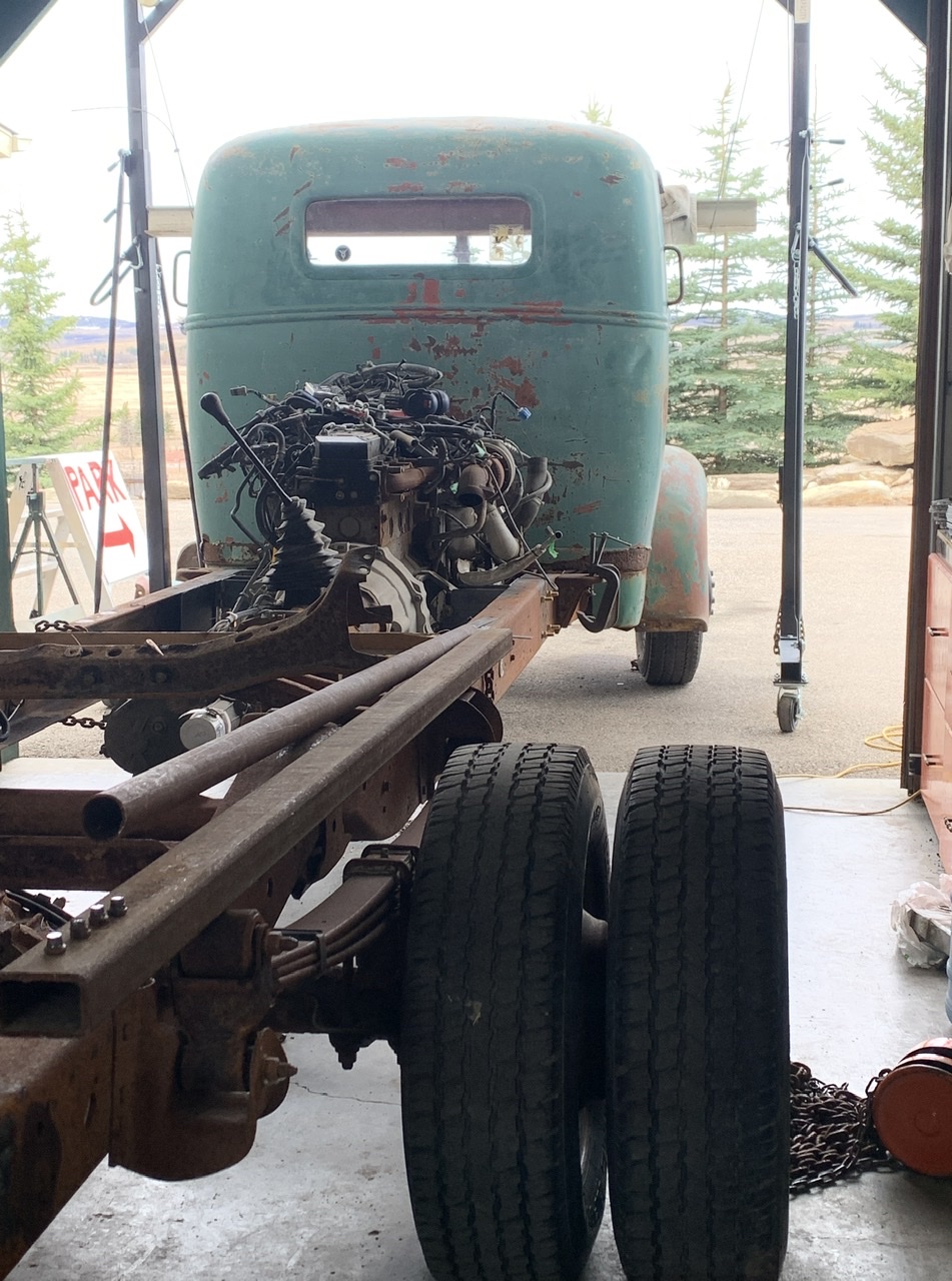

    So I took the plunge and opened the lumber wagon up today. Great legroom now.

    This looks vaguely familiar. Open air seating!
    What are your thoughts on "extending" the cab?

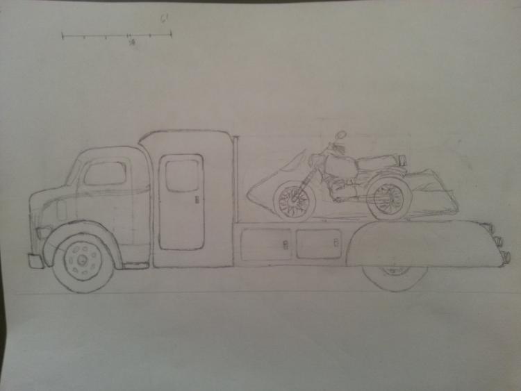

    This was the concept I am still working with.

    I really like the "extension" of the sleeper roofline out over the cab roof....

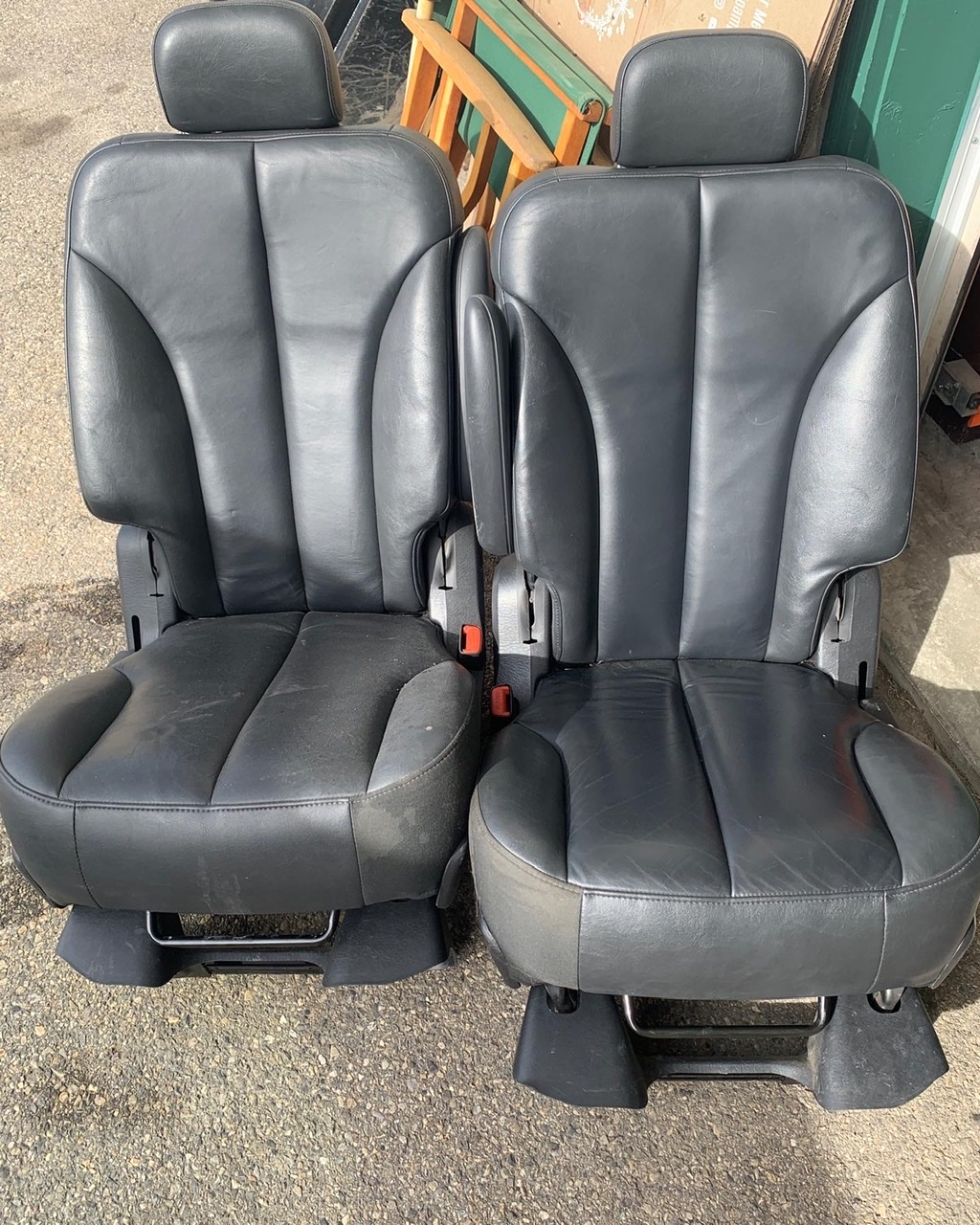

    Yikes. I picked up steel for the Sleeper Friday and nearly*****ped my pants. Cost was triple what it was last summer, so the guy tells me when we are loading the trailer. Oh well, like they say. “Ya wanna play, ya gotta pay”. At least I will have somewhere to sleep. Also found two more nice leather seats for the mother in law compartment. Sleeper seats tumble forward so that the bed will fold out over them. Hard to explain, but will post as we go.
    228332A8-9814-4133-9654-14FDE3FB28F7.jpeg B751D8C8-31DD-42FD-9168-BD8BBCD68163.jpeg
    RMR&C likes this.
  15. wetskier2000
    Joined: Jul 11, 2011
    Posts: 1,840
    wetskier2000
    from NH
    Nice looking seats.... What was the donor?

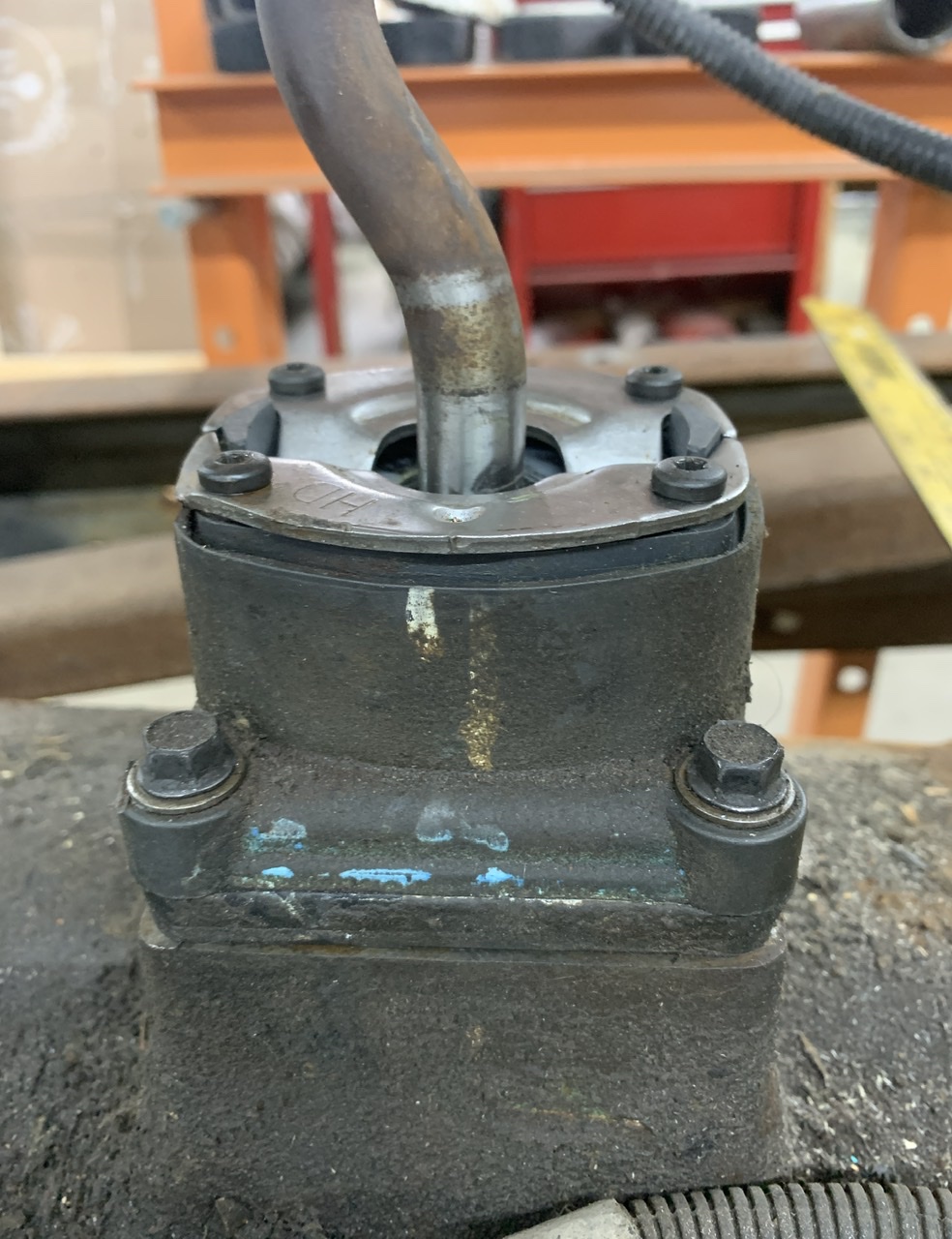

    Building a custom shifter. Will use cables from front to back to move existing shifter stub. Looks good on paper. Guess we will see how it does in real life.

    2005 Chrysler Pacifica

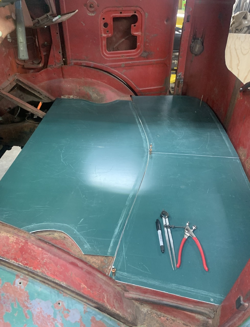

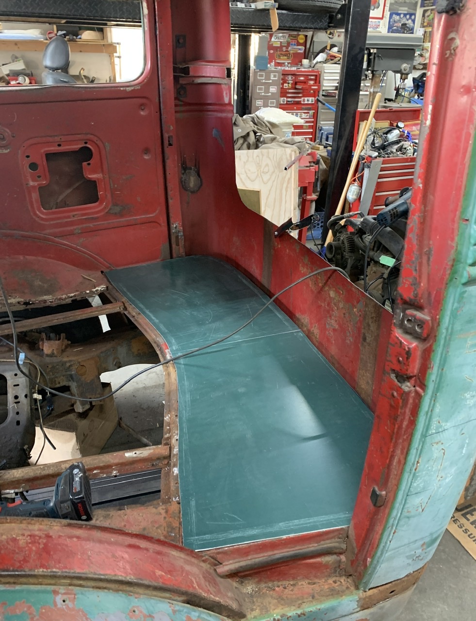

    Started working on the floor. New bracing and sheets. 5C4012AA-E048-4DD4-A62C-2118A61432B1.jpeg 9B8D9505-F2C1-484A-94FF-AE89E01132A7.jpeg

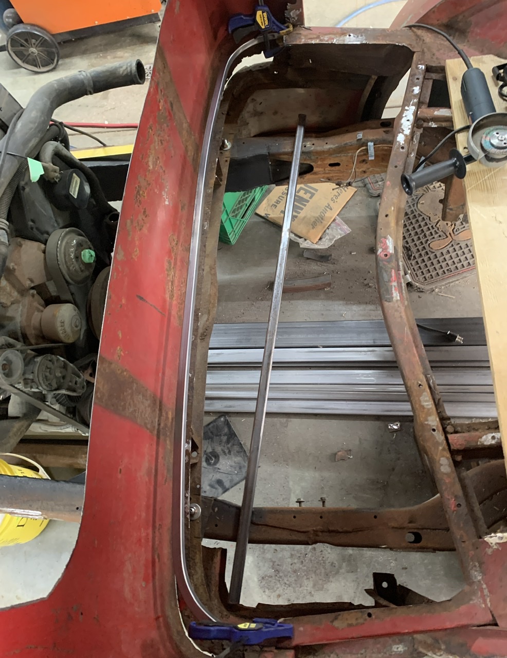

    EAB319D5-F9E9-466A-81A9-D20382A7AC7A.jpeg 5A25D3A1-EA0A-4E0B-96AE-9D4135429B5C.jpeg More CAD (cardboard****isted design) today.

    Nice! Have you considered a little more bead rolling on the center sections of those panels?
    b-bop likes this.
  27. b-bop
    Joined: May 19, 2008
    Posts: 1,011
    b-bop
    The sheet is thicker aluminum so does not need bead rolling to stiffen it.
