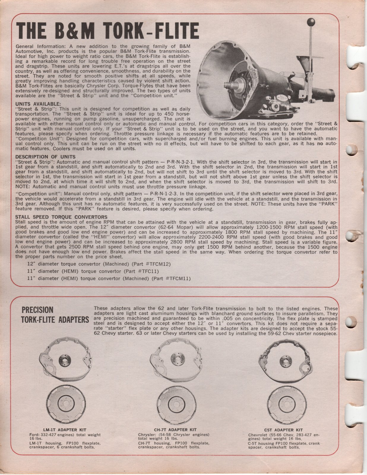

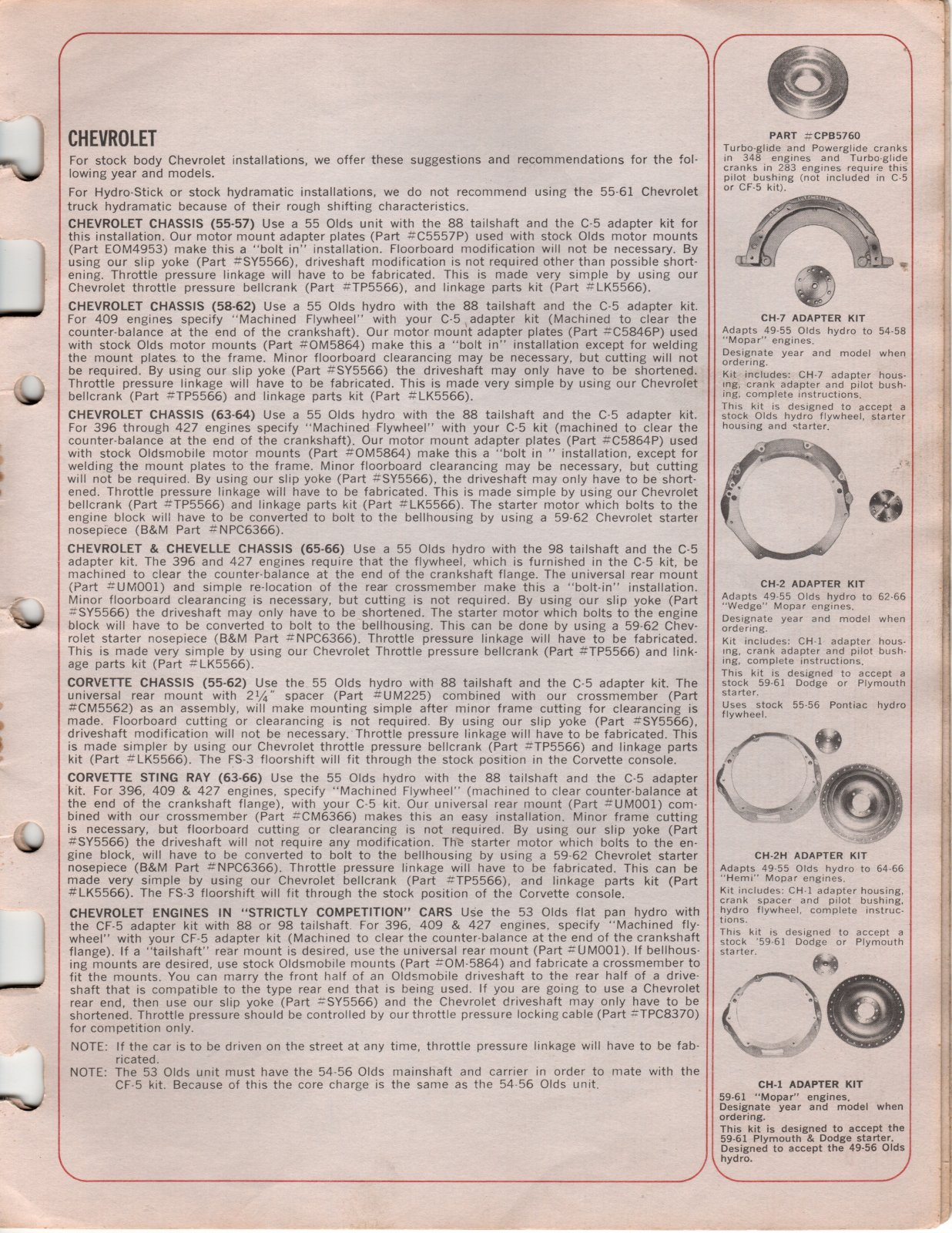

    Looked in my old B&M catalog and didn't find a CF-2 part number. Here are the pages with possible matches to your part.

  4. Thanks for the pictures... I will pass them along! Gene.

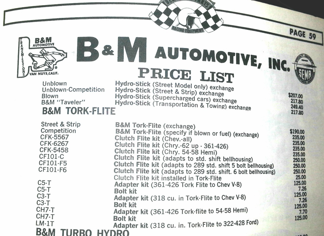

    I'm not alphabet soup but here is what I have. I think any adapter with a prefix of CF is for a clutchflite trans..
  9. Thank You very much! Gene.
