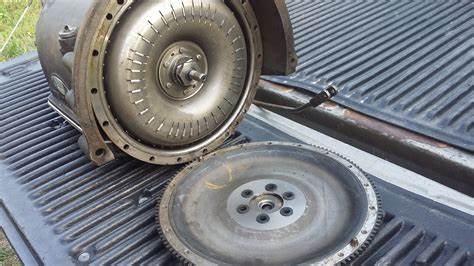

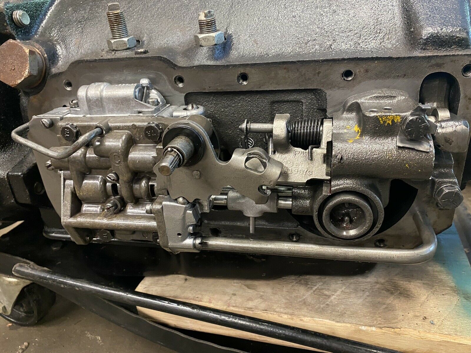

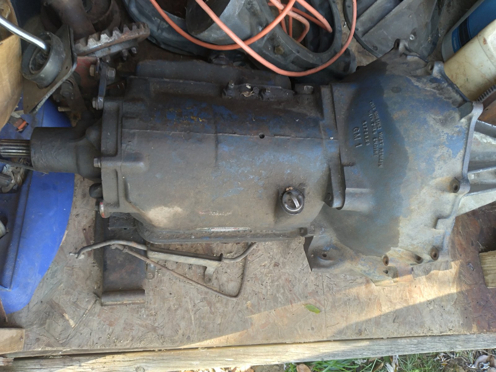

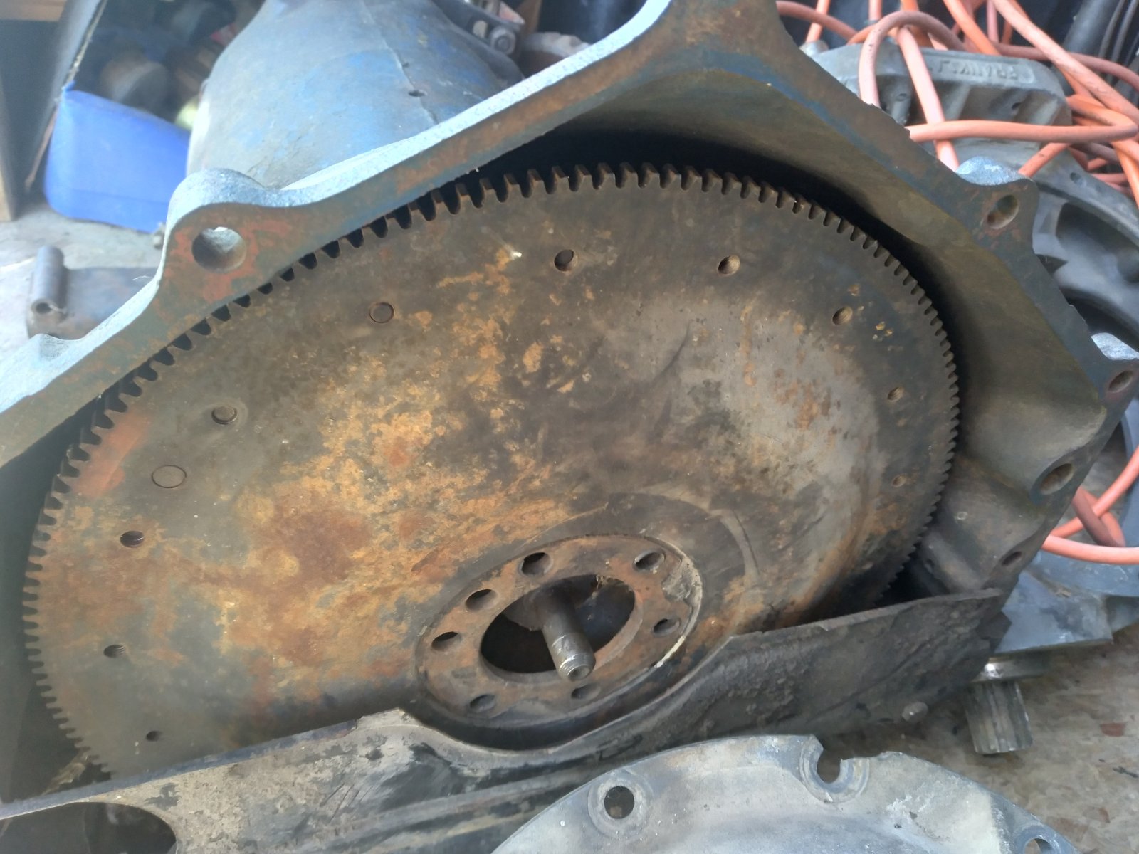

    Pics of the inside of the Hydro-Stick I'm looking at picking up. You all see anything I should be concerned about seeing how its been up for sale for at over a year!!

  18. willys36
    Joined: May 6, 2006
    Posts: 3,313
    willys36
    The '51 is not the same as the '53 -'55 Dual Range hydros the the big ****** guys used for racing apps. There are differences in the valve body - Dual Range allowed holding unit in 3rd whereas the older unit always shifted automatically into 4th. Also the earlier ******s had different method for holding in reverse. That being said the early units are plenty strong and were also routinely modified. Many parts are interchangable.
    I agree with the advice above, swapping tail shafts is a major tear-down and as I recall requires removing the rear pump/governor. You need an alignment tool to remount the governor.
    My ****** is a '54 Willys Dual Range. It was a low duty unit with fewer clutches and 3-planet gears vs. 4-planet gears in the big engine units. My adaptor was made by Drag Machine sold thru B&M for my '52 long bell housing 331 hemi. It came with a 30 bolt flywheel for the big Olds/Pontiac torus can. I found a small Chevy torus to run in the big can as mentioned above to get a higher 'stall speed'. Finally I found an old ****** shop in Fresno when I was attending Fresno State, 2008 NCAA World Series national champs, in 1970 who showed me how to do the B&M modification to hold the ****** in first gear. I machined my own slide valve, plugged an exhaust hole in the iron case, and ground a new detent in the shift cam. Works like a champ. Humorous note; the 1/2 shift in these boxes comes very quickly when accelerating. It simulates a torque converter's torque multipication off idle. Drag racers all took off in second gear to take advantage of this design feature. Thus the patented mod that made B&M famous is only really useful for rocking a 4-wheeler out of the mud.

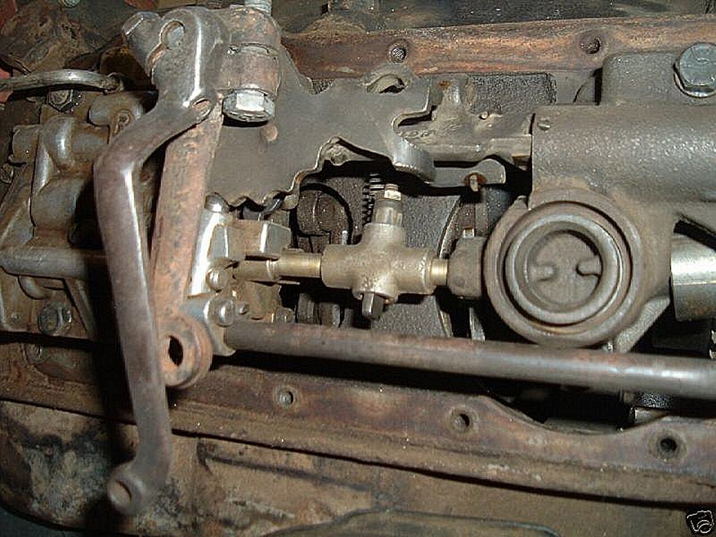

    this is the B&M valve that is insertred in the outer governor tube. It us actuated by the iron flapper arm above it. Other ****** companies did the same mod but couldn't use this patented valve. They did some mods to the valve body, drilled holes and a jumper tube. As mentioned above, it isn't really necessary even for a race unit.

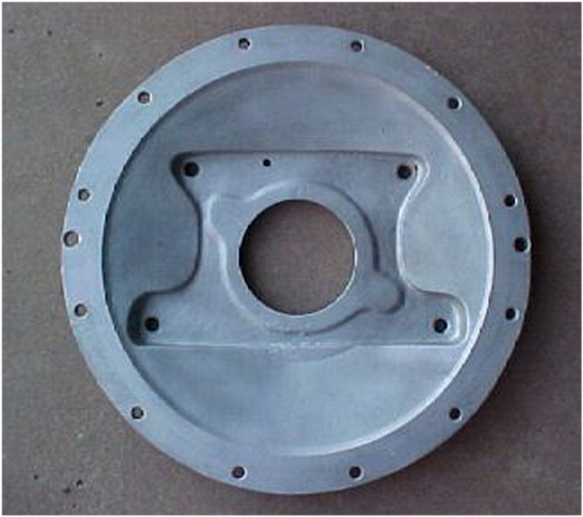

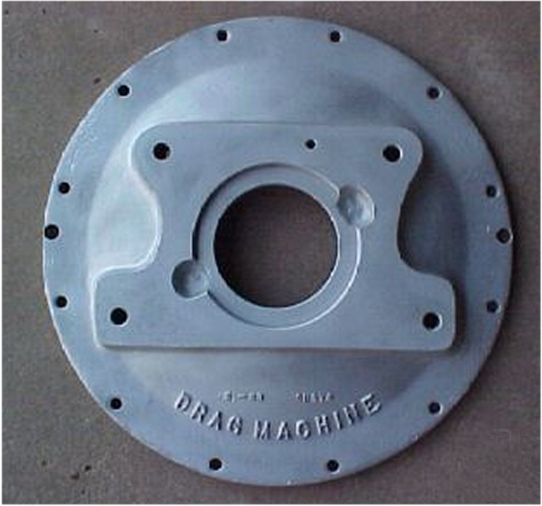

    This is the adaptor my folks bought me from B&M in '67 as a high school graduation present!
  19. bchctybob
    Joined: Sep 18, 2011
    Posts: 6,282
    bchctybob
    More great info from one who is actually running one.
    I believe the bolt pattern on the front of the main case is the same for the slant pan and the straight pan just rotated for a smaller hump in the floor. I would verify and post measurements but my Hydros are packed away and difficult to get at.
    The torus wheels shown in your pictures appear to be modified for a very high stall speed. The fins are usually flat across the face and undercut like yours to varying degrees to increase the stall RPM. Here's pictures of stock Olds torus wheels. Also note that the fins are just mechanically fastened by bending over two tangs. If you look closely at the ones you posted I'll bet you will see that they have a gold solder-like material flowed around the tangs - they were usually furnace brazed for high performance applications.
    The bellhousing/adapter shown looks like an adapter for a Ford FE or Y-block (note the 3 5/16" bolts for the bolt starter) and the torus cover looks like a 30 bolt Olds/Cad/Pontiac. If he has the flywheel you have a complete Ford/Hydro adapter that you could sell to help offset costs. It's got to be very rare these days.

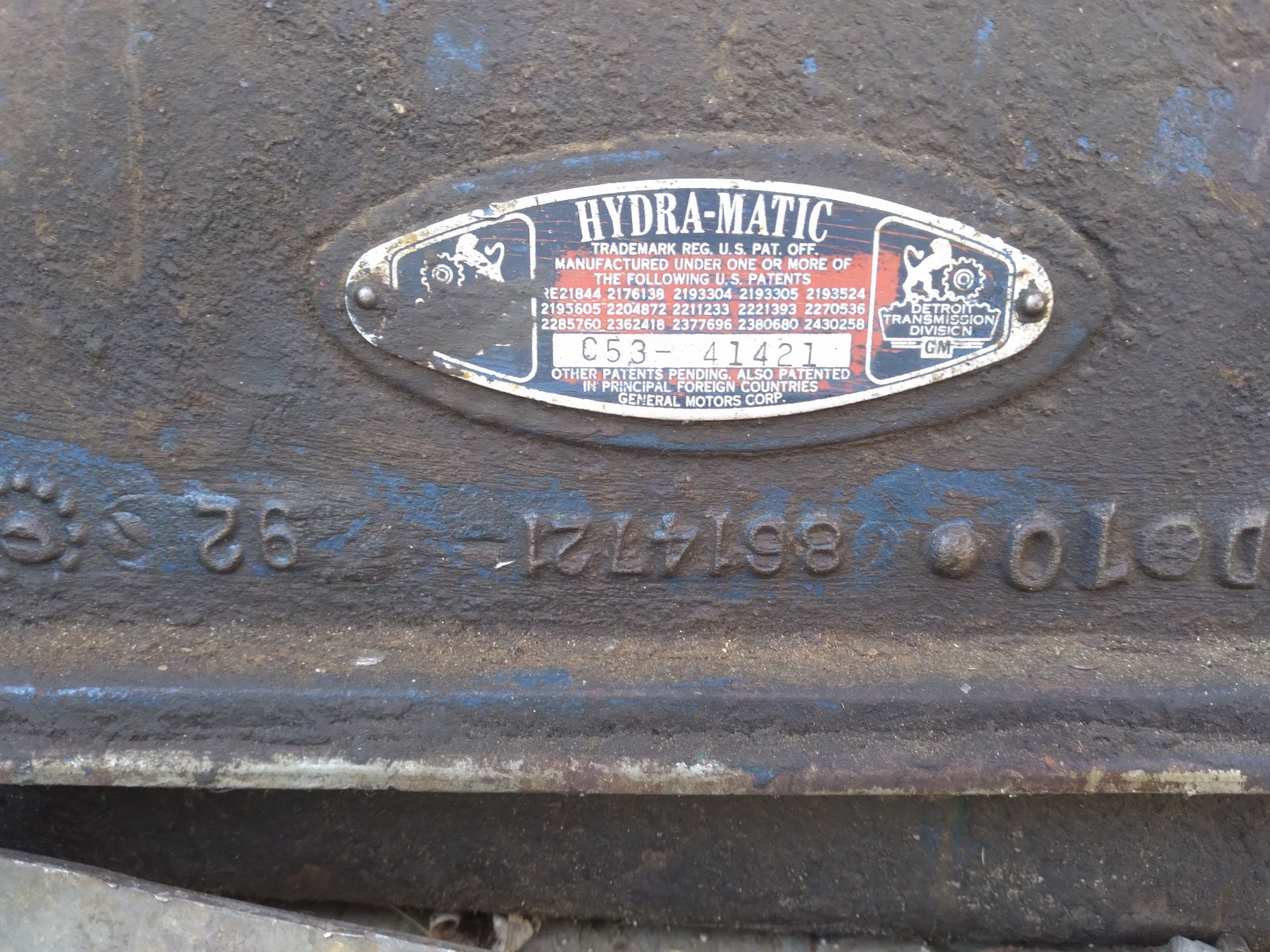

    If it is a B&M it might have a slide valve and that is a sure indicator of a beefed unit. Probably not a B&M since they replaced the factory ID tag with theirvown thin aluminum ID tag. If another ****** shop, that won't help 'cause they did reverse hold with valve mods. Look for an extra notch ground in the shift lever. That is for first lock.
    B&M indicators
    If it has a notch cut on the long ramp shown by the arrow, someone has modified it to hold first gear and it probably a beefed up unit. Doesn't really matter, these things were first designed for military tanks so are pretty much bullet proof from the factory.
