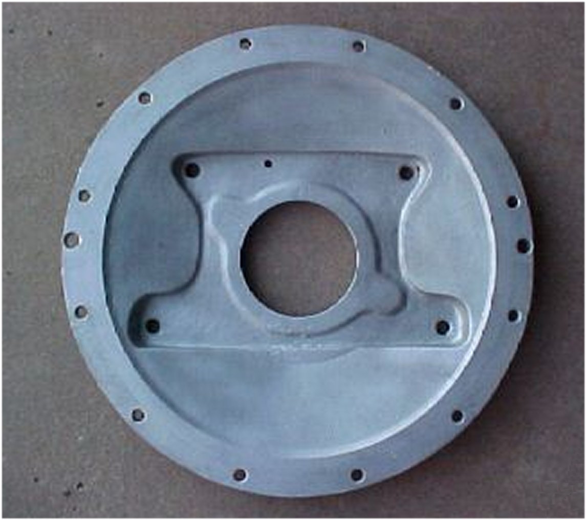

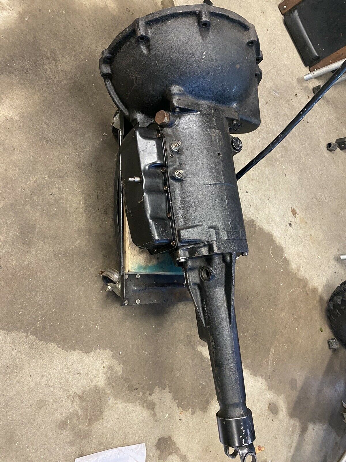

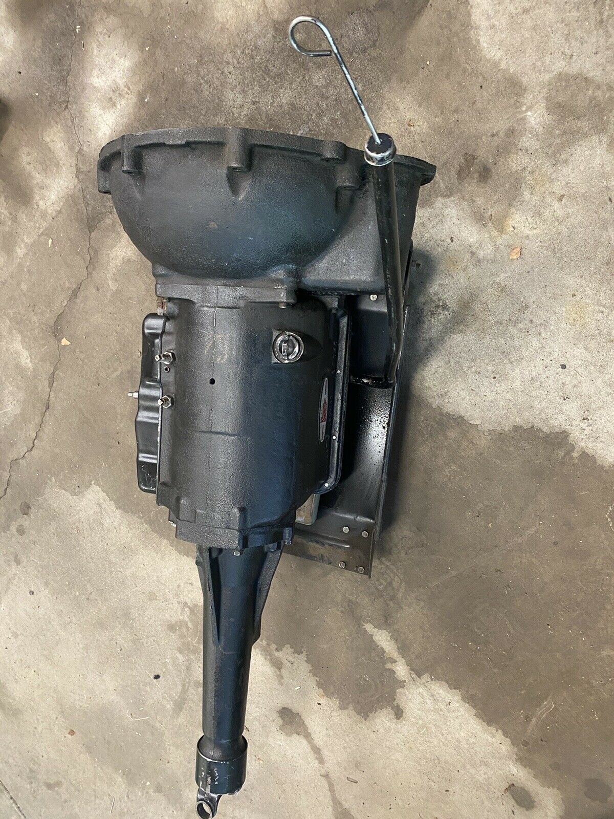

    So here she is! Yup its the one that's has been on EBay for over a year now. L53 Flat pan for a 1952 1953 1954 Lincoln Y Block. I contacted the seller and asked if he'd sell it without the bell housing. he replied yes and I made him a offer of 600.00 for it minus the bell housing and now its mine. It also has both a brazed driven and drive torus which have been modified for a high stall.

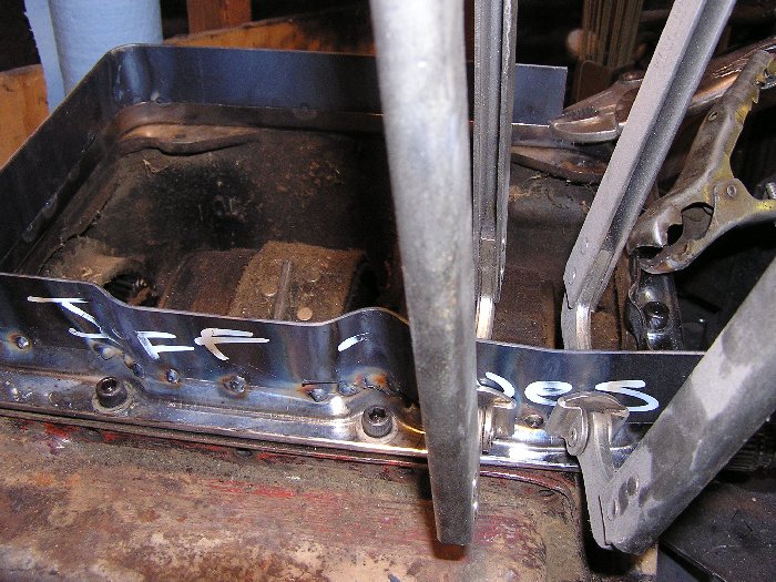

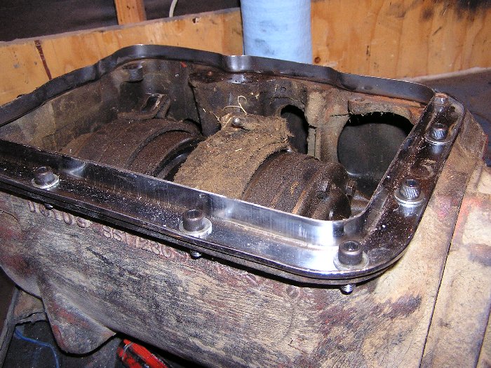

    One thing I did for my Hydro is deepen the pan. I did it for a couple reasons. First Hydros have a habit of draining the fluid coupling can of fluid into the ****** when not running. There is a check valve that is supposed to prevent this but they aren't very effective. That high fluid level reaches the output yoke in the tail shaft which has a pinhole to allow sliding back and forth on the splined shaft. This results in a chronic drip on the garage floor. A deeper pan holds all the fluid below that leak point. The second reason is strictly vanity; a deep pan looks boss!
    The finished pan. I had it silver color powder coated inside and out. Looks great and seals any pinholes in my welds.
    I slit the pan in half and added a 1 1/2" strip of sheet metal. I gas welded the seams.
    I did all the welding with the pan bolted to a junk ****** to prevent heat distortion. Bot flange down.jpg Final cut.jpg Fancy.jpg start welding.jpg Tack top.jpg finished welds.jpg
    Obviously the pickup tubes are now out of the fluid. To remedy that I brazed in lengths of steel tubing from a junk ****** putting the filter screen back on the pan floor. Also added a chunk of rod to lengthen the dip stick. Fill level is still the same specification as a stock ******.
    I ran water tests looking for leaks in my welds until it was sealed. Powder coating was the final seal.

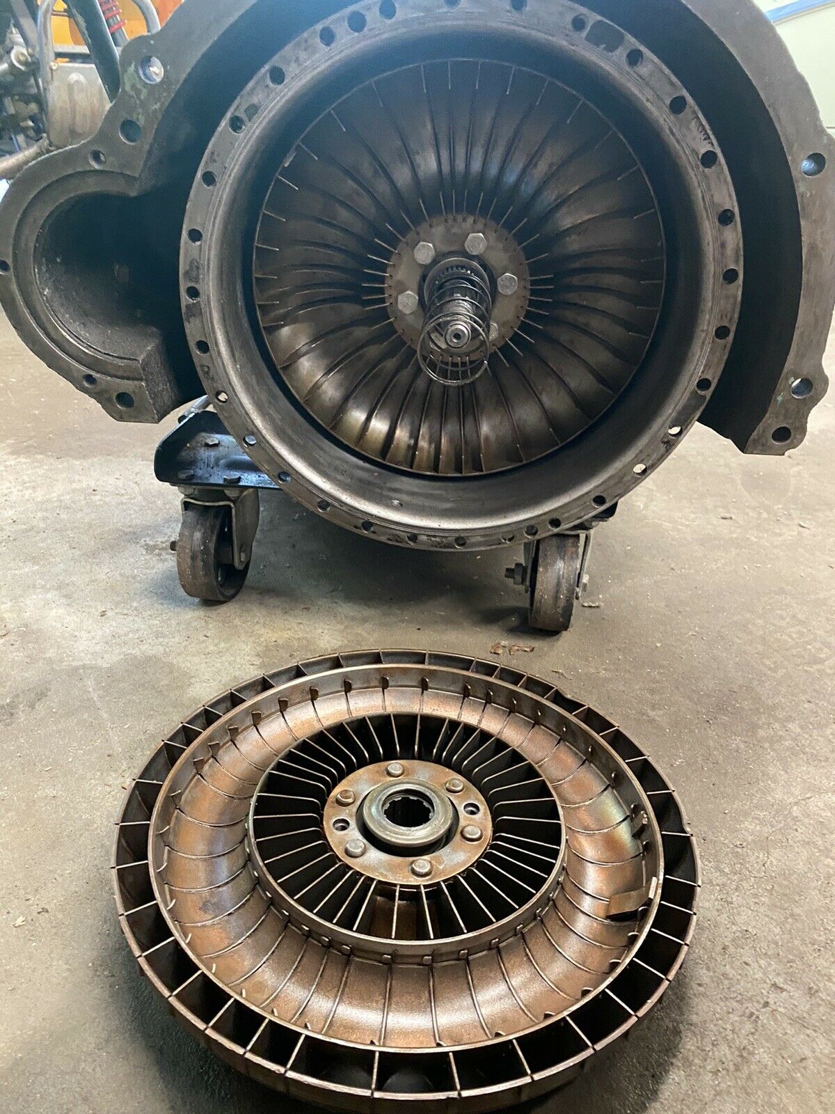

    Seeing as how the Hydramatics used a fluid coupling as opposed to a true torque converter, I'm kind of surprised to see the mention here of making modification to increase stall speed on the Hydramatics. Did this provide anywhere near the improvement that increasing the stall speed of a torque converter does? :confused:

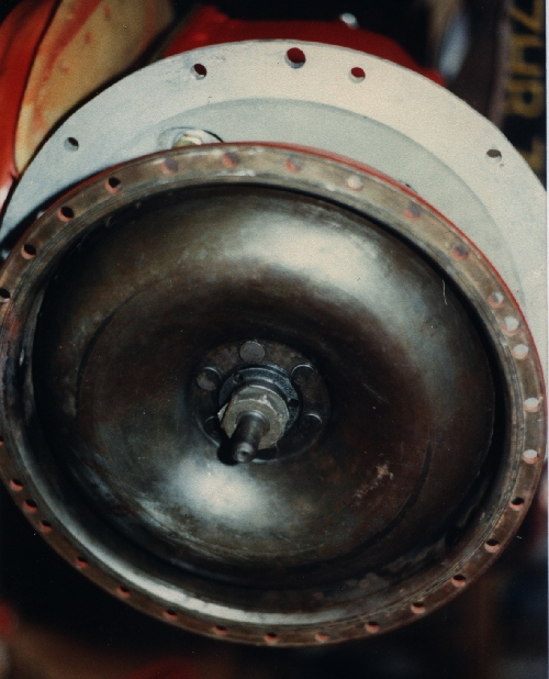

    All I know is that the trimmed torus wheels that C&O provided with the Hydro I had in my ‘47 Ford when I was young allowed my big Olds with a big Engle cam to idle in gear at stop lights instead of having to put it in neutral. If memory serves me, mine had a radius cut about 3/8” deep at the deepest part. I don’t remember if both wheels were cut, but I think so. Compe***ion versions had like half of the stock depth cut out. The cars using them seemed to leave the line pretty hard and were fast. I don’t know what driving technique was used, maybe someone here knows. I never took my ‘47 to the track.
    I’d like to know more about reshaping the vanes vs cutting them. Anyone have pictures of modified torus wheels?

    All stall speed is nothing more than slippage in a fluid coupling. A torque converter is a torque converter only in the very first part of acceleration. Once the car is up to speed, a torque converter is just a fluid coupling. Cutting the vanes down in either results in inefficiency caused by slipping resulting in more stall speed. Incidentally the power flow thru the Hydramatic ****** is unique with torque in 4th gear being shared thru 2 paths. This results in pretty close to lock up in 4th gear. Ever notice they don't require a fluid cooling system like the modern 'more efficient' ******s do?

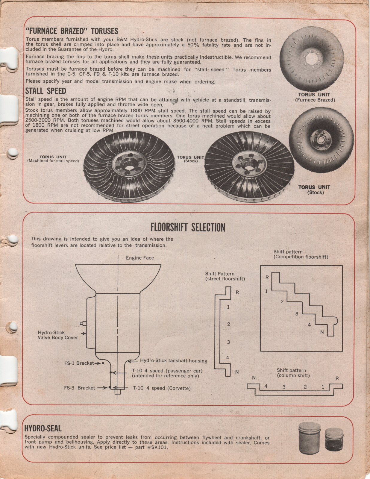

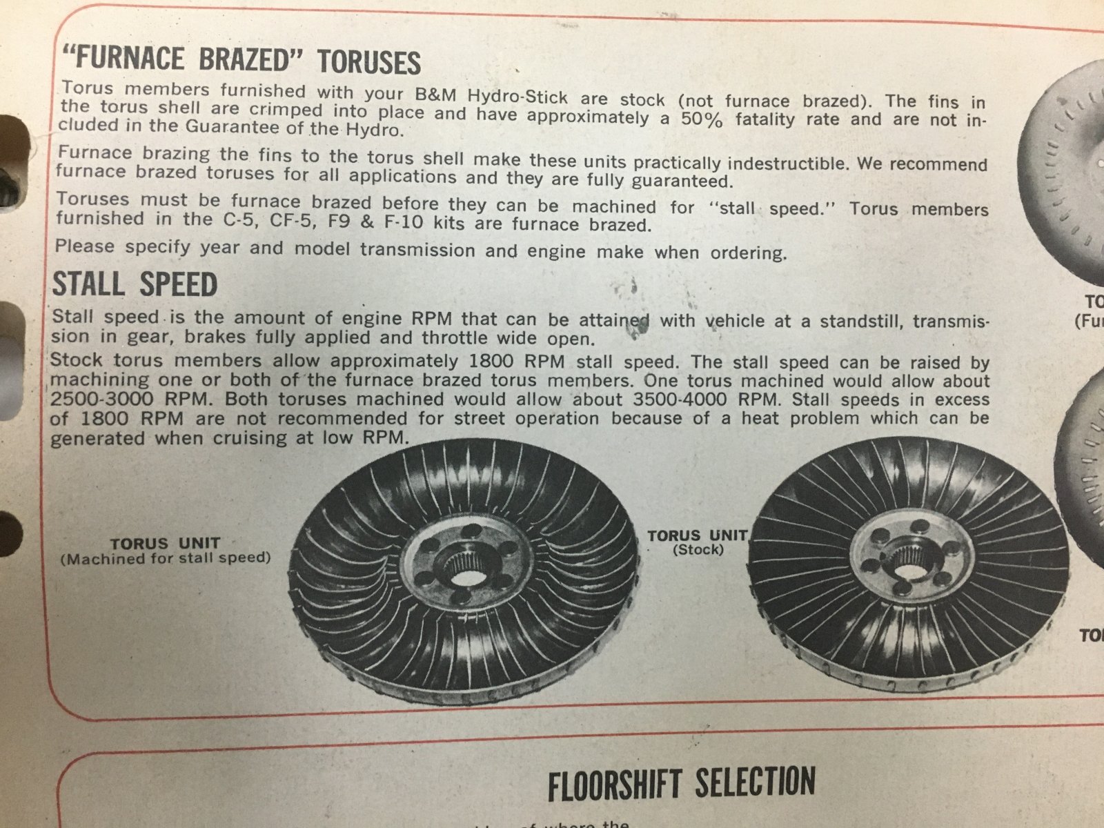

    That's where the machined torus comes in. The high powered racers machined out what looks like all but about 1/2" of the vanes! This allowed revving the engine with the brakes on due to the high slippage, high stall speed. No way would you want to cruise to Sonic in a car with a set of tori like that!!
    Below is a photo of a page from B&M's catalog circa '66. Shown are a furnace brazed, machined torus on the left and a stock Chevy torus on the right. The left one is for HIGH stall in a blower hemi Willys g***er. You can see the slip was m***ive.
    PS: As the B&M catalog says, be forewarned, running a trimmed torus on the street risks overheating problems. It is not recommended.

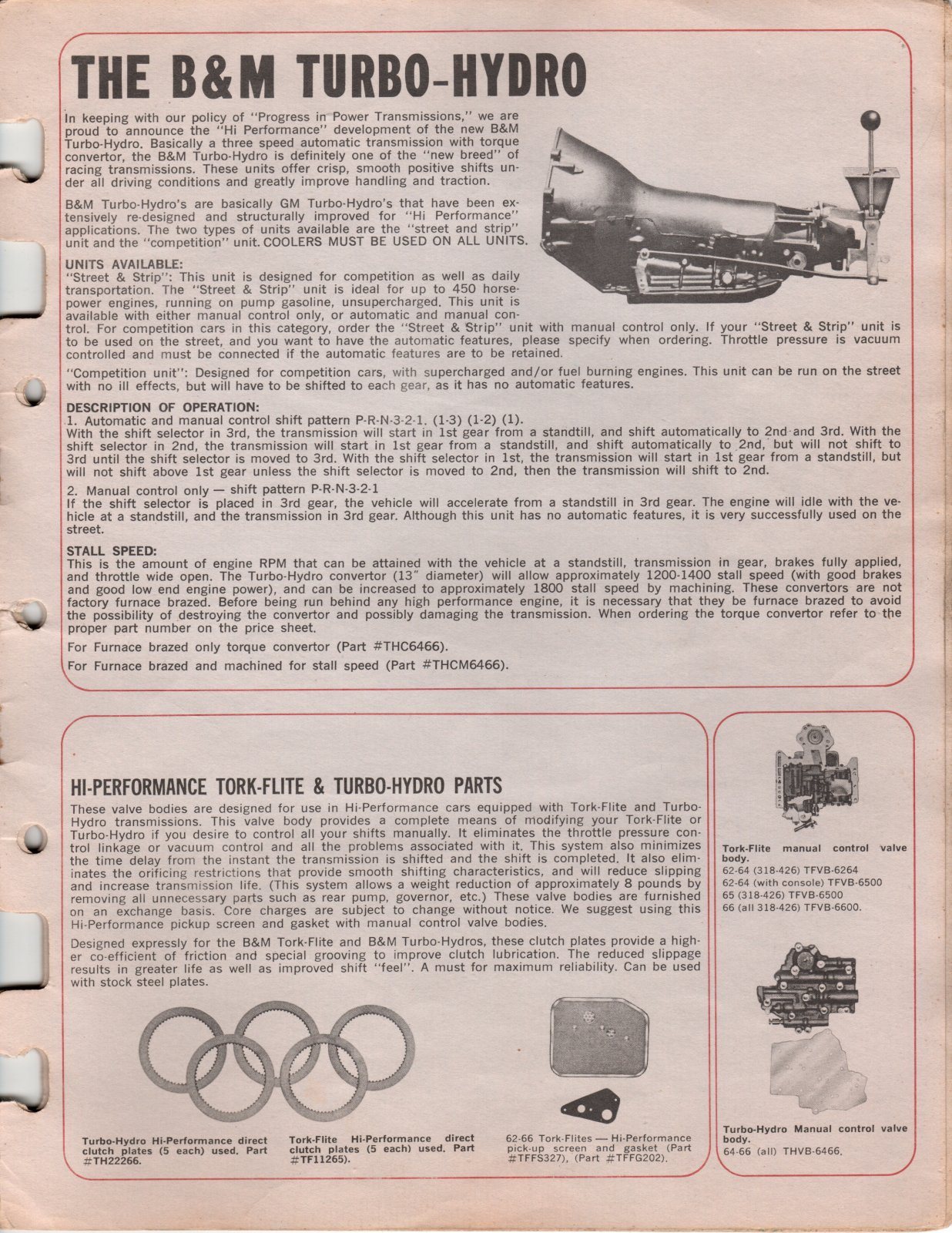

    Here is the complete mid-60s B&M catalog.
    B&M catalog 1.jpg B&M catalog 2.jpg B&M catalog 3.jpg B&M catalog 4.jpg B&M catalog 5.jpg B&M catalog 6.jpg B&M catalog 7.jpg B&M catalog 8.jpg B&M catalog 9.jpg B&M catalog 10.jpg B&M catalog 11.jpg B&M catalog 12.jpg

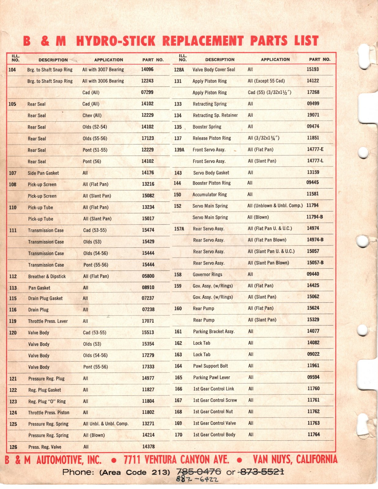

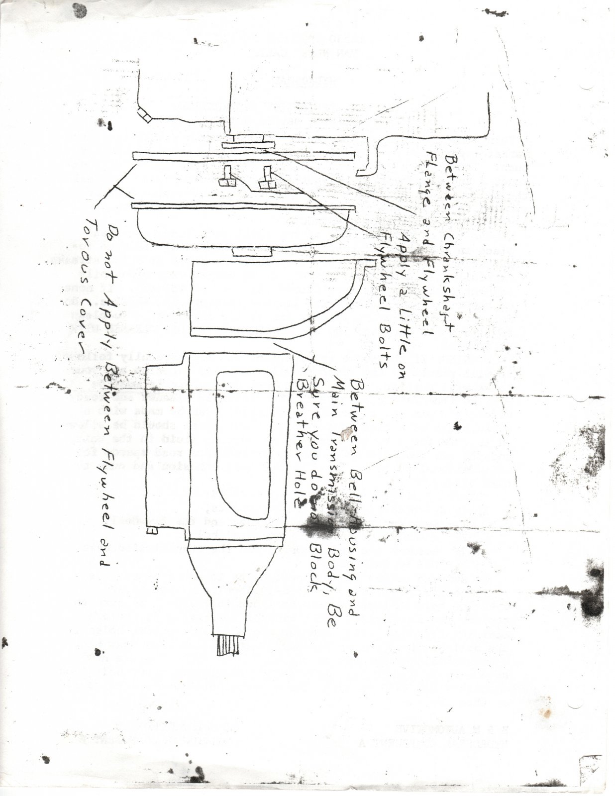

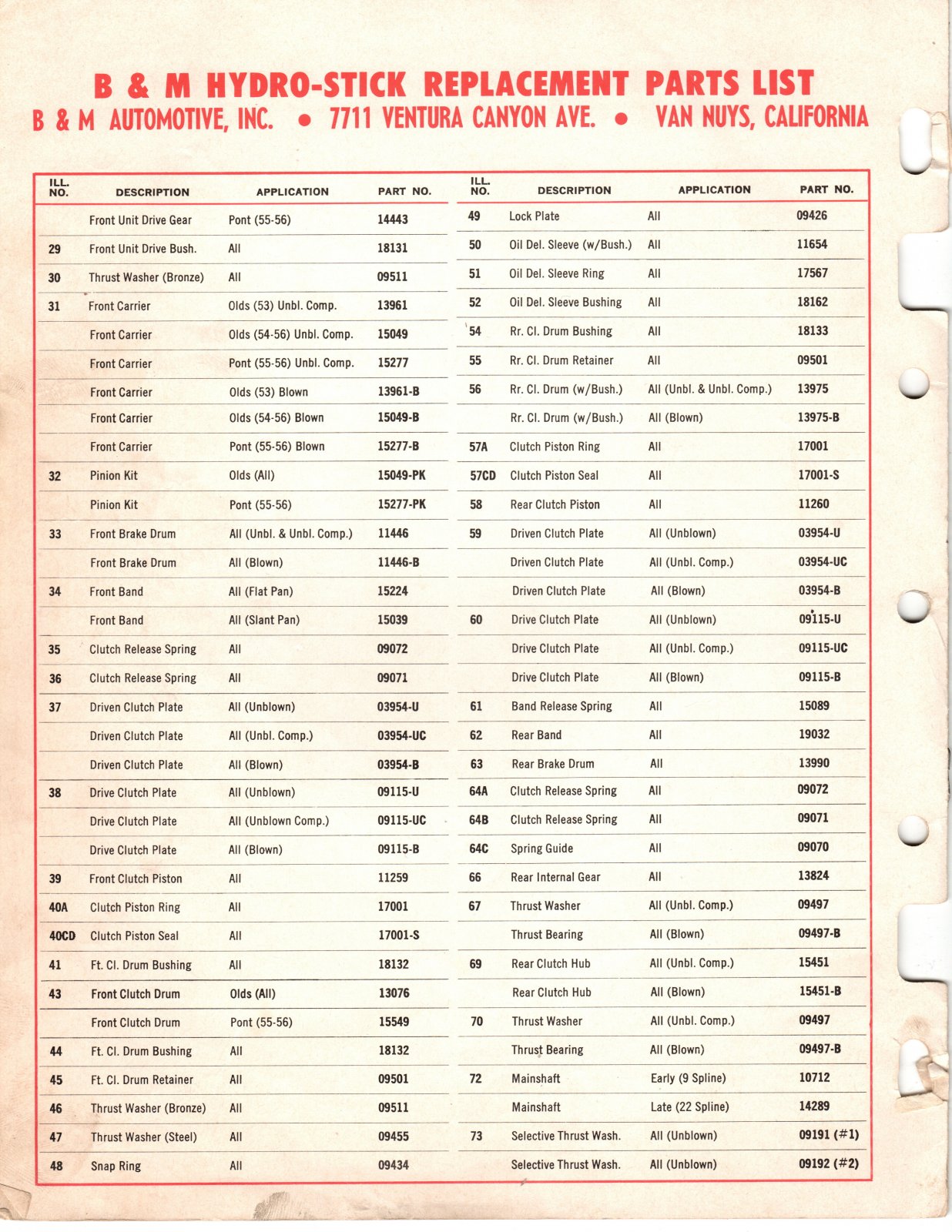

    And here is the Hydro parts catalog. Items 66 thru 70 are the B&M 1st gear lock valve.
    The last two pages are instructions for gluing the ******. flywheel, and bell housing together to hopefully reduce leakage. They recommended gluing the ****** to the bellhousing since the front pump is held in the case with the edges of two capture screws with an O-ring seal and the torque of big blowe motors tweaked the joint and caused leaks.
    Hydro parts 1.jpg Hydro parts 2.jpg Hydro parts 3.jpg Hydro parts 4.jpg Hydro parts 5.jpg Hydro parts 6.jpg Hydro parts 7.jpg Hydro parts 8.jpg Hydroseal 1.jpg Hydroseal 2.jpg
