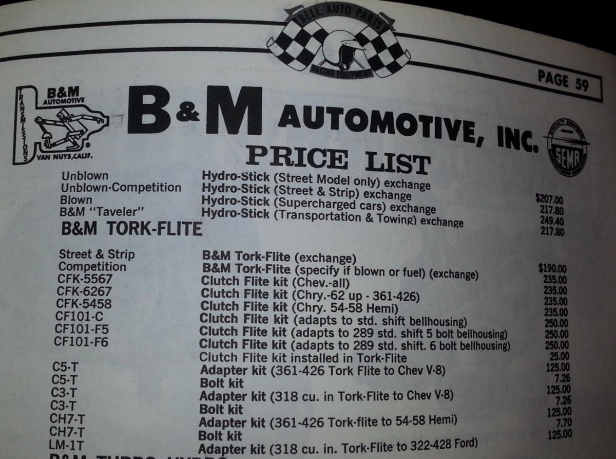

    Gojo...never heard of an unlimited compe***ion hydro, just unblown compe***ion. Im sure B&M made a hydro adapter for hemi...probably ebay might be your best bet. Here is a page from my 1968 Bell Auto Parts catalog showing what was available that year.

    Look at the prices in that old Bell Auto Parts listing!!! I'll take a dozen of everything. I am Butch/56sedandelivery.
    Speedy Canuck, Todd553 and bchctybob like this.
  6. It looks good Butch, but you have to multiply those numbers by 10 to convert the price to the equivalent today.
