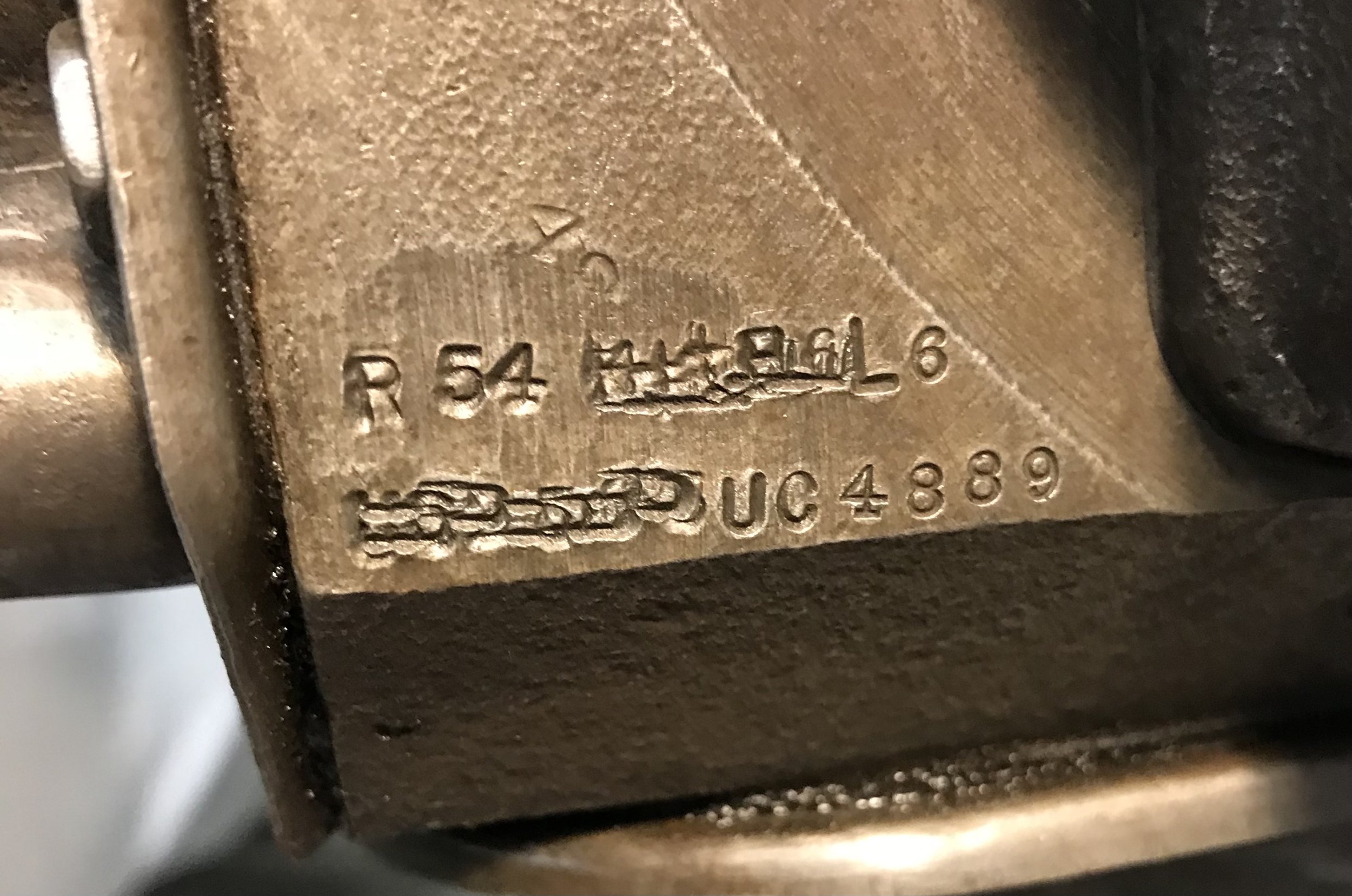

    B&M stamped the same info from the tag on the machined surface on the back of the main case, driver’s side next to the tailshaft housing. So if the tag is missing or damaged, you should still be able to identify the trans.

    the tag does rear HO after the P55, the BC or UC code would be where you see SS on the right side, which stands for Street/Strip version of the Hydro Stick trans from B&M.

    the B&M tag on this Hydro Stick made me do a double take, My 54 Olds Slant Pan Hydro Stick tag numbers are almost identical, my tag reads R54 E6, and on the right side it reads UC4363 or 4565, it has the Olds 88 shorter tail shaft and housing. PICT0030.JPG PICT0030.JPG PICT0031.JPG
