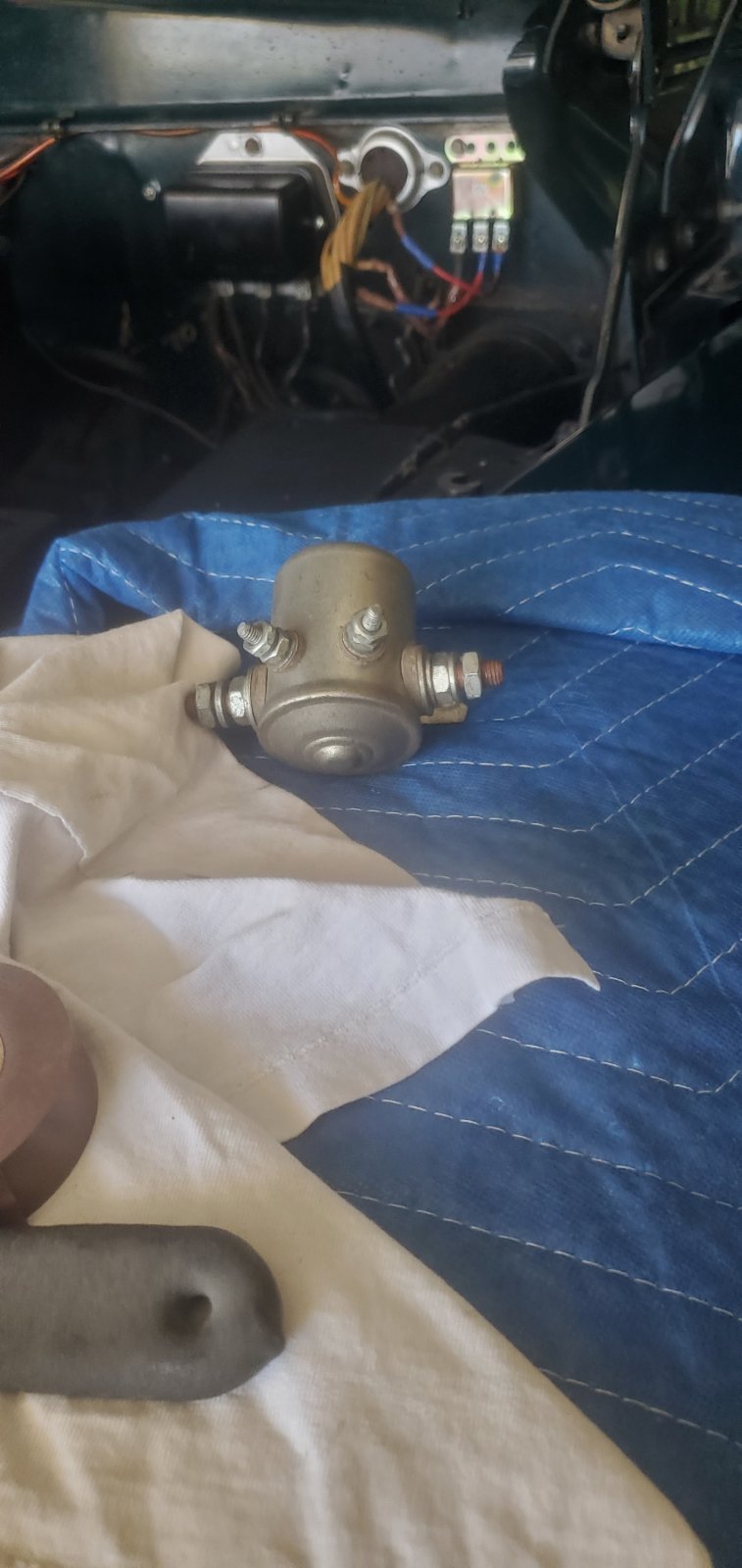

    Getting 51'Merc ready for the season here in Michigan. 255 Flathead with B.W. Overdrive 6v.
    At some point before the Relay had been replaced with a starter Relay/Solenoid.

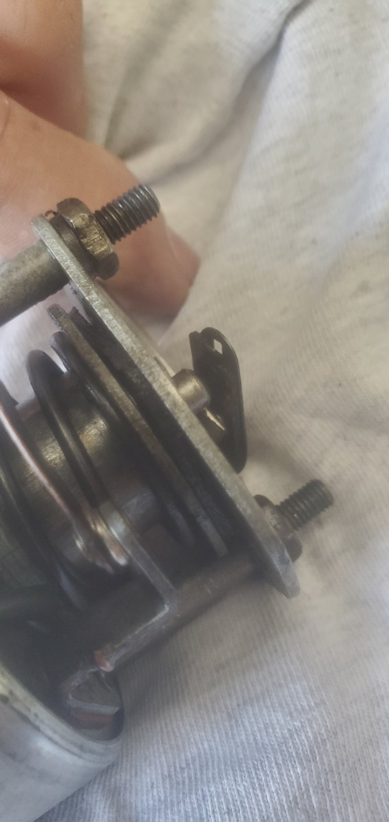

    Over the Winter I bought a Solenoid and Relay. After further inspection I noticed a rattle in the relay, and found the contact point floating inside the case.
    So I looked at the Solenoid, I noticed the contact point on the top(plunger) is missing.
    Question is, does anyone rebuild these or are the paperweights now?

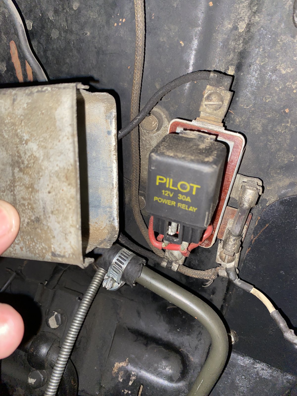

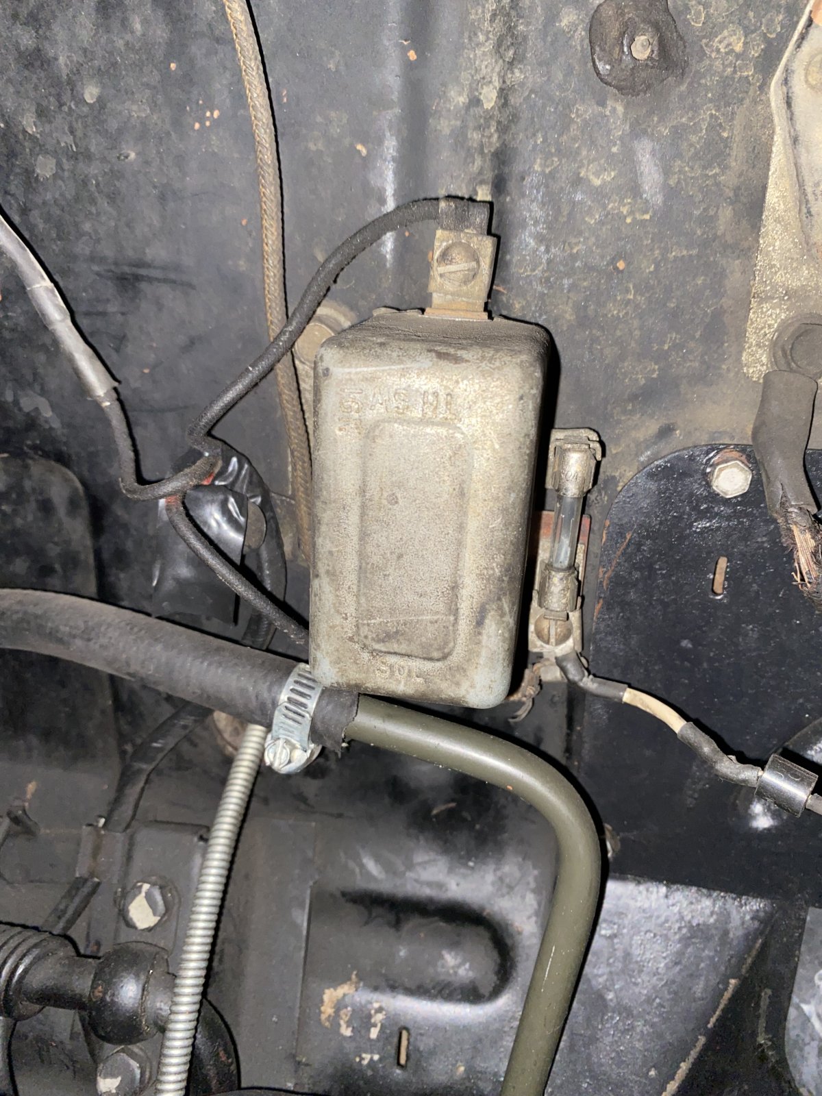

    I "rebuilt" the horn relay on my 57 by removing the guts and putting a mini relay inside. I connected the terminals to the original relay terminals. With the can on it looks very original.

    IS THERE ANYONE THAT KNOWS & REPAIRS OVERDRIVES? Here's the wiring diagram to use a bosch relay in place of the stock Ford/Mercury relay. If you want you can remove the "innards" of the original relay and put the bosch relay inside the housing.
    Skylaker likes this.

    I used a 30amp relay for off-road lights and hid it under the original cover.
