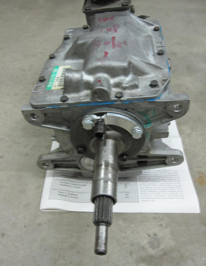

    how much do i to cutoff the snout of t-5 ? 3/8'' ?
  2. That's about right

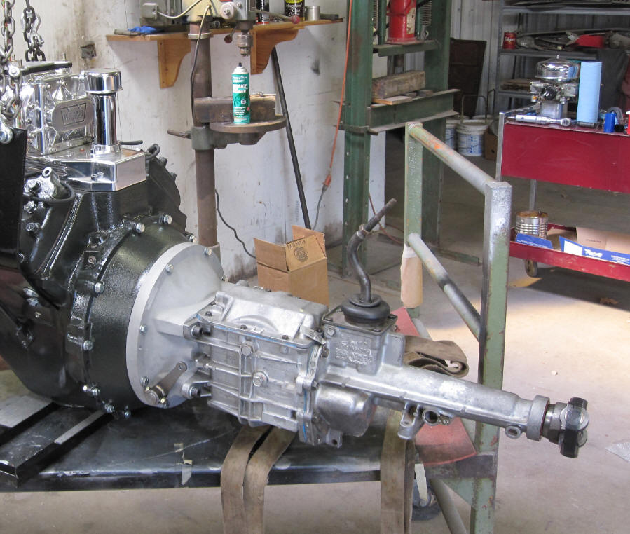

    If possible I'd do a trial fit first. Mine fit fine with the stock length shaft. Did fabricate a bracket to mount the TO bearing spring and mill off the unnecessary tabs on the case, however. T5Install-1.jpg T5Install-2.jpg
