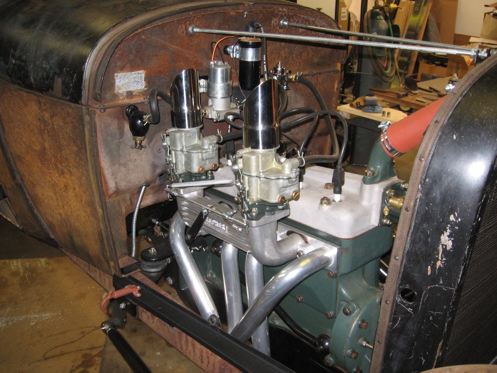

    Received my goodie box with PVs and other goodies. Couldn't resist mocking them up...
    Still have to imagineer everything from my foot to the linkage ball, but I'll get there!

    Not sure why the picts posted twice, but I used the Stromberg brand linkage off of extended shafts. I like the Stromberg linkage for they have a springs at each arm that is somewhat hidden.
    For the throttle, I just connected to the rear most carb. Works perfectly.

    @banjorear Nice work! Linking the carbs together on the driver's side and then actuating on the p***enger side makes for a clean install.
    Unfortunately, I didn't use extended throttle shafts, so I must do everything on the p***enger side!
