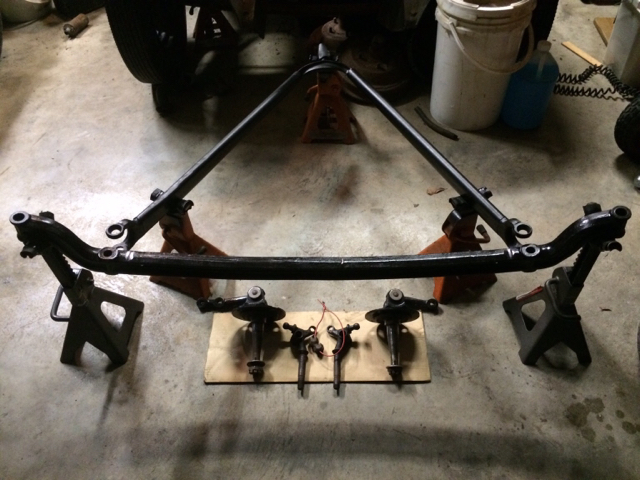

    I've been piecing my front suspension together. First item was to get an axle dropped (thanks to Jack Fuller at Fuller Axle)
    Picked up some nice round back spindles, repainted perch bolts, and reworked a good wishbone.

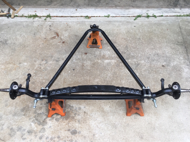

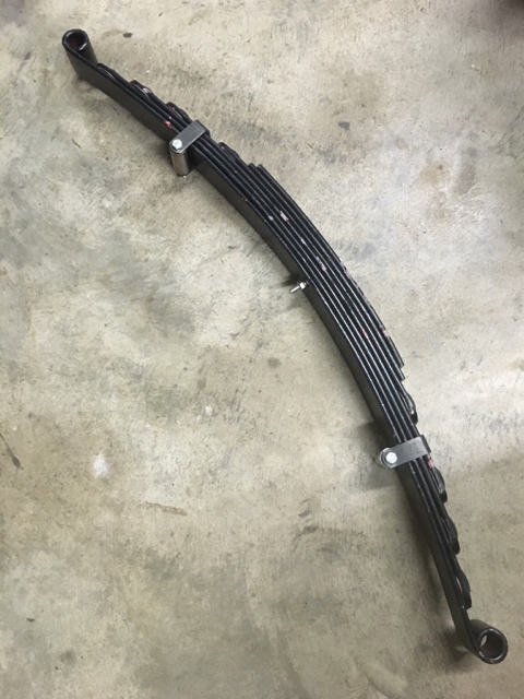

    I had also scored a front spring that turned out to be a Posies SuperSlide! I radiused the leaf ends, repainted each leaf then re***emble.

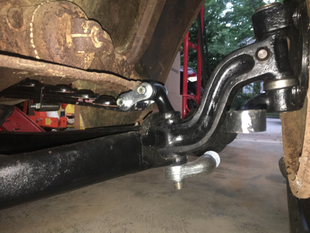

    I decided to purchase new perch bolts with better eye ends and new spring shackles. Now that the components were collected, I got them all into one ***embly...
    Now I see why all the steering arms are always heated and bent!! Major interference with the dropped axle!!
    These will be m***aged to provide proper operation once the ***embly is under the car.

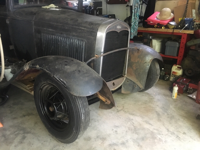

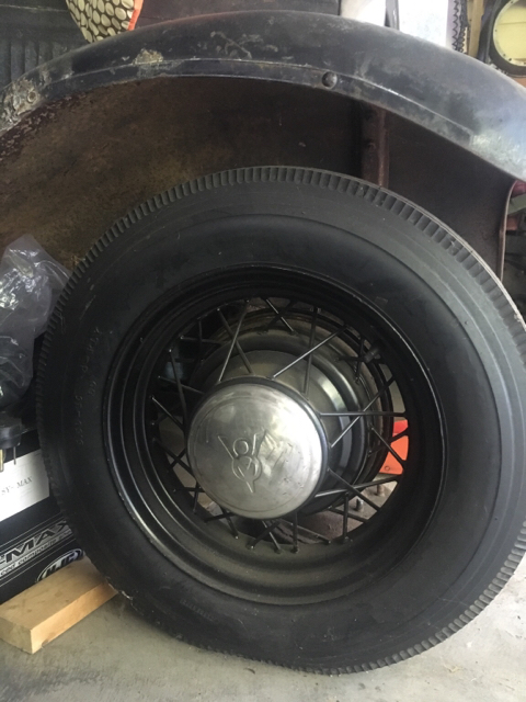

    Had a little time yesterday afternoon to clean out the garage and the Tudor was whispering my name, so...
    Before...
    ...after!
    Looking MUCH better...
    @stealthcruiser pointed out that I had not replaced the cap...better now!!
    Now I'm thinking that I might be able to mount the tie rod between the frame and wishbone. Looks like adequate room!
    Any thoughts?!?!

    Brett: There have been a few tutorials on HAMB how to do this spindle arm op. It is done OFF the car, in a vise.
    The axle should be 'handy' for final fitting, and once they and twisted and dropped, don't neglect to bend up the tie rod eyes so they are level with the wishbone.
    This ensures 'level' geometry from left to right; Just 'record' the symmetry of the eyes before twisting and dropping.
    Also: To ensure proper Ackermann, lay a straight edge down the face of the spindle, measuring the distance of the end of the arm to the plane of the spindle face. This value should be written down, and final check 1/16" LESS, or 'closer to the spindle face'. Ackermann setting is a straight line from king pin center to center of rear axle, with tie rod connection intersecting. Do a search for the shaping of the arms.
    "Good Hunting."
    EDIT: The attempt to take the tie rod over the wishbone will limit the turning radius, really best to bend the arms down...
    brett4christ and Dannerr like this.

    The reason the tie rod over the wishbone is a bad idea is because it will more than likely want to be in the same place as the oil pan, lower pulley, or the front crossmember. I'm running into this (pun intended) with my sedan. I want to get it an inch lower, so the spindle arms will have to be bent so the tie rod fits under the wishbone.
    And, as Mike said, don't bend the arms with everything all ***embled. You will cook the grease and make it a varnishy gooey mess, preventing good greasy grease from properly lubing the bushings and axle bearing.
    Atwater Mike and brett4christ like this.

    Thanks Mike/Alchemy for the input! Advice heeded!! [emoji12]

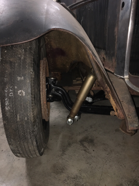

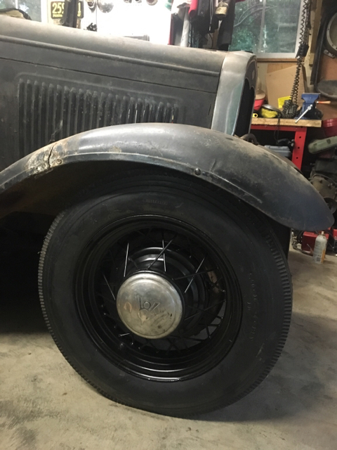

    Cleaned up around the Tudor tonight so we can get a better perspective...
    And an under-fender shot...
    The shock top is just resting on the inner fender. I have F100 Shock mounts to modify!

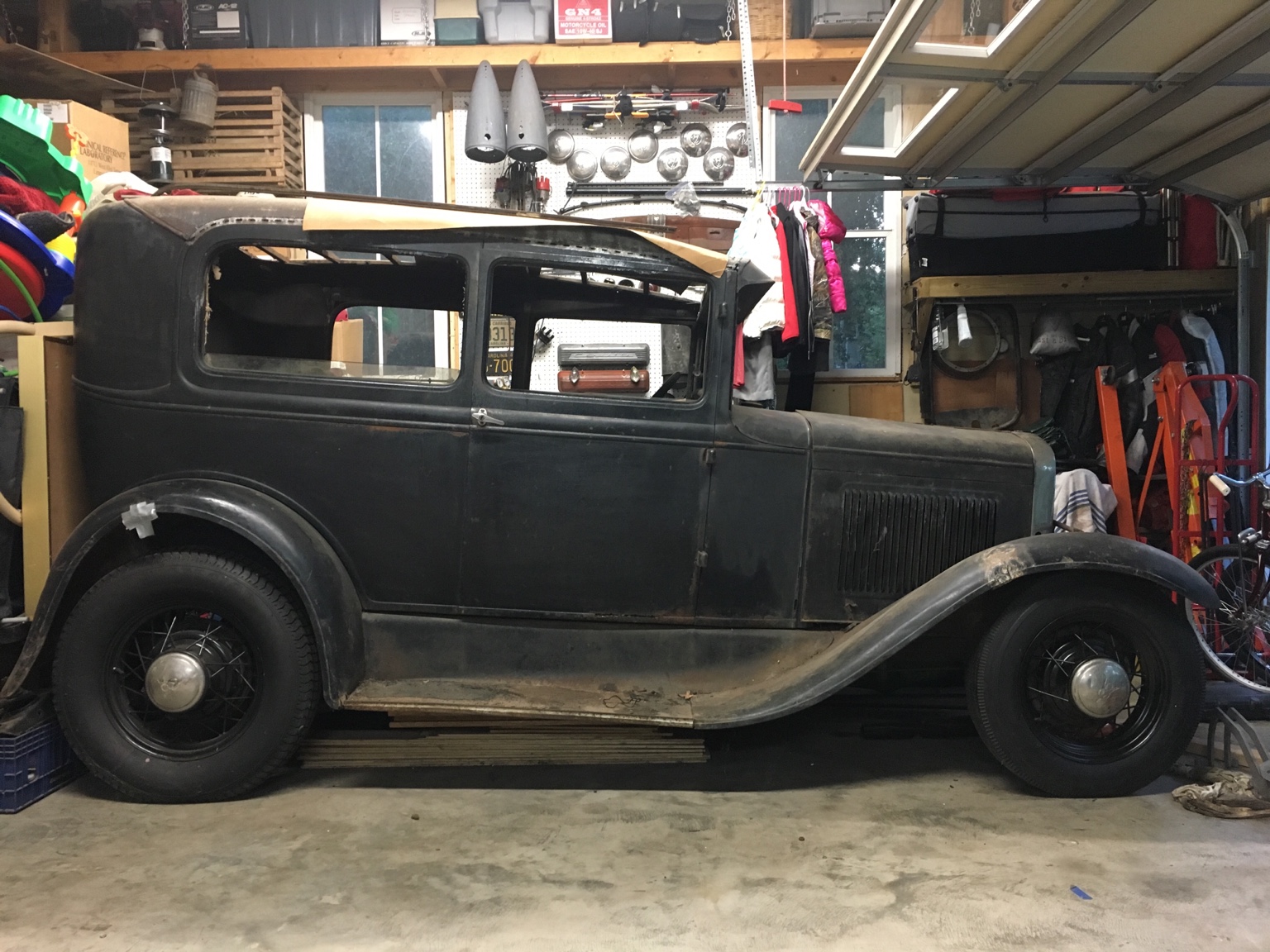

    I had the '46 rolled out of the garage last night, so I took the opportunity to snap a photo of the profile after the dropped axle install.
    Now, back to our regularly scheduled build....
