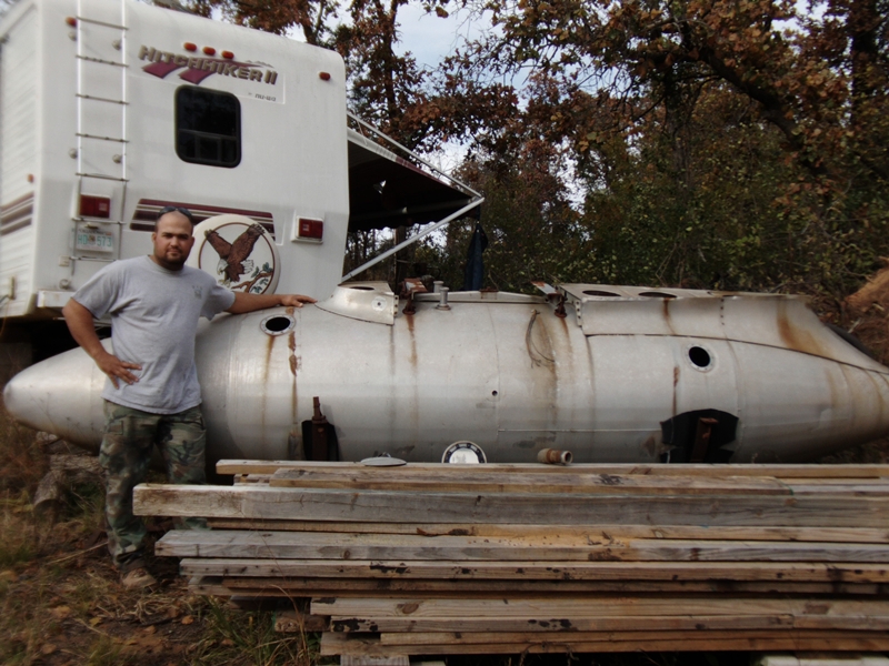

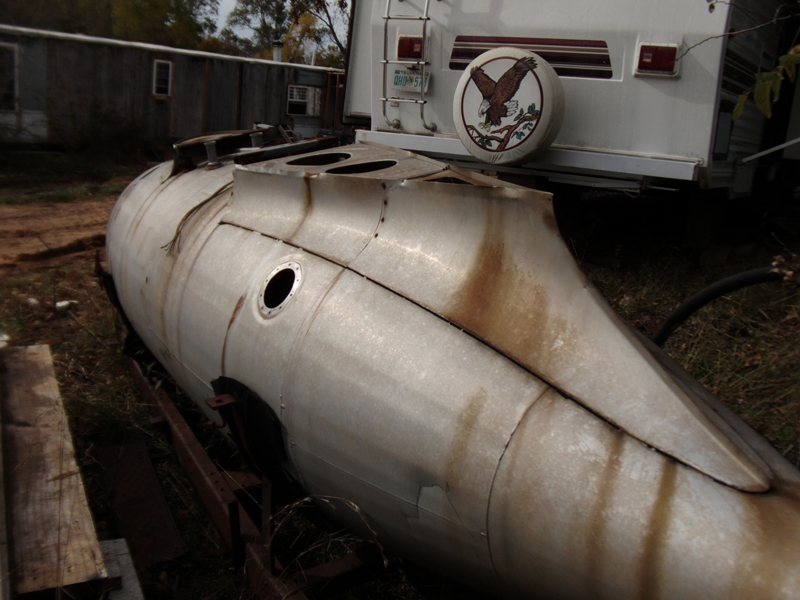

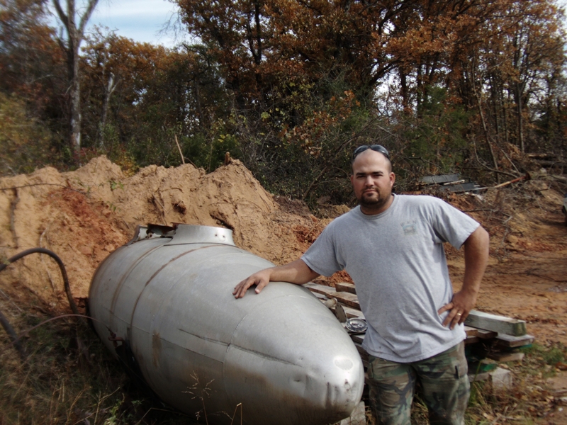

    ok guys i just got the pics so here they are. i dont know if they are too big but ill resize them if i have to.

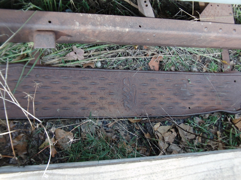

    you can see the size of the tank in these photos. when i bought it someone had used an old ford frame to mount it as an old fuel tank probably on a farm or something. anyone have any idea how old the frame is or if it might be worth cleaning up? i took some photos of the floor board so that might help. if i need to take any others let me know

    Looks like a regular tank only preggers ..... You're ready for some fun!
